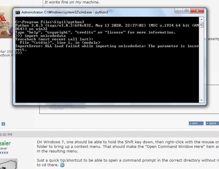

Yowza.
On second thought... even if 'cd' couldn't be found, you'd never get a graphical error if you were entering it in a command prompt/window. Perhaps you typed it in a search box?

On Windows 7, one should be able to hold the Shift key down, then right-click with the mouse on a folder to bring up a context menu. That should make the "Open Command Window Here" item available in the resulting menu.
Just a quick tip/shortcut to be able to open a command prompt in the correct directory without needing to cd there.
Ok, now your tip opened what I believe should have. The screenshot is the result of inputting things as Doitsu directed.

That's better. Thanks! Still not sure what the problem might be, but it's a base starting point anyway.

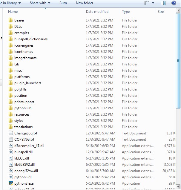

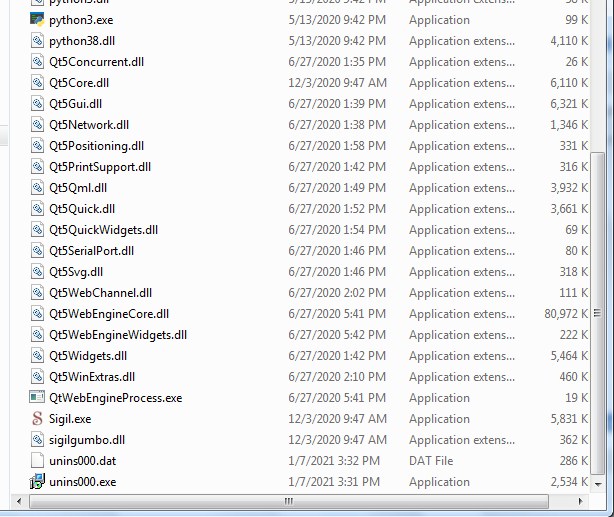

Can you possibly post a screenshot of the contents of the "C:\Program Files\Sigil" folder?
Sure! Anything you ask for, if I understand what you want, I'm more than happy to provide. I'm very appreciative of all the time that has been spent trying to figure this out.
Two screenshots attached.

Sorry if this is a stupid question, could this be a 64 bit vs 32 bit mismatch issue with python?

Your screenshot shows that your original error message was in fact correct. For some strange reason the DLL that is needed for the python3.8 unicodedata module can not be found.
One thing you could try is to download and install Python 3.8.3 from www.python.org and install it and then open a command prompt to fire up that just added version of Python 3.8.3 (not the one in the Sigil folder) and try the:
import unicodedata
test again and see if you get the same error message.
Doesn't seem to be. Sigil looks to be the 64-bit version (based on where it was installed by default) and the bundled python looks to be 64-bit as well
On a working Windows build where would the unicodedata.so or unicodedata.dll be found?
It should be in the Sigil/DLLs directory. It's definitely in the 1.4.3 installer and it functions as it should on my Win7 test machines.
@BookWalker : in the DLLs folder (found in the Program FIles/Sigil folder you posted the screenshot of), can you verify that a file named unicodedata.pyd is, in fact, there?
