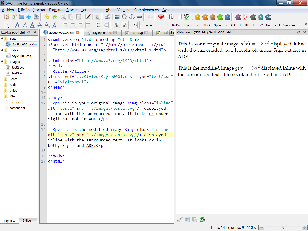

Well, after studying your .svg image, I can tell you the following:
1) Your .svg is an image made of "paths".
2) Your .svg is not a plain .svg, so it can produce issues with some ereaders.
3) Your .svg, even after converted as plain .svg, it has some instruccions not supported by ADE.
I attach an. epub with two .svg images: your original converted as plain .svg (test2.svg) and a new one made by me (test3.svg), also a plain one.
As you can see in the following screenshots, your image is not displayed under ADE but it looks ok under Sigil. So, that is a source of issues because if ADE has troubles to display your .svg, all ereaders based on RMSDK won't be able to show properly your formulas.
ID:	182028Click image for larger version
Since you have so many .svg images, to correct them in order that ADE can display them is not an alternative. So your best bet IMHO is to convert them (batch conversion) as .pgn using a conversor like Irfanwiew or ImageMagick.
Regards
Rubén
Attachment 182028Attachment 182029
Regards
Rubén
