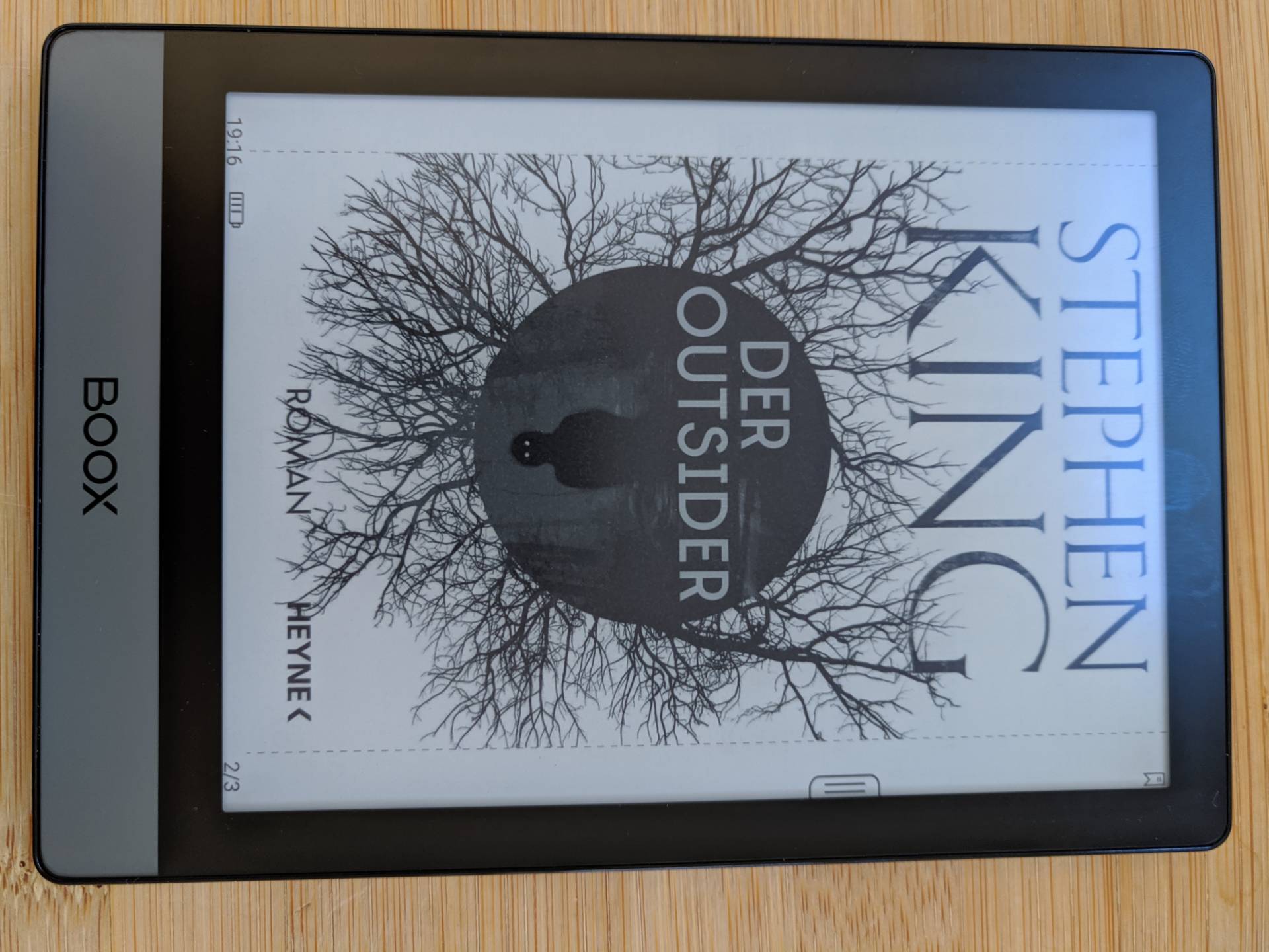

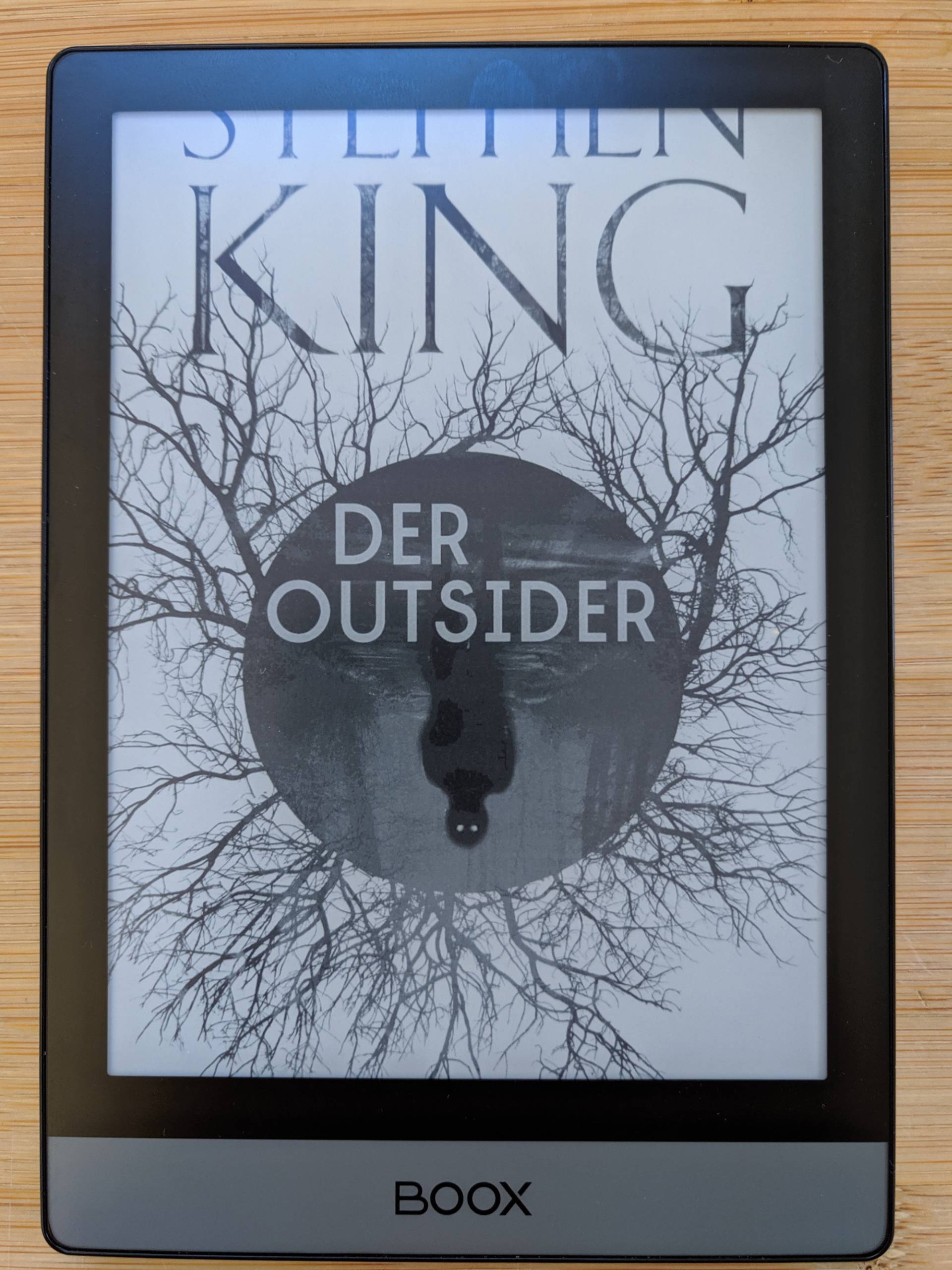

Exclamation
Ok it works!!11! WOOHOO.
(Don't you really want to add this as an option? Calibre Companion should be able to do that as well. And KOReader is very much better )
But I have to build "./kodev release --debug android". I don't have a Google account to sign by myself. The file is very big and loading is very slow.
I still have one problem, the image on the Poke 2 screensaver is scaled to screen size. If the width of the cover image is very small, it will be cut off at the top and bottom because it will be scaled until it is full screen.
Is there an option to adjust the background of the image to the screen ratio?
Winkelschraube is offline   Reply With Quote

Pictures of the scaling problem attached.
ID:	181702   Click image for larger version
No with these changes. I'm afraid you'll need to rescale the image before calling writePNG.
I don't want to scale, I want to change the background of the image to keep the aspect ratio of the screen.
I was thinking about an imagemagic script that runs in the background and checks every 30 minutes if the image has been rewritten. Because I have no idea about Lua. But of course it is better to do it in KOReader, I will try it in the next weeks.
Thanks a lot for your help so far. This is really great.
