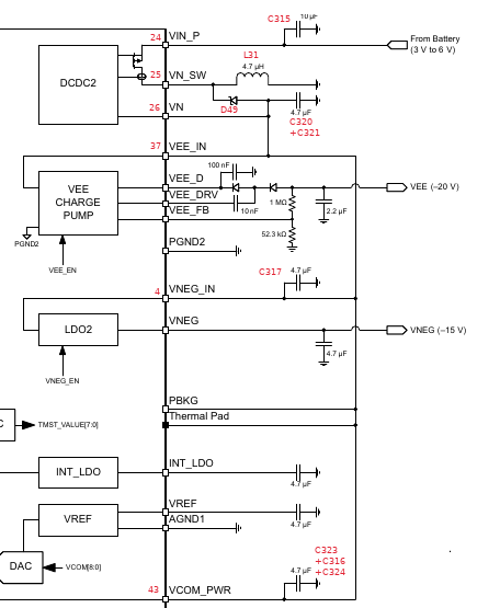

Arrow DCDC2
DCDC2 (part application circuit attached below) is checked first as it needs to be up and running before DCDC1 is powered up, so any faults here might be preventing DCDC1 from working.
Pins 24,25 and 26 are directly connected to the DCDC2 subsystem, in addition pins 4 and 16 are linked by an external rail and their attached support components need to be checked also. Pin numbers and component identifiers have been added in red.
Pin#    Pin name        Components
24       VIN_P         C315
25       VN_SW         D49, L31, C320 (+C321)
25       VN            output to pins 4 and 16
4        VNEG_IN       C317
16       VCOM_PWR     C323 (+C316 +C324)
Capacitors in brackets are additional to those on the circuit diagram and are extra capacitors in parallel to the one shown.

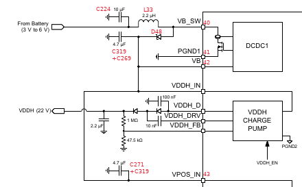

DCDC1
DCDC1 uses pins 40, 41 and 42 and also is connected to pin 43 exterrnally.
40     VB_SW        D48, L33, C224, C319 (+C269)
41     PGND1        to ground
42     VB           to pin 43
43     VPOS_IN      C271 (+C319)
