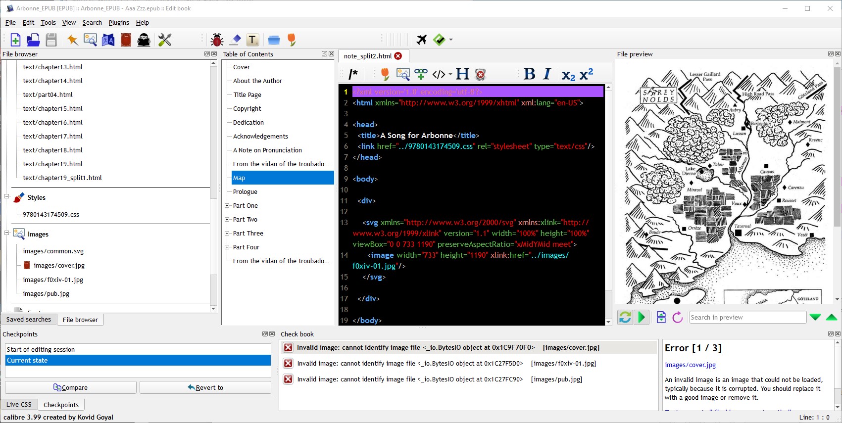

In the Editor when running CheckBook I'm now getting errors reported on all jpg images. I've tried with several random epubs with the same problem.
I should add that these epubs are 100% clean in calibre 3.47.1.

Karma: 29634066
@jackie_w Is this on windows?

Karma: 65709392
Did it for me too 3.99.1
Win 10 x64

Karma: 16800000
Win 10 x64
Yes. Windows 10 64bit using beta 3.99.1
This is also happening in Linux.

@jackie_w thanks will be fixed in the next beta

Karma: 29634066
bernie
Yeah same issue: https://github.com/kovidgoyal/calibr...b6fd7075b6495a
