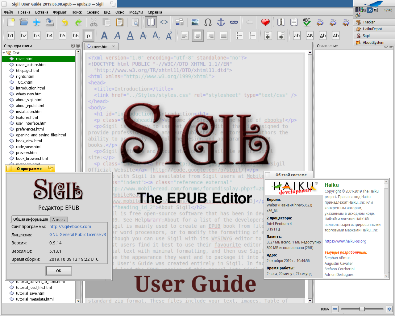

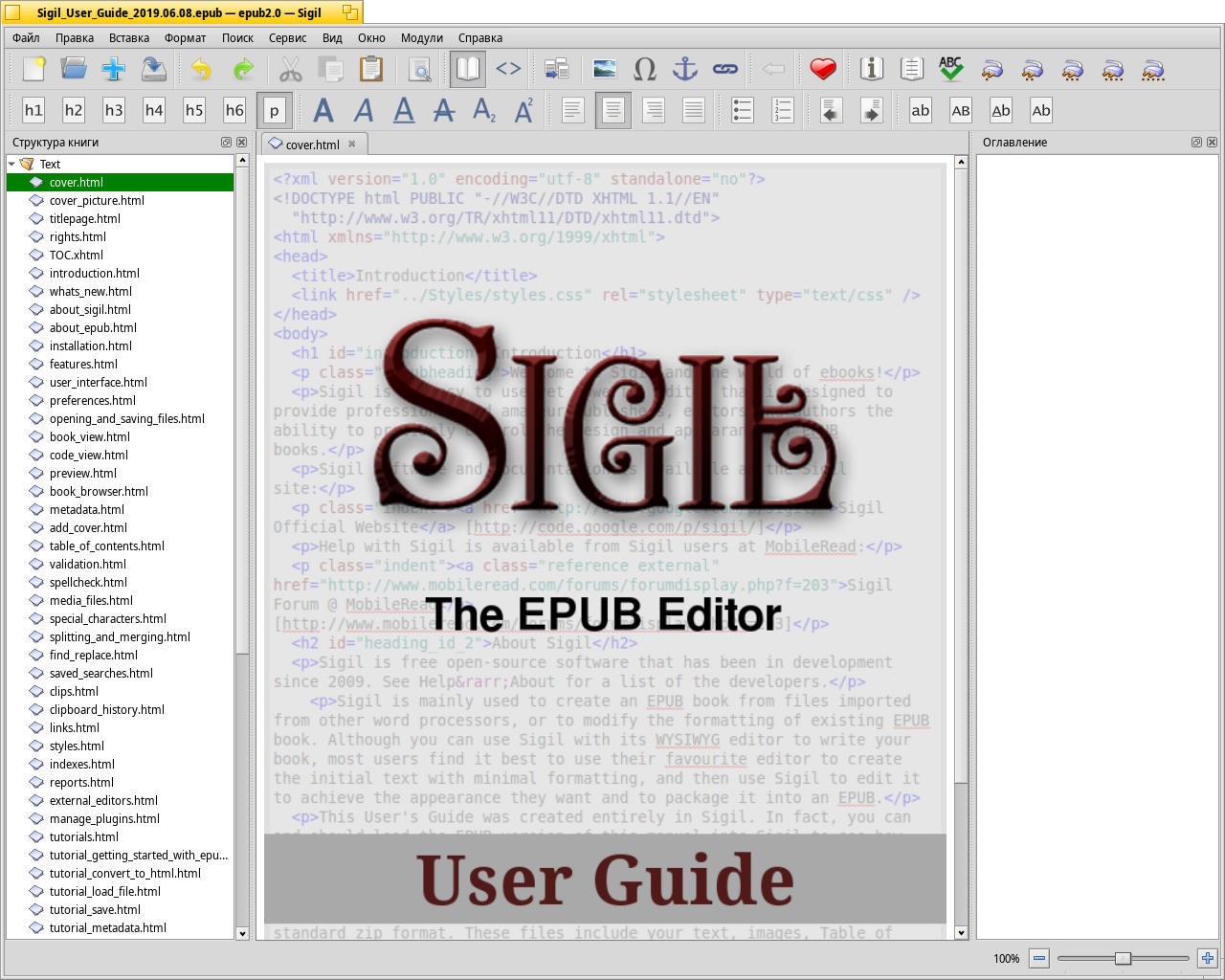

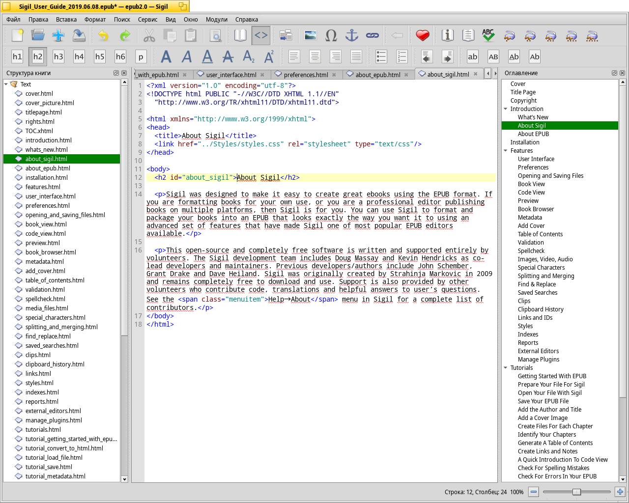

Another good day and another good news.
At the last stage of porting Sigil, a well-known man in the Haiku community with the nickname 3dEyes joined the work. He remade almost everything. Sigil now works with Python 3.7 and all system libraries and dictionaries in the 32-bit and 64-bit versions of the operating system.
Sigil can be installed from the Haiku repository using the HaikuDepot program. Spellchecking dictionaries for different languages ​​(hunspell/myspell) are also available for installation there.
The work is not over yet. It is necessary to finish some points and check the functionality. It is especially important to test the functionality. In my work, I do not use all the features of the editor, so I invite all interested to join this test.
Congratulations to the entire Sigil community !!!
Now you can safely change the line in the "About" section to "Multi-platform: runs on Windows, Mac, Linux and Haiku".

Very cool! Thanks for reporting back.
Do you know if the system hunspell library is available to plugins or not? That might be something to look at. There's a test plugin in the docs directory of the Sigil source (make sure you use the version found in the source at the same tag-level you built) that can be installed/run to test the various pieces of the plugin framework.
I know that Tkinter is not available on Haiku, so plugins that rely on Tkinter for gui features are not going to work, but I had plugins that used PyQt5 working. That test plugin will report which features of the plugin system is working and which are failing. Most will be down to making sure certain python modules are installed, but a few features (including libhunspell) may need some tweaking.
