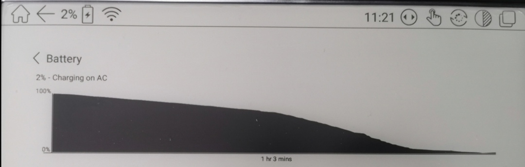

it seems like a problem of onyx devices that when connected, the device still uses battery energy instead of skipping the battery and using straight it from the USB like 99% of the similar devices, killing the batteries pretty fast.
Usually a phone, laptop or tablet can last 3/4 years of heavy usage without problems and here we have devices dying after 1 year.
Doesn't look good for onyx.

Hi,
Finally I have managed to replace battery. [...]
3.7 v 4100 mAh 3 wire lipo battery; size: 2.6 mm x 80 mm x 159 mm [...]
When I was totally disappointed I came on local battery repair shop that was willing to modify one of the batteries which they sells. It was Asus Nexus battery
https://www.amazon.com/Replacement-B.../dp/B01HNSCD88
The battery has got 6 wires, they replaced it with PCB from my battery which has got 3 wires. I got the new battery for 30 euros. I hope it will last more than original one.
Thinking of ordering one. Is that possible/easy to do manually? Anyone? Or might somewhere local do it? I use my max2 as a monitor constantly in fast refresh so I know the battery will die at some point.
The power bank solution could be OK. I use a laptop, so I could just keep it powered by the usb port, but the ones on my laptop have a tendency for a faulty connection, so I too would probably use a power bank in between the laptop and the monitor, with the added benefit that I could reboot without worrying (as much) about the monitor cutting out.
This "cutting out", however, is exactly what caused a previous device to take its last breath, after its battery stopped working, namely, the n96ml: another onyx model.

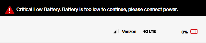

Most devices try to be clever with figuring out battery charge (which is not simple).
They count the electrons going in and out.
So if you have a dead battery and it says 10% and you replace it with a fully charged battery your device will say, "Wait, it was at 10% and now the voltage is suddenly higher but I haven't seen any electrons going in. Therefore it must still be at 10%."
I've run into this problem a lot.
You can't just tell it, "Dude, it's at 4.2V, you're telling me that's 10%?"
This is my JetPack which has plenty of voltage but it's too stupid to notice.

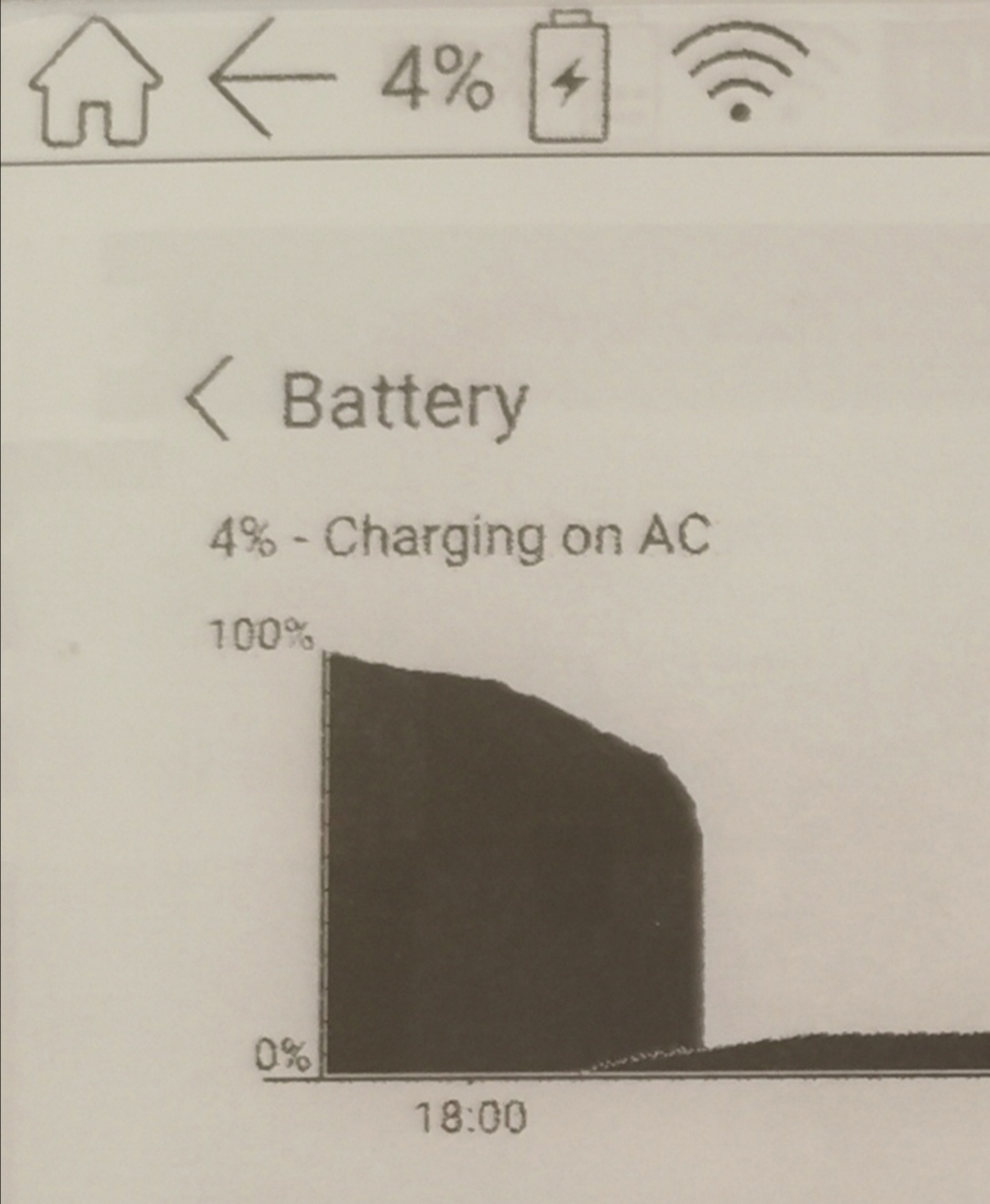

Unfortunately the dedicated replacement battery is dead. I do not recommend buying it. Before finding that one I had already bought online the Nexus battery. It was a hassle to replace the charging board, but I managed, works perfectly!
I tested the batteries by opening youtube in the built in browser, watching an old movie https://www.youtube.com/watch?v=h9c1T-ZukQA
The dedicated replacement battery consistently died below 50% at about 30 minutes of the movie.
The Nexus battery also loose charge quickly watching the movie, but it holds well till the end.
It's really subjective, but it feels like the reader is working noticeably faster with the Nexus battery.
I've never watched movies on this tablet before so I have no idea if the 1h of playtime is a good result or not. At least the Nexus battery behaves consistently. I guess the e-ink draws much more power than a typical IPS display on a phone when it's continually updated at max refresh rate (I think it can get up to 20 fps).
Well, I'll see if I can use it again for a whole week without charging for a basic reading.
