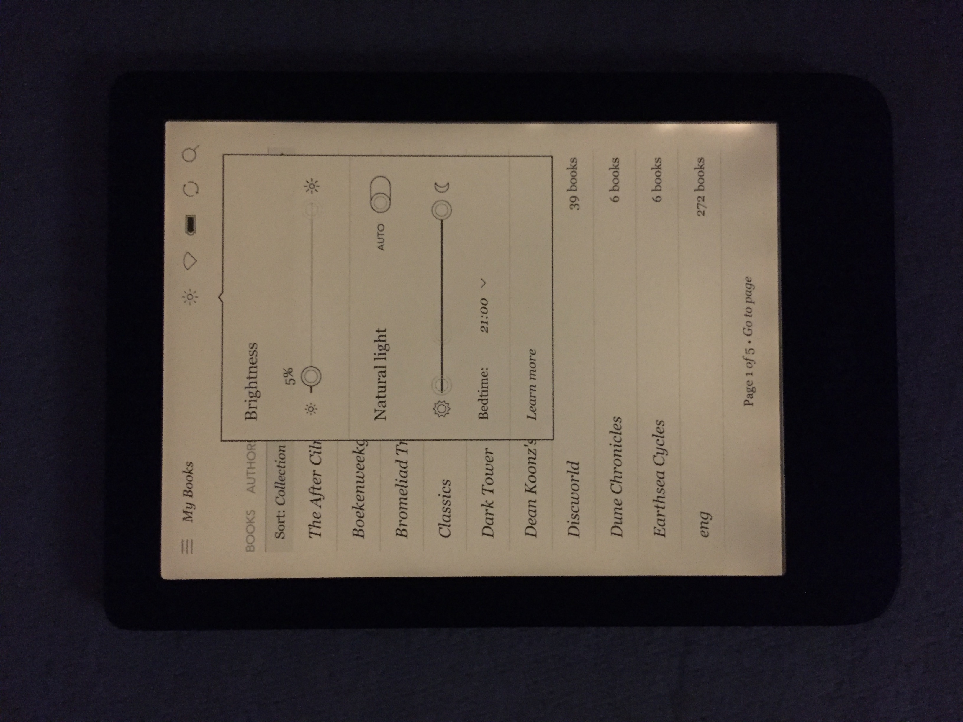

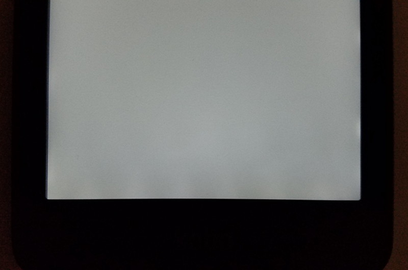

It is extra light leaking in from the sides of the screen, causing offputting bright patches. It was caused by kobo not putting blackout tape on the sides of the screen, so when the frontlight was turned on, extra light would show up.
It seems to have been fixed on newer builds. Mine doesn't have that issue and I don't think many people do. But such a simple flaw getting through quality control looked bad.

in the photo Clara you recently bought?

No. As mentioned, mine doesn't have the issue at all. That photo was from the Clara thread where light bleed came up.
Far as I know, the issue has been resolved.

But around 8:13 in this youtube video, you can see glo HD on the left shows a similar lighting as the second picture you uploaded previously about Clara HD.

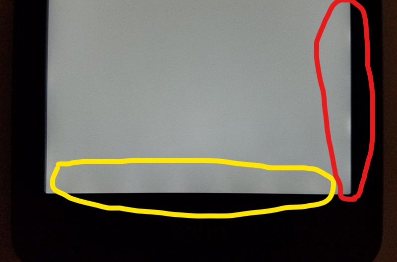

To be clear: the issue isn't the cones of light at the bottom of the screen (those in the yellow circle). Those happen on all lighted e-ink screens under some lighting conditions (usually if you have the light set low in a very dark room). The light bleed is the light on the side (the red circle). That is a defect of the Kobo manufacturing process that needed to be fixed.

I'll leave the research and decision making up to you. I don't have a Glo HD to compare the Clara to. I wouldn't hesitate from buying a Clara only because of the light bleed. Like I said, I believe it is fixed and if you get a dud, you can exchange it.
Sounds like you have other reasons to buy the Glo HD. But since Kobo hasn't made the Glo HD for a while, you're buying a used, years old device and possibly paying more for it. Something to consider.
This is a screen defect. Apparently Kobo began to check the screens more carefully. Or changed the supplier.

No, it's not a screen defect. It was failure by Kobo to add blackout tape to the sides of the screen. People who bought Claras and had this problem were able to fix the issue using electricians tape, as you can see in this YouTube video:
So you think and assure everyone that they are added? This is not true.
They just improved the release control. AFTER numerous complaints and returns.
