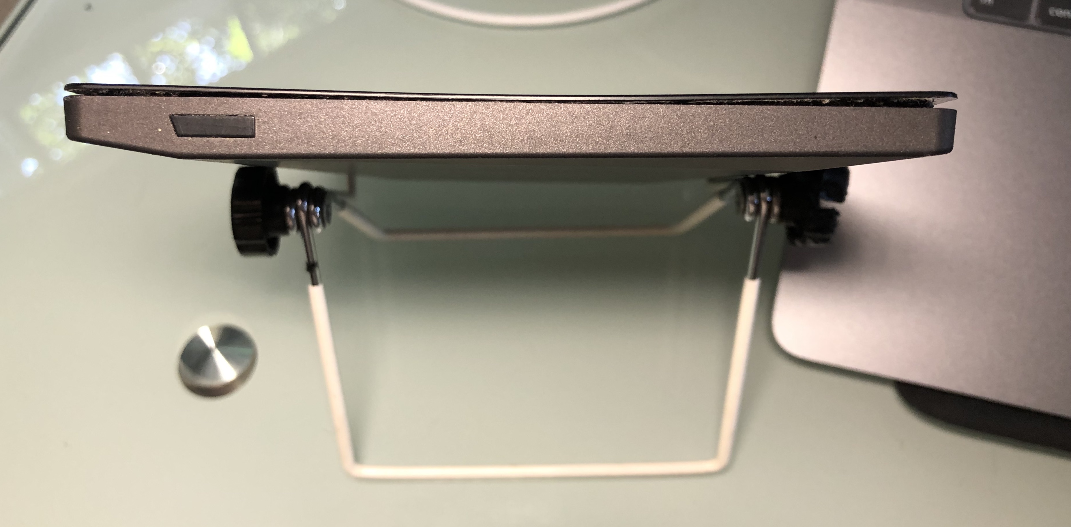

Question about the adhesive on the bezel, should I remove them? Some parts still have them while some don't, so that it now looks a bit uneven, sticking up in some parts and lying flat in others. (Pic of top view attached.)

I think it's double sided waterproof tape?
Someone that has done this successfully is likely best to reply. Likely the bezel distance and being level is critical.
I just scrapped the balls that formed from prying it off with a fingernail, and there is still enough left to hold the bezel and there are no gaps left in mine.
Or you could opt for replacing it alltogether.Iwe read someone using wd40 to remove it clean, but if you dont have some wd40 on hand, plain cooking oil worked for me on sticker residue so it could work for this too, worth a try.Alcohol could work too. But if you go the alcohol route be cautious as alcohol could potentially cloud up the shiny plastic part that reflects the ir beams and could potentially spell trouble.Best would be to first try a small edge and see how the plastic reacts to the alcohol.
And then get some double sided tape.
Quick google with the term from @FrustratedReader - double sided waterproof tape, gave this result.

Foam sounds wrong.
Anyway without a single piece there would be gaps at the four corners, so probably any regular non-foam tape from a stationary shop etc will do. Random stuff I've bought locally for putting thin alloy panels back on equipment was like the original. I've just no idea if it's waterproof, but on reflection that doesn't matter as it's best to assume the H2O isn't waterproof. My idea of a waterproof case is one that has a clamped neoprene ring in a groove, the door flap is halfway on that. I can't see how an original H2O won't leak between panel and bezel anyway.
It has adhesive there too, so its basically sealed from both sides.

Thanks for all the inputs, I'll try if I can find waterproof double-sided tape. If not, I might make do with regular double-sided. It's probably safe to assume I won't be able to restore the "waterproof-ness" of my H2O

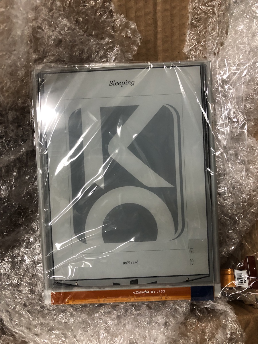

I just got my replacement screen today. I was horrified to receive a dented box and to open it and find the fragile screen wrapped only in bubble wrap. I was almost sure I was also going to unopen a broken screen. However, this looks ok, right?
Reading through this thread again to check how I should go about my screen replacement. Wish me luck!

Good luck, and i see it is enticing you to put koreader on your reader with that screenshot after you finish the replacement: )

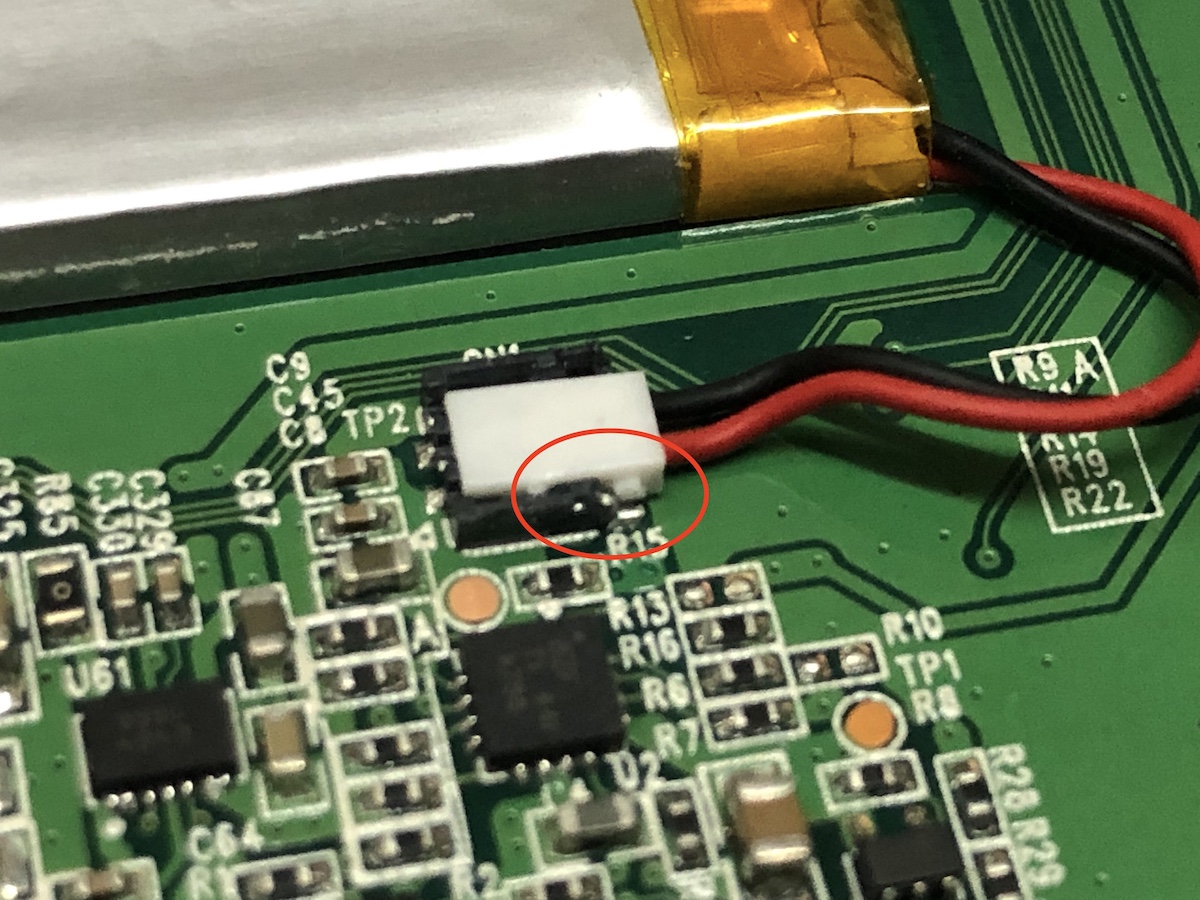

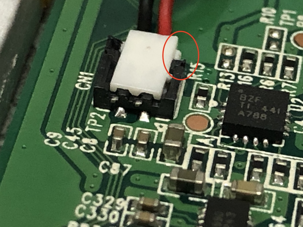

I got it to work but I seem to have broken off a small piece of the part on the board where the battery clips to. The H2O turns on when connected to a micro USB cable and the LED's immediately turn off when I unplug the cable. Either the battery is broken or it's not connecting properly because of what I broke.
Even with the cable connected, sometimes the touch screen just stops working (even with the LED's still lighting up) so I'm not really sure what else is wrong.
Screen seems a little washed out especially around the top but I could have lived with it. As of now I'm not sure if purchasing another battery is an option since I'm not sure if it's the battery that's not working or if it's the broken piece on the board itself.
Update: I opened up the reader again and tried reseating the battery clip. It's now turning on without the cable.
Frostschutz also made a really good suggestion of taking pictures as you go which I did. I'll be posting a step by step of what I did soon in case it helps anyone else in the same boat

Good news , maybe the battery needed a bit of charge.
Send a pic of what component you knocked off the board, someone might have an idea whats the damage.

I've encircled the part with the missing piece that broke off. Thankfully the battery clip was still able to establish a connection despite missing part of the piece keeping it in position
I was getting concerned that you knocked off some of the smd components on the board, now that would have been pita to repair.
Good that its only the plastic from the battery connector, as long as pins are there ...
