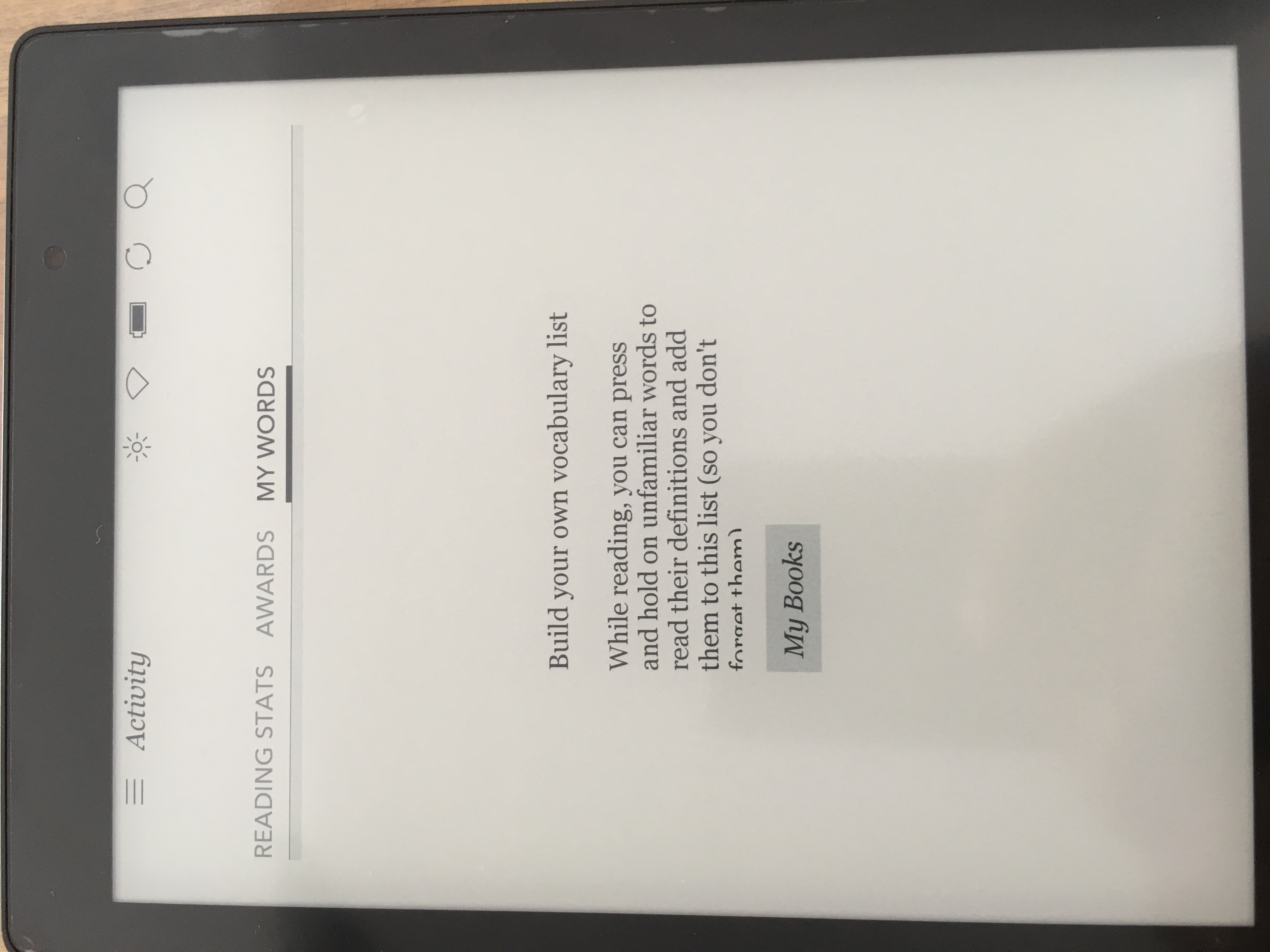

Thanks again. i applied the patch for the moments and its working well. but somes text missing in Menu/Activity/My Words
https://www.mobileread.com/forums/at...1&d=1536134891
I see. The text-box-size must be increased. I don't know where, but I'll try.
Good luck.
Note: Solved. Files updated. Thanks for feedback.

Hmmm... what patch is this? What does it do? I don't use it, but I don't think the text-box size is a patch related error. My Menu/Activity/My Words text-box was also too small (after activating My Words in the Kobo eReader.conf file and before applying patches, I think, but I could be wrong). Of course now the text-box is gone because I've added words
Mrs_Often is offline   Reply With Quote
Old 09-05-2018, 04:29 PM   #45
jackie_w
Posts: 6,359
Karma: 16800000
I'm not too sure either but I think it might be based on tshering's work 'for bad eyes' which enlarged the font-size in a lot of the general GUI widgets.
