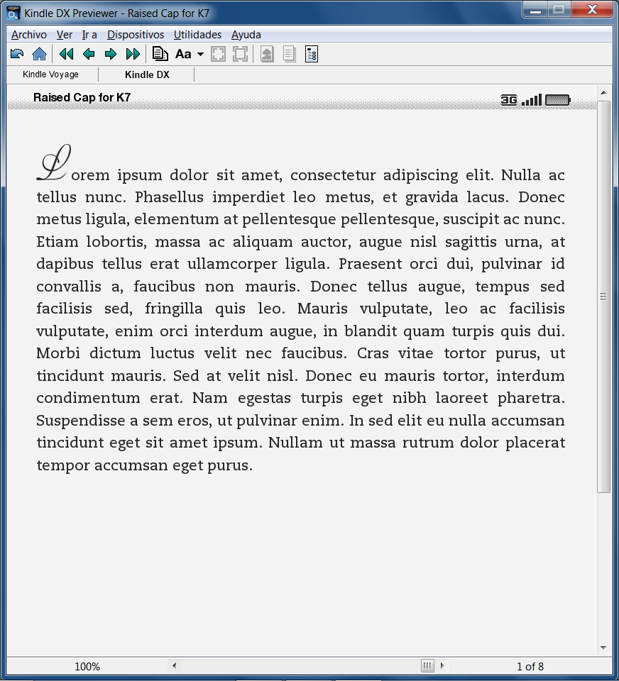

Is there a way to code real drop-caps for KF7? I've always been under the impression that the best I could do was "Up-caps," Kind of like Reuben's fall-back for the svg solution except with a larger capital.
Albert
For KF7? Maybe Hitch (she is the major expert about .mobi files in this forum) knows a way to have Drop Caps in K7 but to me, only is possible raised caps and by means of .gif images. Watch:
Below you can check the respective epub.
Regards
Rubén
