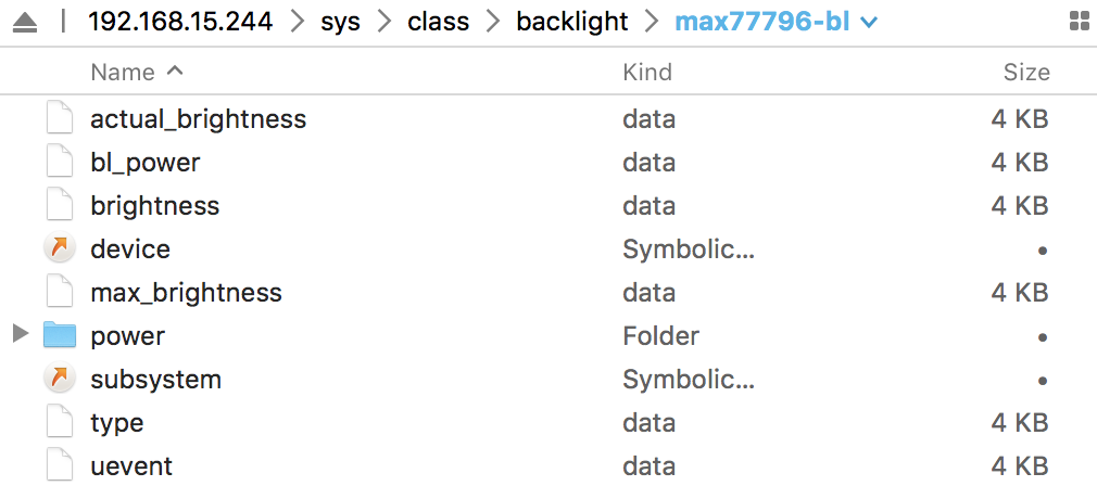

That definitely generated more, though whether it's helpful I don't know
Re: the brightness, yes it does
Oops, posted before I saw your edit. Let me restart (I assume you need me to strace before launching?)
Name:	Screen Shot 2018-07-01 at 1.46.43 PM.png
