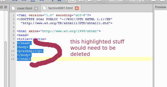

Now you're worrying me again. I mean...if you don't have current XML stuff, in what you're copying FROM, why would you be deleting the NEW head material in the NEW file, in the first place? (Am I confused, guys?)
Thanks Hitch. I just copy from the most recent epubs. Usually less than a year old. I just did a text comparison from a 2013 epub to the one I did just yesterday and the xml stuff is identical. Here's the xml from 2013:
<?xml version="1.0" encoding="utf-8"?>
<!DOCTYPE html PUBLIC "-//W3C//DTD XHTML 1.1//EN"
  "http://www.w3.org/TR/xhtml11/DTD/xhtml11.dtd">
<html xmlns="http://www.w3.org/1999/xhtml">
<head>
<title></title>
</head>
<body>
<p>&nbsp;</p>
</body>
</html>
So the quickest way has been to open a new blank html file in sigil. Ctrl-a its contents, then delete. Go to the 'old' file and ctrl-a then ctrl-c and come back to the blank html file and ctrl-v.
I do realize I'm not do delete any head material anymore.
I suppose I could leave the original xml stuff and delete what's under the <title></title> (screenshot) and then copy and paste what's under the <title></title> in the old .epub but then yeah, that brings the deleting into play. And it leads to the chance of not copying and pasting correctly.

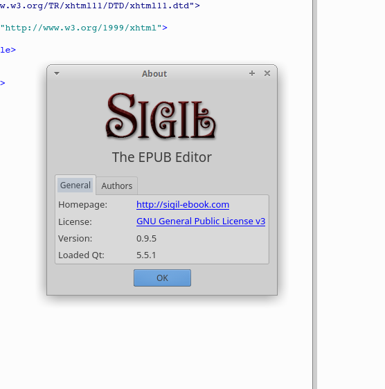

Wow, that version of Qt is way old. You must also have a Python 3 version someplace. What does the Sigil "About" window say about Sigil version and Qt version?

With 16.04, I'm sure he's got Qt5/Python3 available. He probably needs to use qmake5 and python3 commands to get their exact versions, though. The real question is probably how he's installed Sigil: from the standard repos, compiled himself, or my experimental standalone package?
Here's the About
I'm pretty sure I installed it through a link you gave me (and I assume that was your 'experimental standalone package') and it installed super easy.

Here's the About
You are using an old version of Sigil. The current version is 0.9.8. So maybe whatever went wrong is fixed in 0.9.8.
Thanks Jon. I will get 0.9.8 for my next book. Although 9.5 has been great (except for this latest). Do all the plugins (like the Language Tool) need to be re-installed in the new version?
