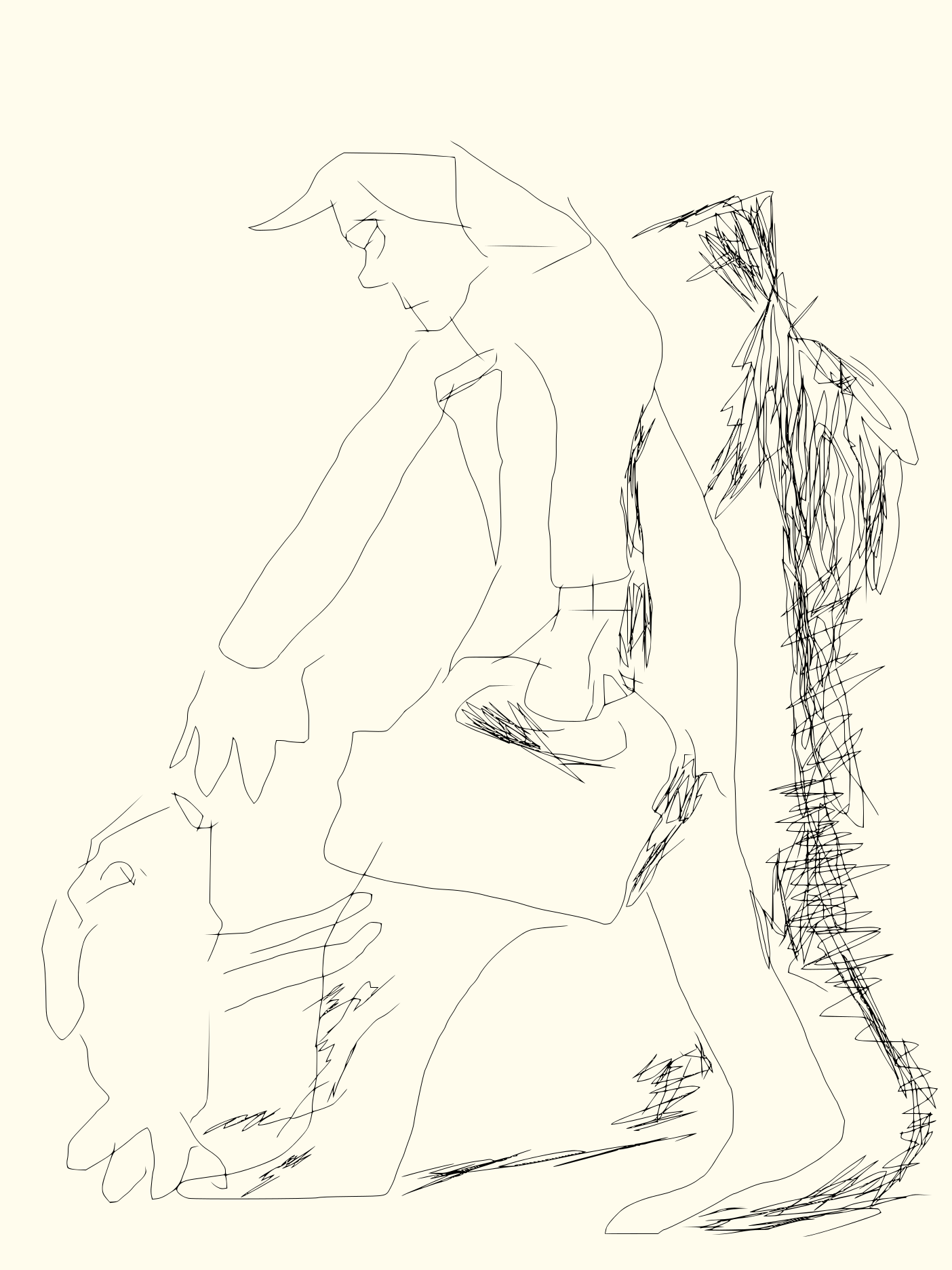

@nicolas161: You'll have to rewrite draw_line_segment in src/framebuffer.rs.
Another way to get thicker lines and anti-aliasing is to run potrace on the raw output (cf. attachment).
