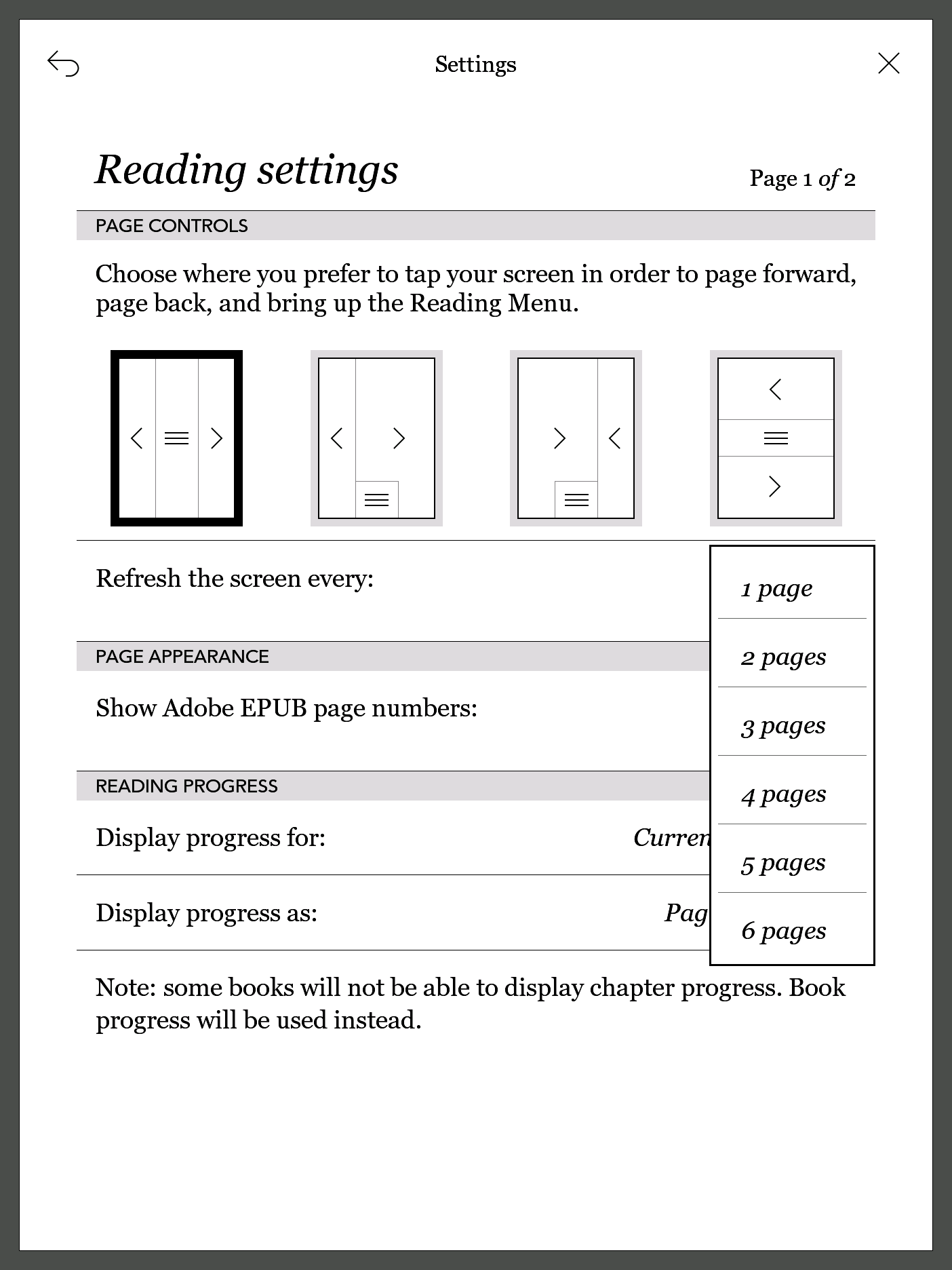

GeoffR, first of all the "Refresh pages every" menu in the Reading settings looks like the photo you have posted (in the Kobo Aura One).

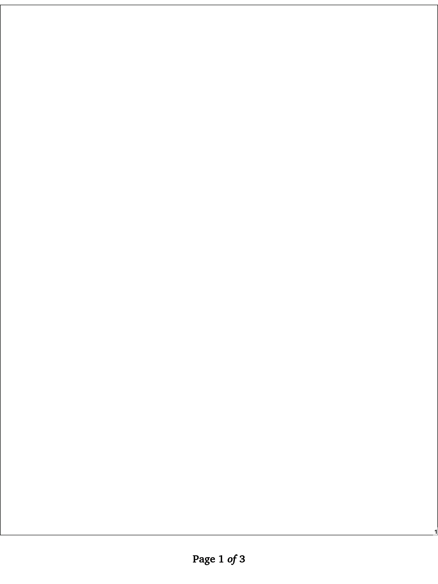

Could someone with an Aura One open this test epub: margintest.epub and take a screenshot of the first page with the margin slider set to minimum? Use normal reading mode, not full-screen.
That should allow us to see the exact size of the footer and built-in epub top margin.
Here's the results. I've also attached the refresh settings.

Thanks, that looks like a 15px top margin (same as other devives) and a 156px footer.
