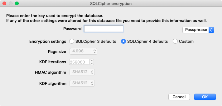

Password required for database
Since FW 4.14.12777 a password is required to open the database. Does anyone know the password?

Old 05-11-2019, 02:33 PM   #36
Elim Garak
Elim Garak
Elim Garak understands the Henderson-Hasselbalch Equation.Elim Garak understands the Henderson-Hasselbalch Equation.Elim Garak understands the Henderson-Hasselbalch Equation.Elim Garak understands the Henderson-Hasselbalch Equation.Elim Garak understands the Henderson-Hasselbalch Equation.Elim Garak understands the Henderson-Hasselbalch Equation.Elim Garak understands the Henderson-Hasselbalch Equation.Elim Garak understands the Henderson-Hasselbalch Equation.Elim Garak understands the Henderson-Hasselbalch Equation.Elim Garak understands the Henderson-Hasselbalch Equation.Elim Garak understands the Henderson-Hasselbalch Equation.
Elim Garak's Avatar
Posts: 18
Karma: 85712
Join Date: Feb 2017
Location: Cardassia Prime
Device: Touch/Glo/GloHD/Aura/AuraE2/AuraH2O/AuraH2O-E2/AuraONE/ClaraHD/Forma
Firmware 4.14.12777 does not require a password to open the database ("KoboReader.sqlite")!
Elim Garak is offline   Reply With Quote
Old 05-11-2019, 03:34 PM   #37
Dirk-71
Dirk-71 has every book they ever wanted in electronic form on their reader.Dirk-71 has every book they ever wanted in electronic form on their reader.Dirk-71 has every book they ever wanted in electronic form on their reader.Dirk-71 has every book they ever wanted in electronic form on their reader.Dirk-71 has every book they ever wanted in electronic form on their reader.Dirk-71 has every book they ever wanted in electronic form on their reader.Dirk-71 has every book they ever wanted in electronic form on their reader.Dirk-71 has every book they ever wanted in electronic form on their reader.Dirk-71 has every book they ever wanted in electronic form on their reader.Dirk-71 has every book they ever wanted in electronic form on their reader.Dirk-71 has every book they ever wanted in electronic form on their reader.
Posts: 185
Karma: 46112
Join Date: Dec 2016
Device: Kobo: Clara BW, Libra 2, Aura One, Aura H2O
Ok, but why do I get this dialog? I never had this before.
Dirk-71 is offline   Reply With Quote
Old 05-11-2019, 03:45 PM   #38
Dirk-71
Posts: 185
Karma: 46112
Join Date: Dec 2016
Ok, forget about it....I tried to open the wrong database, sorry.
