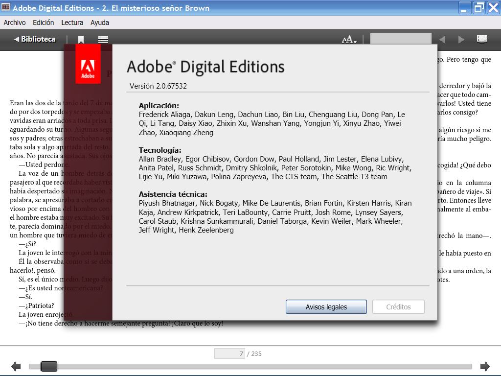

ePub 3.1 is not yet developed. It doesn't exist. Sigil doesn't handle ePub 3.1. So until it's a reality and Sigil works with ePub with soft-hyphens, this plugin doesn't need to be written. People will use it and it will cause all kinds of problems where those problems don't need to be.
Old 02-11-2016, 12:29 PM   #34
RbnJrg
Posts: 1,938
Karma: 9699999
Join Date: Mar 2013
Device: Kindle 4 NT
Originally Posted by rubeus View Post
Again: no. My ADE is showing soft hyphens all the time, regardless if they are at the end of a line or in the middle of a line. If its there, its been showed. Thats the reason why i still stick to this version of ADE, as it shows almost everything like my PRS650.
Well, watch the following screenshots of my ADE 2.0:
ID:	146204 Click image for larger version
The ebook showed is full of soft hyphens and they look fine in ADE.
Regards
Rubén

Did you define the language of your epub with lang="es" (or xml:lang="es") in the <html> tags?
Glup!... I did not do it systematically, big mistake.
With the homework done, ADE works perfectly.
¡Muchas gracias Rubén!

¡De nada jbacelar! Me alegra saber que dicha sugerencia solucionó tu problema.
