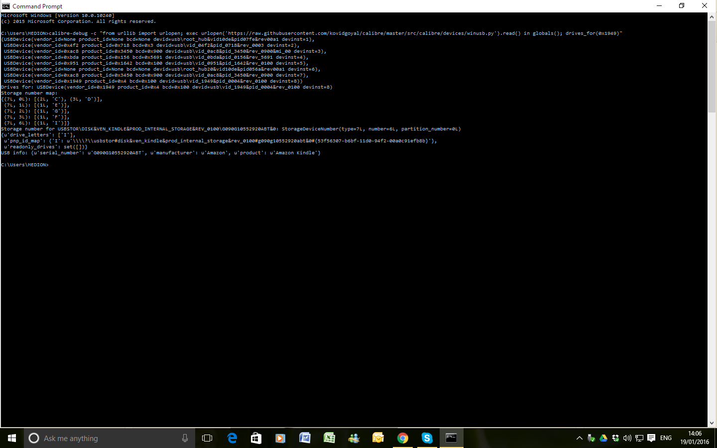

Yeah that the beta does not work was already established in another thread,
https://www.mobileread.com/forums/sho...d.php?t=269824
now I need to see the output from running (for Kindle)
calibre-debug -c "from urllib import urlopen; exec urlopen('https://raw.githubusercontent.com/kovidgoyal/calibre/master/src/calibre/devices/winusb.py').read() in globals(); drives_for(0x1949)"
for Kobo
calibre-debug -c "from urllib import urlopen; exec urlopen('https://raw.githubusercontent.com/kovidgoyal/calibre/master/src/calibre/devices/winusb.py').read() in globals(); drives_for(0x2237)"
Make sure to run these commands with the device connected.
Have run your CMD instructions and attach a screen shot.
Hope it helps
Kostas15 is offline   Reply With Quote
Old 01-19-2016, 10:32 AM   #37
Posts: 46,375
Karma: 29630884
Good, that shows my new code is detecting the drives for the device correctly. Try this beta build, it should hopefully do the trick

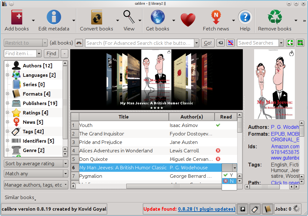

Can we transfer this request to a more appropriate section please?
and let me know where it has gone
As I mentioned earlier I am no wizz kid and it needs to be kept simple
My version of Calibre is set for three columns I believe has a tick in that box anyway
I think this example is getting on for what I require.
I want to indicate in a column that I have read a book and the ones I have not read will have nothing in the column
Then I would like to be able to sort my library of books showing only the unread ones, the read ones, or all books.
If this tutorial can be modified to show the above that would be great
Example Binary Yes/No type column: Here we are going to create a binary Yes/No type column with column heading "Read", look up name "read" and column type Yes/No. The entry Yes in this column indicates the book is read and No indicates the book is not yet read. After filling the entries and clicking OK in the window in the above figure a new column appears with title "Read" in the main calibre window. By double clicking in the position of the entries of this column a drop down box opens that allows you to select "Yes" or "No" or leave it blank as shown in the figure below. So you can now mark the read status of the ebooks in you collection as done for a few in the figure below. A green tick indicates Yes or read and a white cross in a red circle indicates No or not read. You can also leave the read status blank.
Old 01-23-2016, 06:17 AM   #44
Posts: 22,728
Karma: 34252730
@Kostas15 - Try clicking on the word 'Read' in the book list column titles - the common or garden way to sort multi-column lists in most software.
Try any of these in the search bar, assuming lookup-name is read, #read:empty or #read:"no" or #read:"yes"
If you're inclined you can create Virtual Libraries with names you want from those searches.
