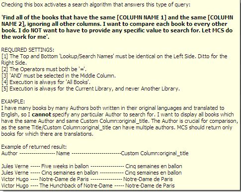

If you hover your mouse cursor over the checkbox "Inter-Book Search", a large yellow tooltips-box will open. It explains how to use "Inter-Book Search", including the "Required Settings".
See the attached image of the tooltips. Note "REQUIRED SETTINGS" item "[3]": 'AND' must be selected in the Middle Column.
By design, MCS automatically 'jumps back' to 'AND' plus the other required settings whenever you attempt to use "Inter-Book Search". It doesn't tell you that you disregarded the explicit tooltips instructions; it just corrects your mistakes and continues with the search.
MCS can use regular expressions to do 'fuzzy searches', but only for 'Intra-Book' Searches.
MCS 'Inter-Book' Searches only use the '=' operator, as indicated in the yellow tooltips. The comparison is done implicitly, not explicitly, entirely within SQL using a collating sequence of "exact match, not case insensitive".
MCS 'Inter-Book' Searches are an entirely different animal than 'Intra-Book' Searches.

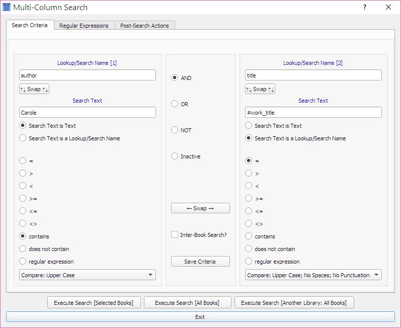

I need to compare two columns and mark the ones that fail to be equal.
@GM:
MCS 'Intra-Book' Searches were originally designed to do just that. See the attached example.
What it does not (currently) do is to first transform the values to be compared prior to comparison, such as both to upper case.
DaltonST

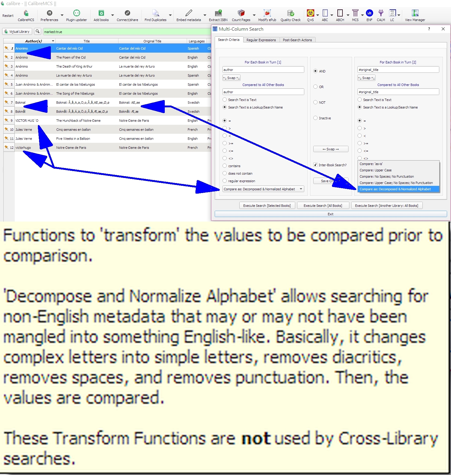

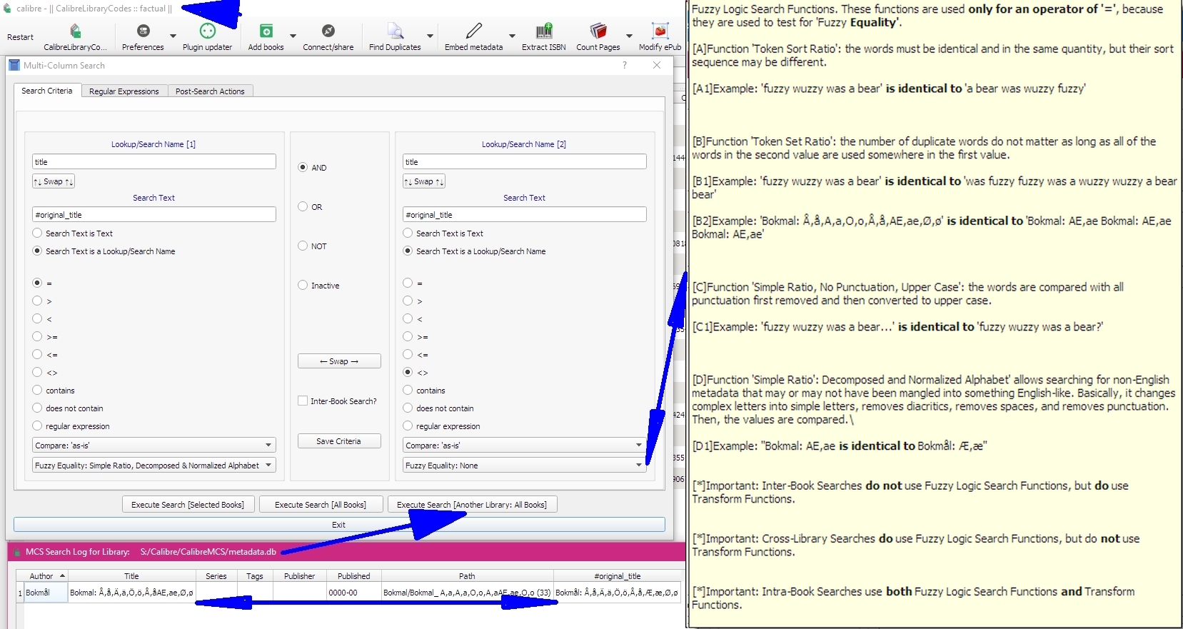

MCS: 'Comparison Transform Functions'
@GM:
Release 1.0.19 includes a new feature: Optional 'Comparison Transform Functions'. See the attached images.
Thanks for the good idea.
DaltonST
ID:	144120   Click image for larger version

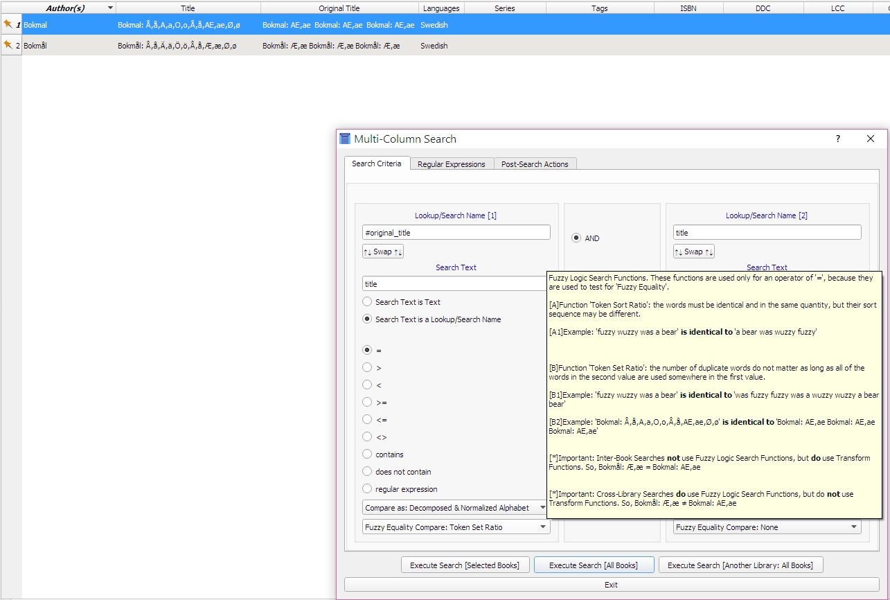

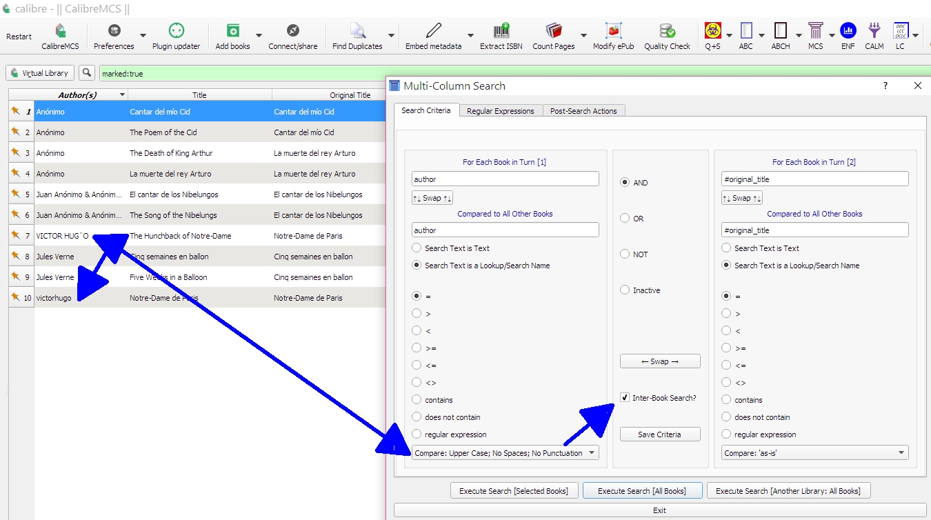

New Comparison Transform Function in Version 1.0.20
Originally Posted by Gary_M_Mugford View Post
Dalton,
Due to my predilection for Scandanavian mysteries, I find myself with ONE teensy request more, and that's for comparisons that ignore the extended character set diacriticals. Not sure whether to consolidate WITH the extended character attributes or whether just force everything back down to regular ascii.
Thanks, GM
@GM:
See the attached example from Version 1.0.20.
One word of caution: The greater that a particular metadata language's alphabet drifts from the Roman alphabet, the less accurate the new 'Compare as: Decomposed & Normalized Alphabet' Transform Function will become. Western European languages should (of course) work accurately, but Chinese, Japanese, Korean, Thai, and so forth will be (at best) much less accurate. The only Eastern European language I tested was Polish, and ĶźŽ was viewed as equal to KzZ for the purposes of searching, so it is likely that most of the Slavik languages will work well.
Obviously, if all of the metadata is properly spelled in a particular language, then of course the search will work perfectly. The issues arise when they do not.
For example, assume that the original title in Polish contained "ĶźŽŦ", but the translated title contained "KzZF". That would fail a check for equality, because the letter "Ŧ" does not transliterate to an "F". MCS would say they are different for that reason alone.
DaltonST

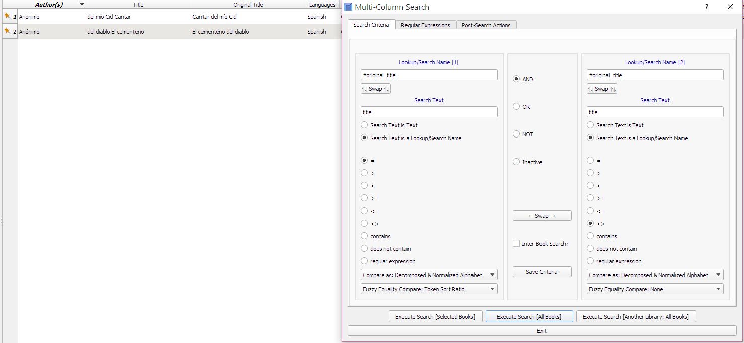

Version 1.0.21 - New 'Fuzzy Logic' Comparison Functions.
Version 1.0.21 - 05 December 2015 New 'Fuzzy Logic' Comparison Functions.
Refer to the attached examples and also the ToolTips for an explanation.
Be sure to read the ToolTips as pertain to the new dropdown selection boxes.
DaltonST
ID:	144330   Click image for larger version

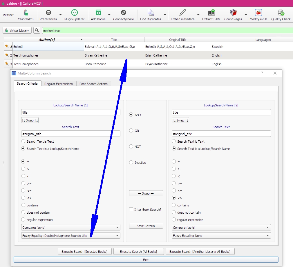

Version 1.0.24 New: Double-Metaphone 'Sounds-Like' Fuzzy Equality Comparison Function
Version 1.0.24 - 10 December 2015 New: Double-Metaphone 'Sounds-Like' Fuzzy Equality Comparison Function.
An example is attached below.
For more information about this phonetic algorithm:
https://en.wikipedia.org/wiki/Metaphone#Double_Metaphone
DaltonST
