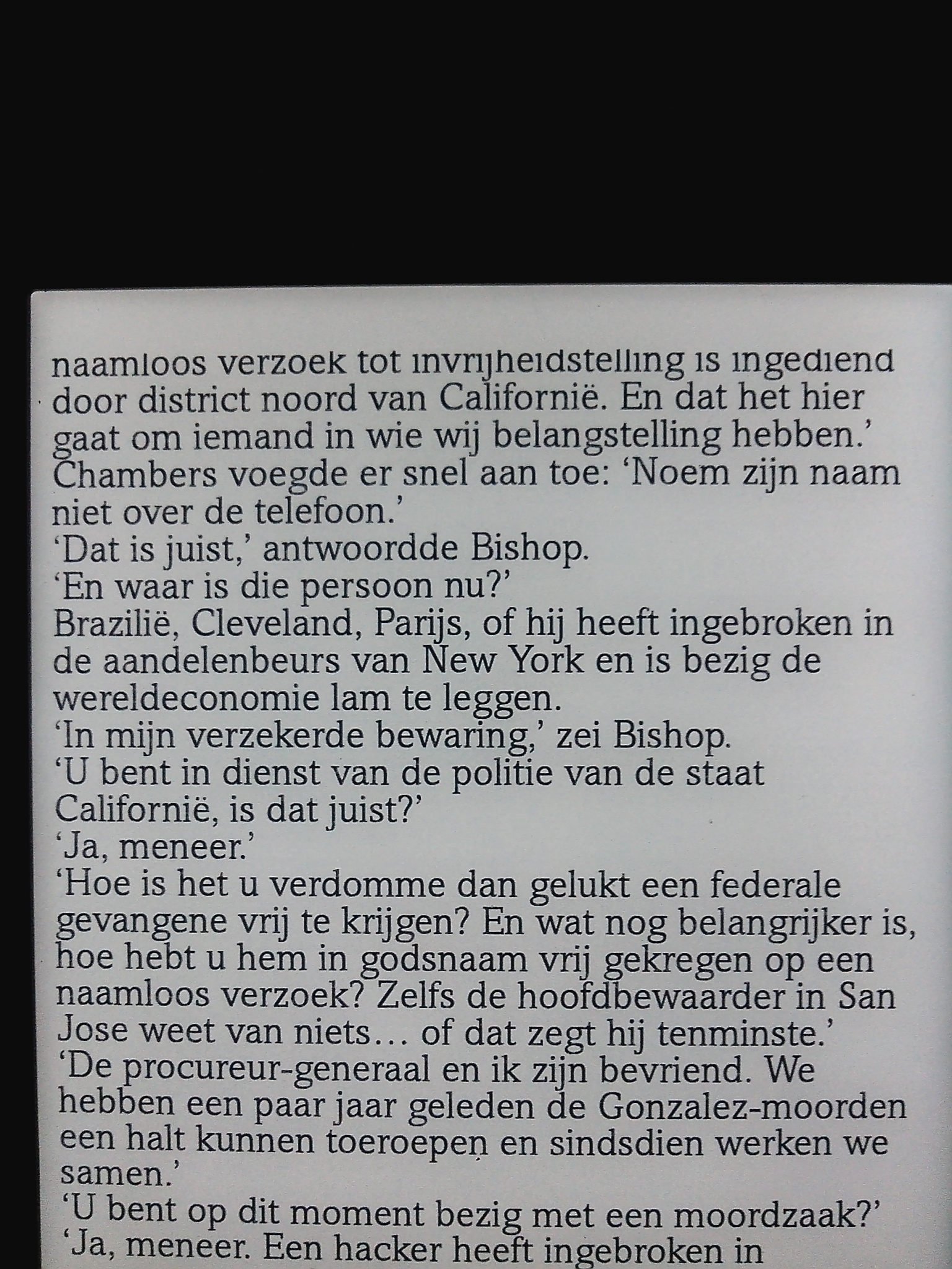

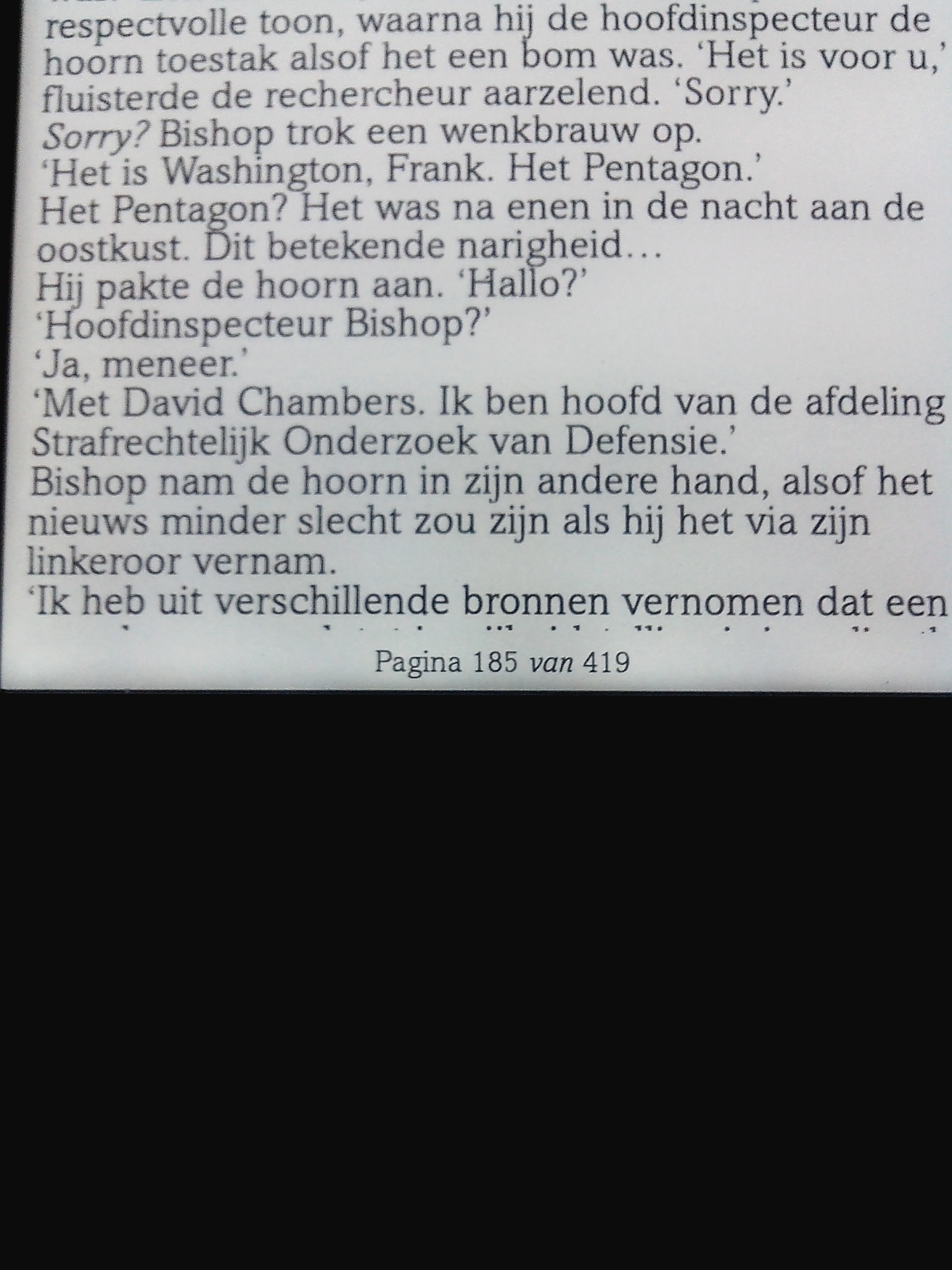

Something strange, in kepub, font Amasis, when I put the linehight to low or to high, the latest line of txt is not displayed well, it looks like the footer is shifting over it.
I do use the showPageHeader=false line in the conf. file.
Is it because I made the page xx of xx a little bit larger ?
When I set the linehight a bit by the slider you can see -------- at the bottom line, these are the top of the letters of the next line that is displayed on the next page, when I set the slider totally to the left, about 75% of the last line is visible, like a half s, a half e.
The new page shows the first line, and what is partially displayed on the end of the previous page,is cut off the first line.
If don't place the lineheight exact right,this is on every book.
I use all the default values in the patch for footer height, only the line for the txt height is changed, that code is:
# Replacement caption font size value for GloHD:
replace_string = 00C5, `font-size: 30px;`, `font-size: 33px;`
picture 1 shows part of the txt of the next page at the bottom, picture 2 shows the cut of first line.
This looks to me like the KEPUB page break bug that happens when the line spacing is too narrow. I think the only solution is to increase the line spacing, or use a different font, or use the EPUB reader instead.
I think I indeed must switch to EPUB, some books have forced linehight and I can't edit them all..or I have to add somehow a 5 point bottom margin ??
The fact is that the epub reader is so much slower then kepub.
I try if I can find options in the KoboTouchExtended driver to add it ( if that helps)
There is no way of fixing this bug ??
I can also look it up in the config file to see what linehight is the best.
Because when I change font, to lets say Malabar, the linehight used with amasis isn't correct to.
So switching fonts does not much, I only have to adapt the lineheight again,it seems not font related.
I get this problem too, if I start fiddling with line spacing or font size. I am using side loaded kepubs with Charlis SIL modified larger. (With header and footer intact). If I lessen the line spacing I normally use, the bottom cut off happens. So I generally just leave it alone.
