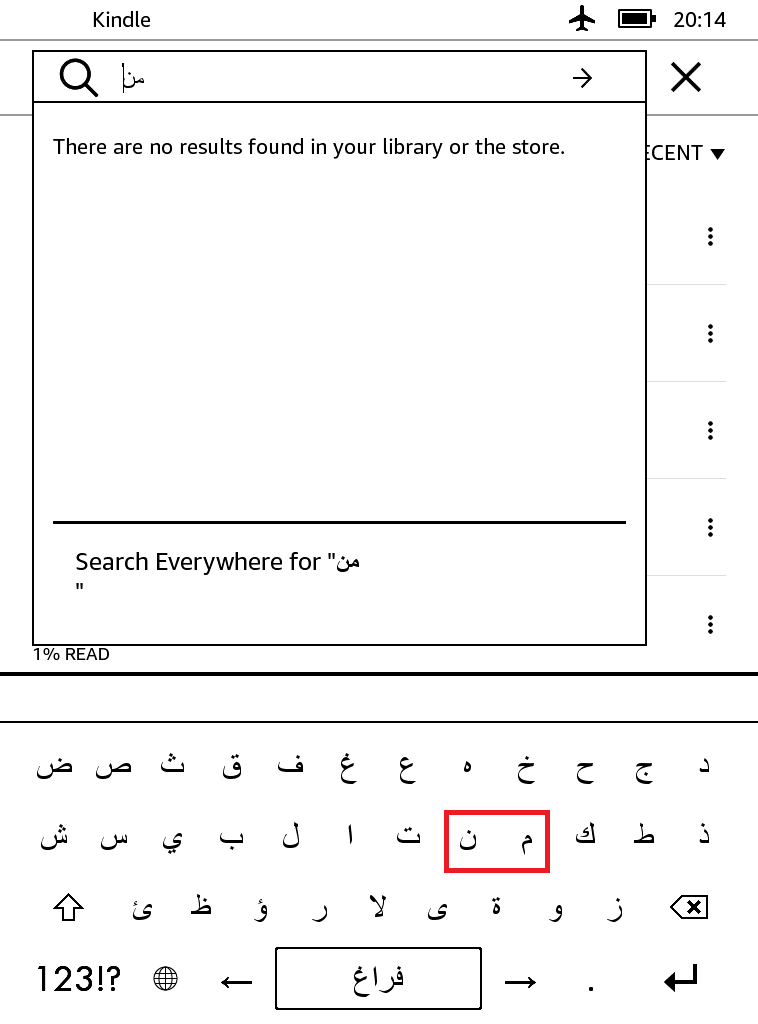

@knc1: If you want to double-check this issue yourself to exclude user errors, do the following:
1. Download this free Arabic AZW3 book from MR and copy it to your PW3.
2. Enable the Russian keyboard layout:
[menu] > Settings > Device Options > Languages and Dictionaries > Keyboards > Russian.
3. Install kaznelson's Arabic keyboard package (Keyboard_PW2.ar_DZ.zip) via MR Package Installer.
4. Open the book that you've downloaded in step 1 (Kalila wa-Dimna) and tap the Search icon.
5. In the Search dialog box, tap the globe icon to toggle the keyboard layout until the Arabic keyboard is being displayed.
6. Tap م followed by ن (see screen1.png) and start the search. (You should get a lot of matches.)
Note: Since I've installed NiLuJe's font hack, your keyboard will show slightly different Arabic glyphs.

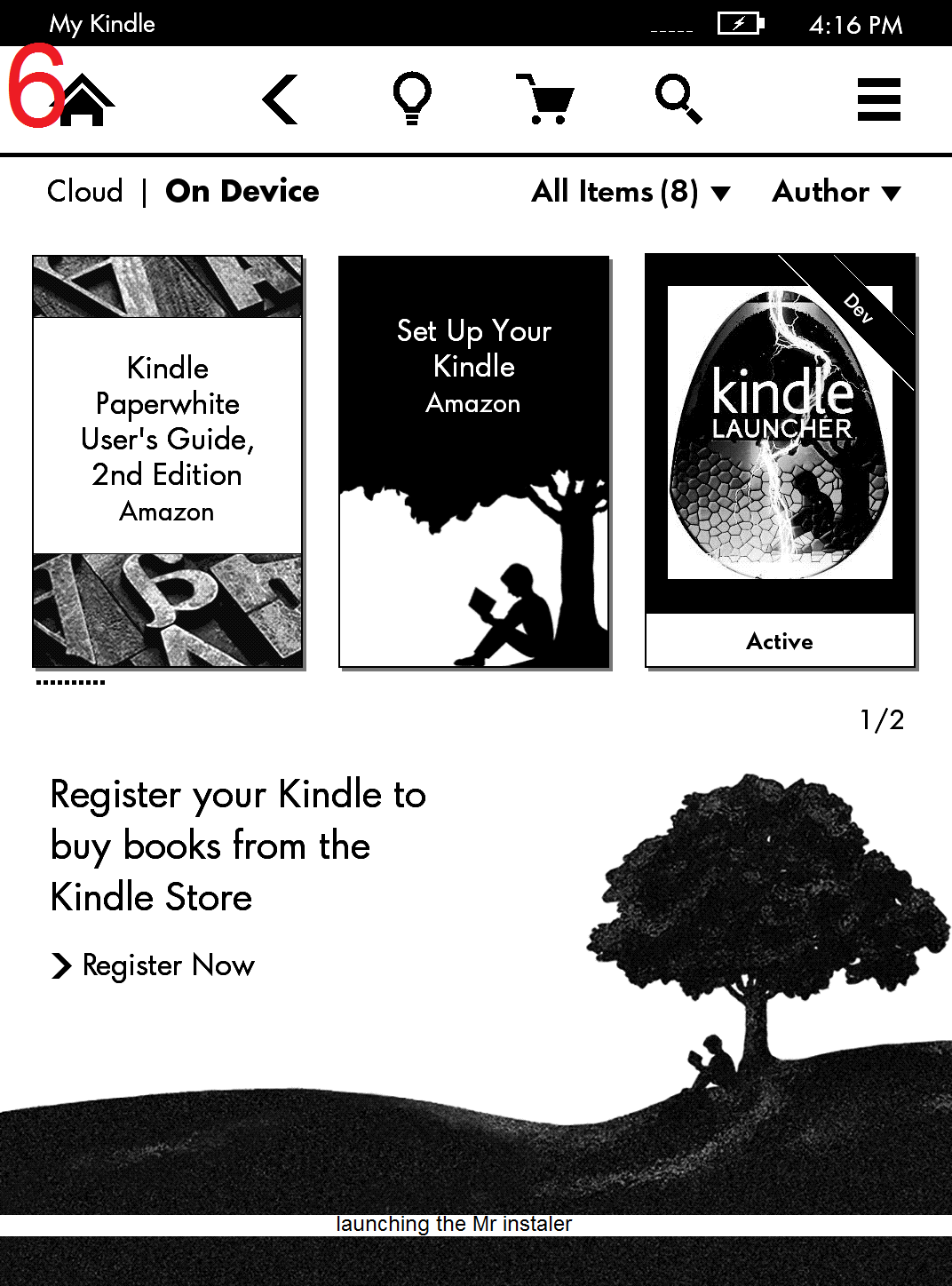

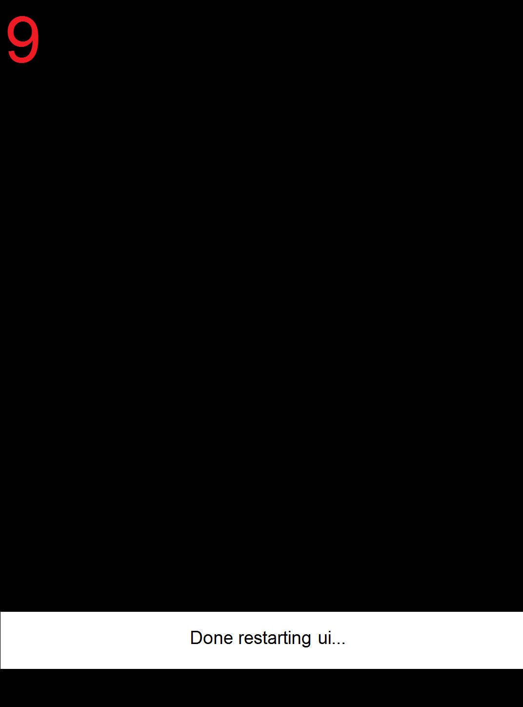

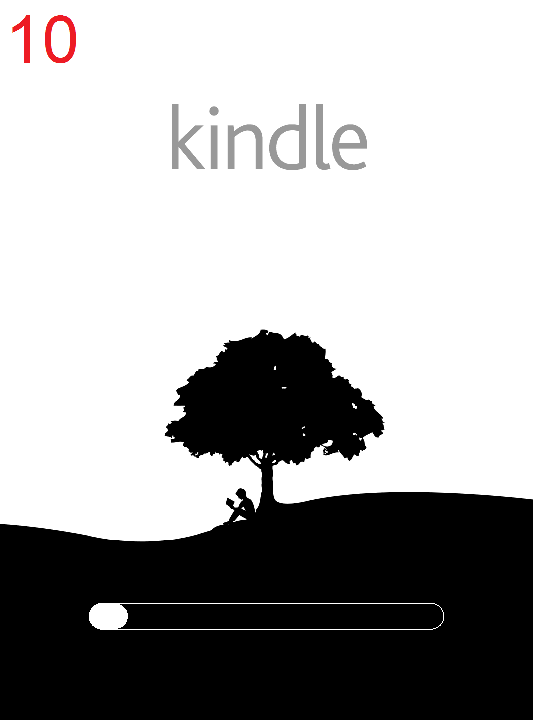

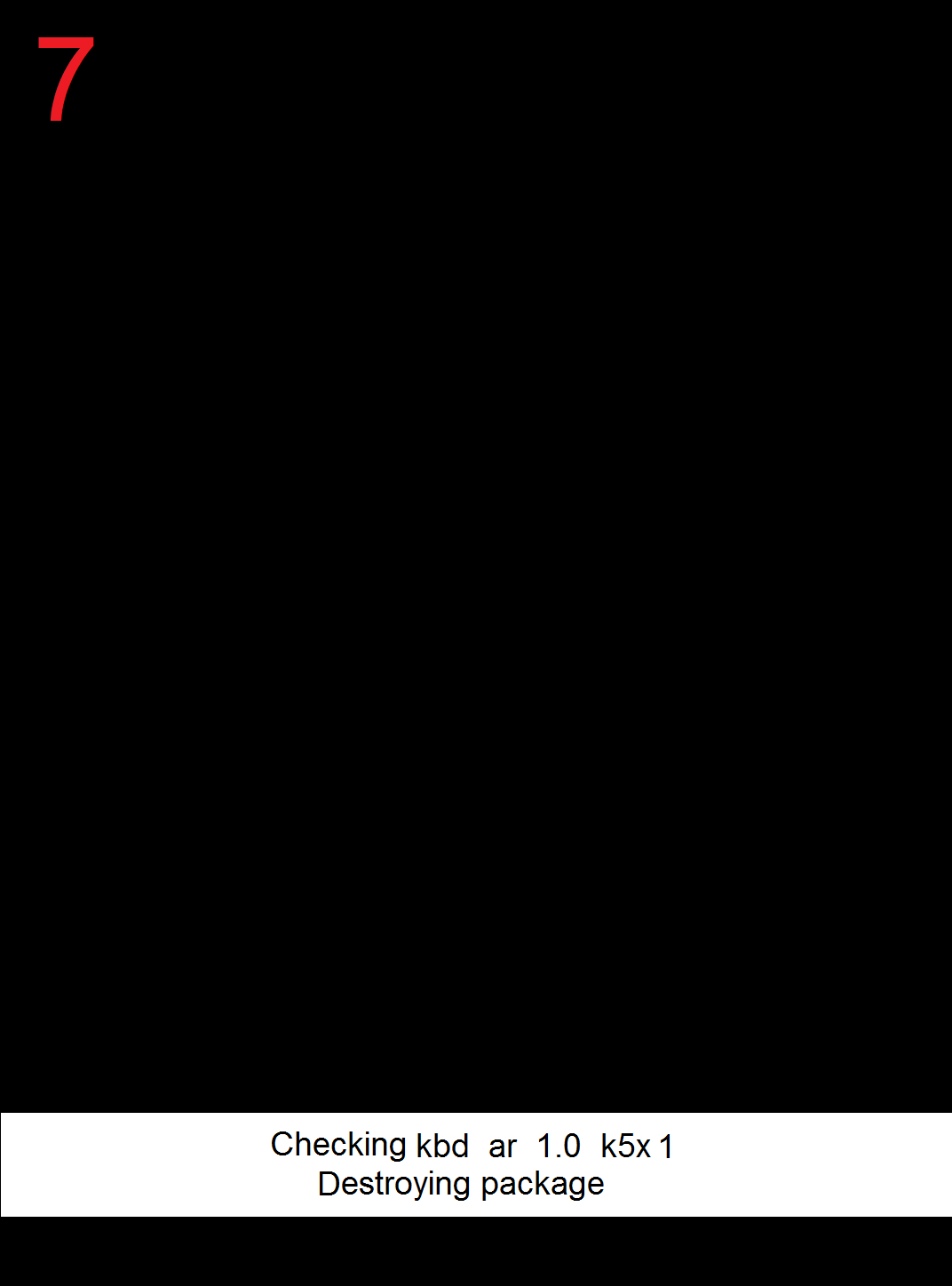

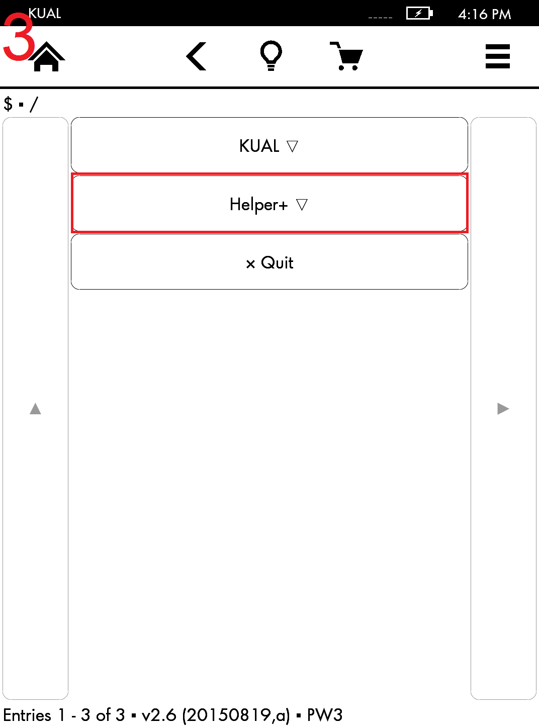

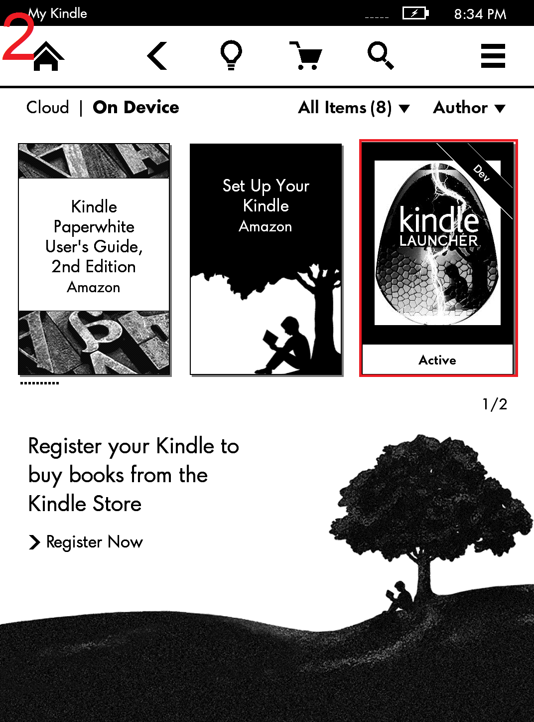

Old 05-28-2016, 05:21 PM   #42
K+kue
K+kue began at the beginning.
Posts: 11
Join Date: May 2016
Device: pw3 fw 5.6.5

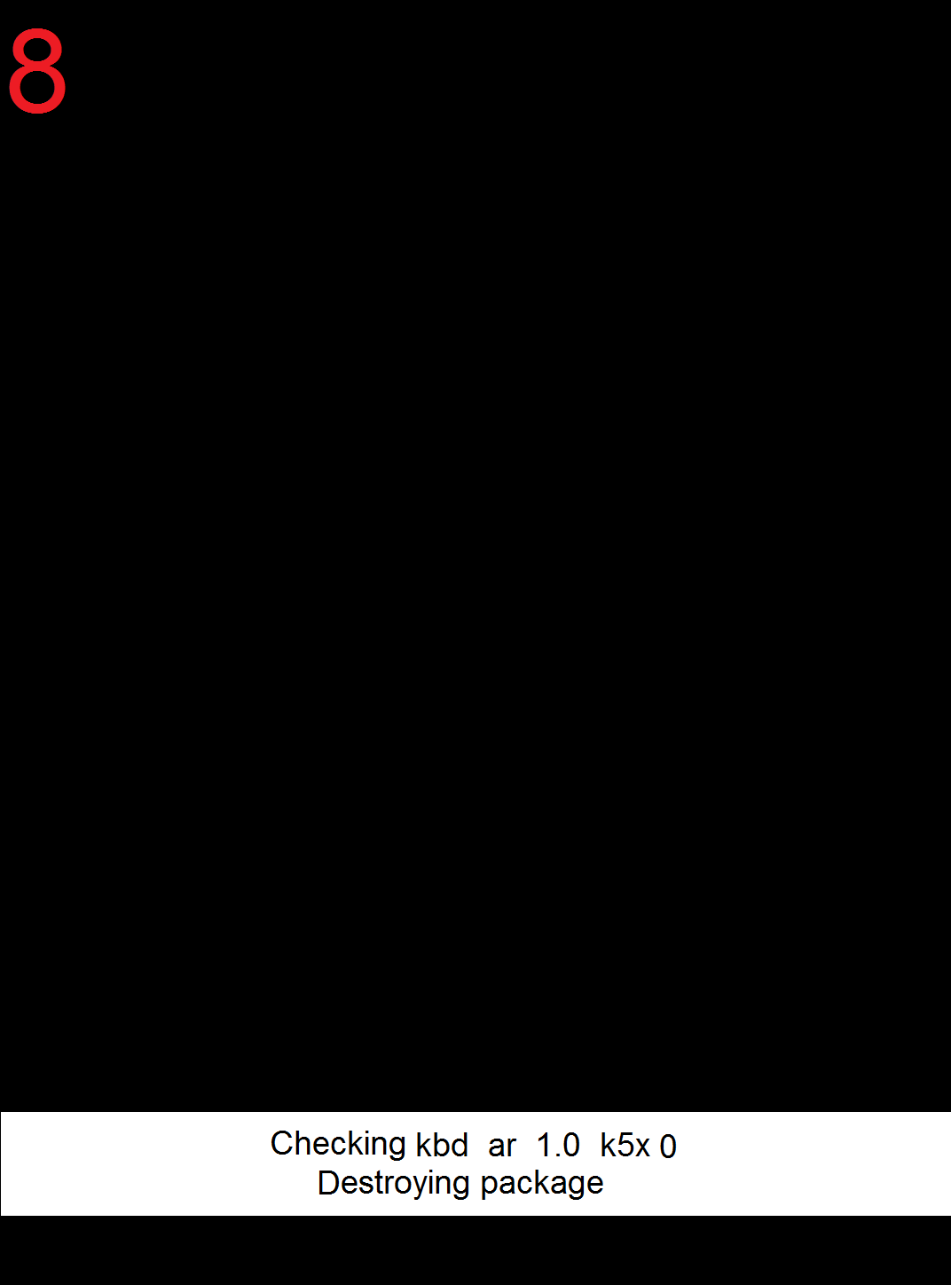

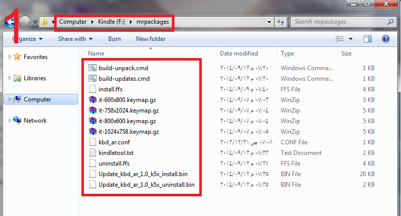

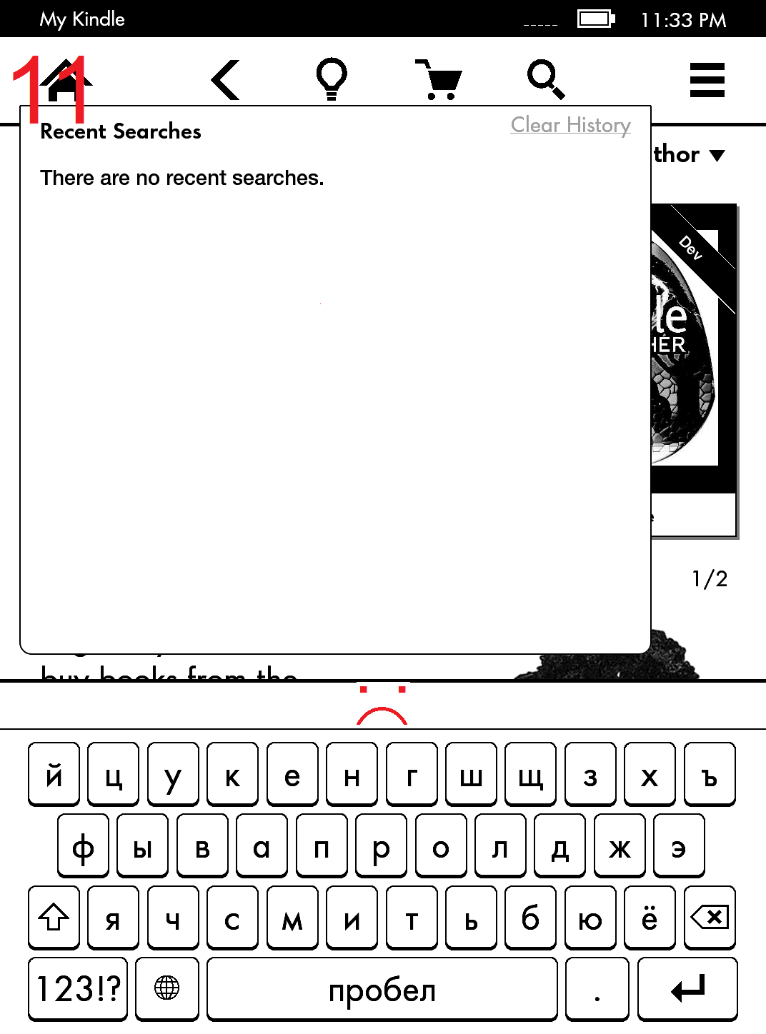

Ok
The Specifics
A--->Z
ID:	148976   Click image for larger version
ID:	148977   Click image for larger version
ID:	148978   Click image for larger version
ID:	148979   Click image for larger version
ID:	148980   Click image for larger version
ID:	148983   Click image for larger version
ID:	148984   Click image for larger version
ID:	148985   Click image for larger version
ID:	148986   Click image for larger version
ID:	148987   Click image for larger version
K+kue is offline   Reply With Quote

Old 05-28-2016, 06:41 PM   #44
NiLuJe
BLAM!
NiLuJe's Avatar
Posts: 13,507
Karma: 26047224
Location: Paris, France
@K+kue:
First, your timestamps are hella screwy.
And second, as mentioned, those packages are not targeting your device/FW, hence them being discarded by MRPI.
Check the MRPI log (extensions/mrinstaller/log/mrinstaller.log or somewhere around there) to confirm that.
