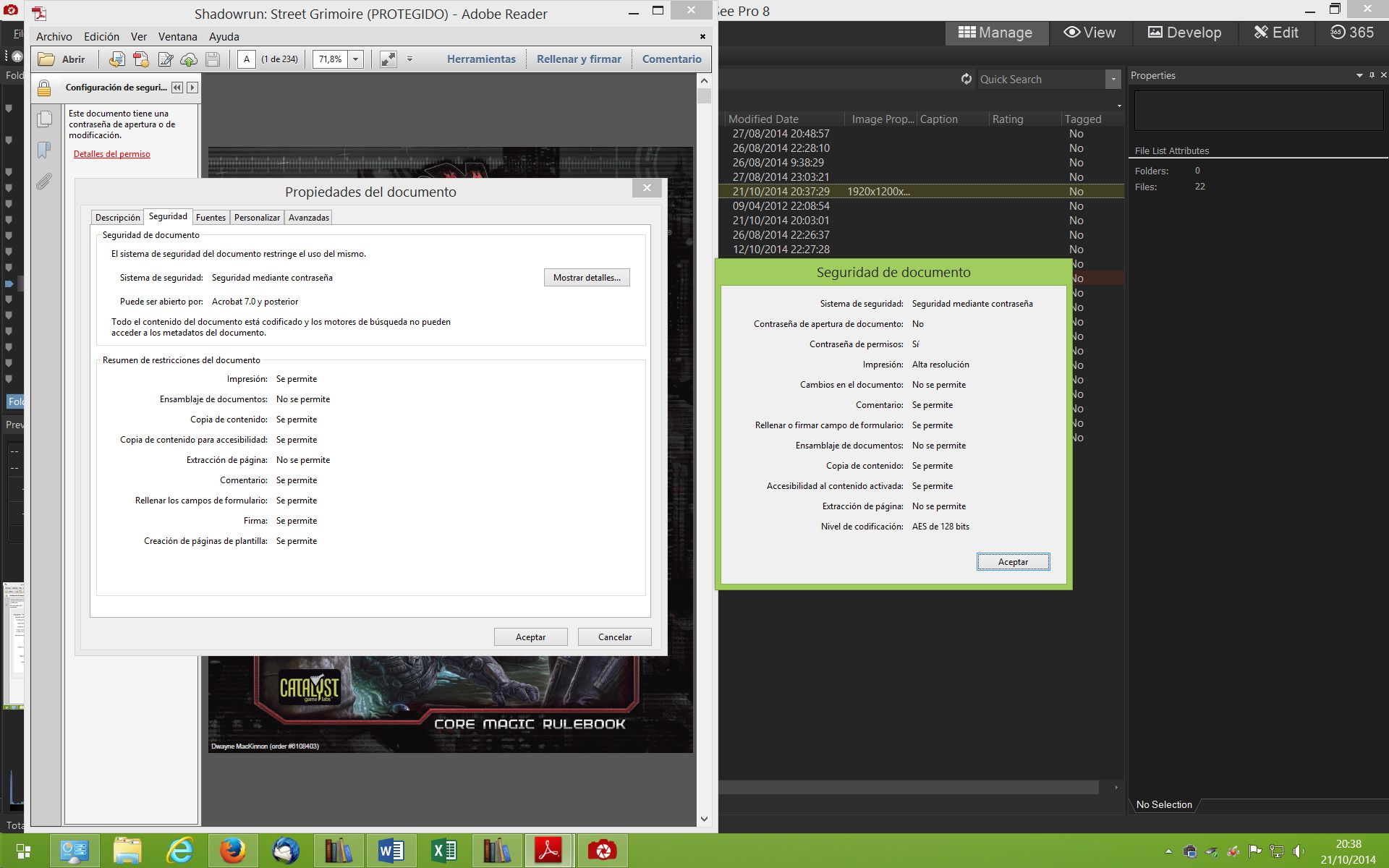

Just re-tested both pdf issues with 3.11.0:
+ Canon EOS 7D pdf: The same crash and reboot.
+ Your grimoire pdf (I've redownloaded it from the dropbox link you PMed me, it is still alive): I think it's even worse, it is so slow, my HD really seems bricked...
arspr is offline   Reply With Quote

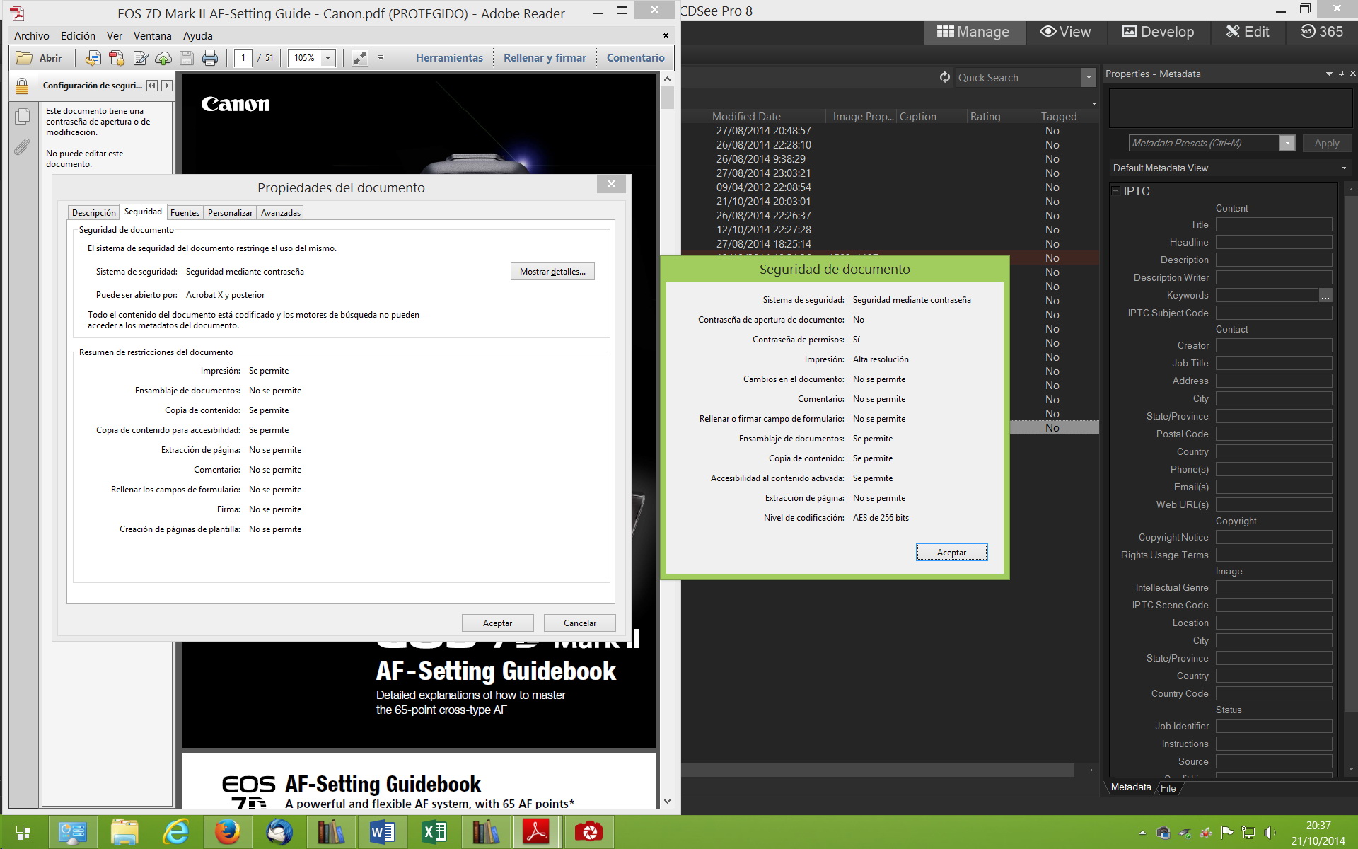

Yes, that was also hinted by ottdmk... But in either case it is a clear bug in kobo software...
EDITED:
I've opened ottdmk's pdf and Canon one in Adobe Reader XI and both are password protected for certain areas. I upload two screenshots, they are in Spanish but I suppose you'll easily understand/translate them.
Nevertheless the key differences:
  • Canon one requires Acrobat X or later, ottdmk's one just 7.0.
  • Canon one uses 256bit AES encription. ottdmk's one uses only 128bit AES encription
If I get across some other conflictive pdf I'll check its protection properties.
Name:	ottdmk's PDF (Acrobat 7.0 and later).jpg
ID:	129956   Click image for larger version
Name:	Canon PDF (Acrobat X and later).jpg

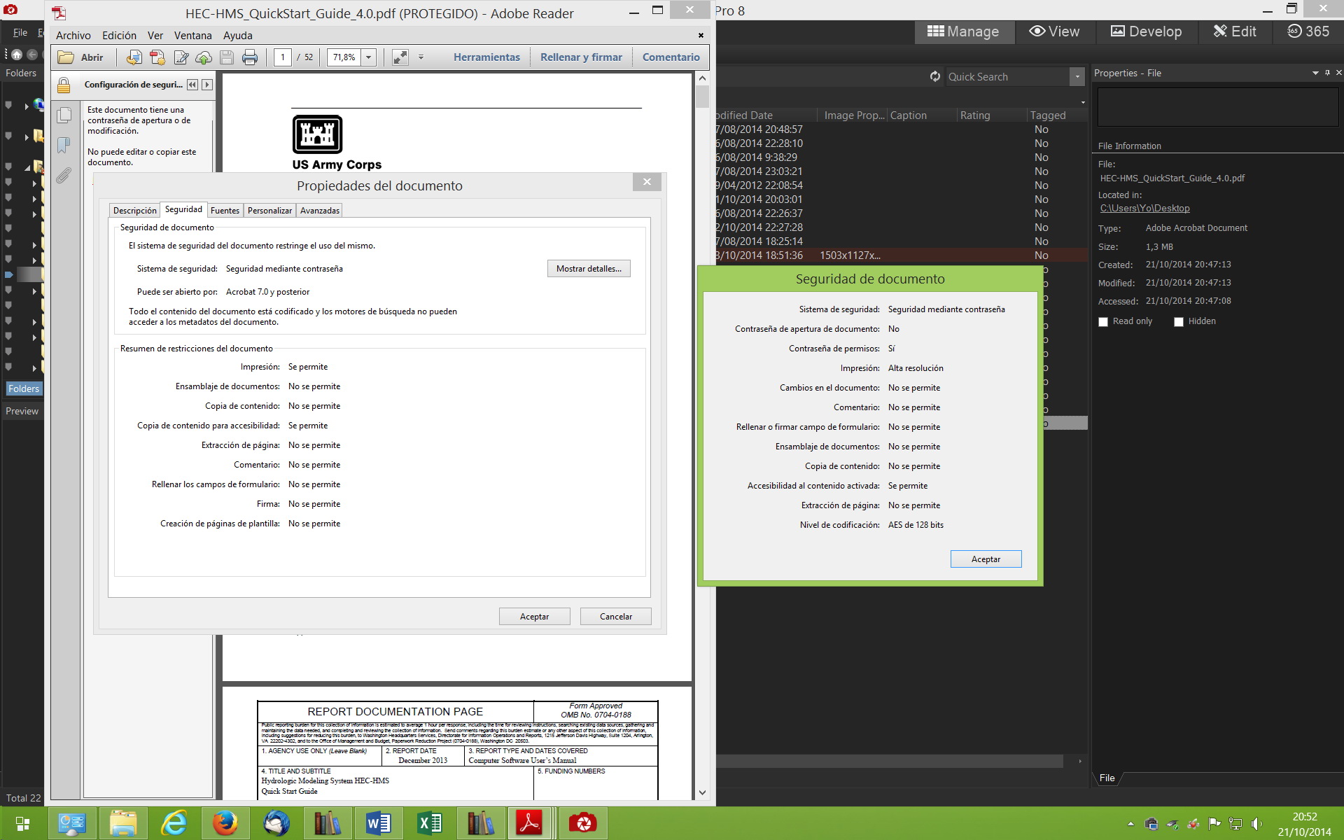

Nope, the password protection at least in 7.0 flavour doesn't seem to be the culprit to either problems:
This pdf:
http://www.hec.usace.army.mil/softwa..._Guide_4.0.pdf
which has this protection settings (look at the screenshot), works perfectly fine.
Name:	HEC HMS Quick Guide (Acrobat 7.0 or later).jpg

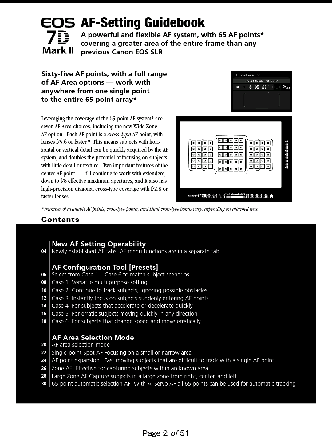

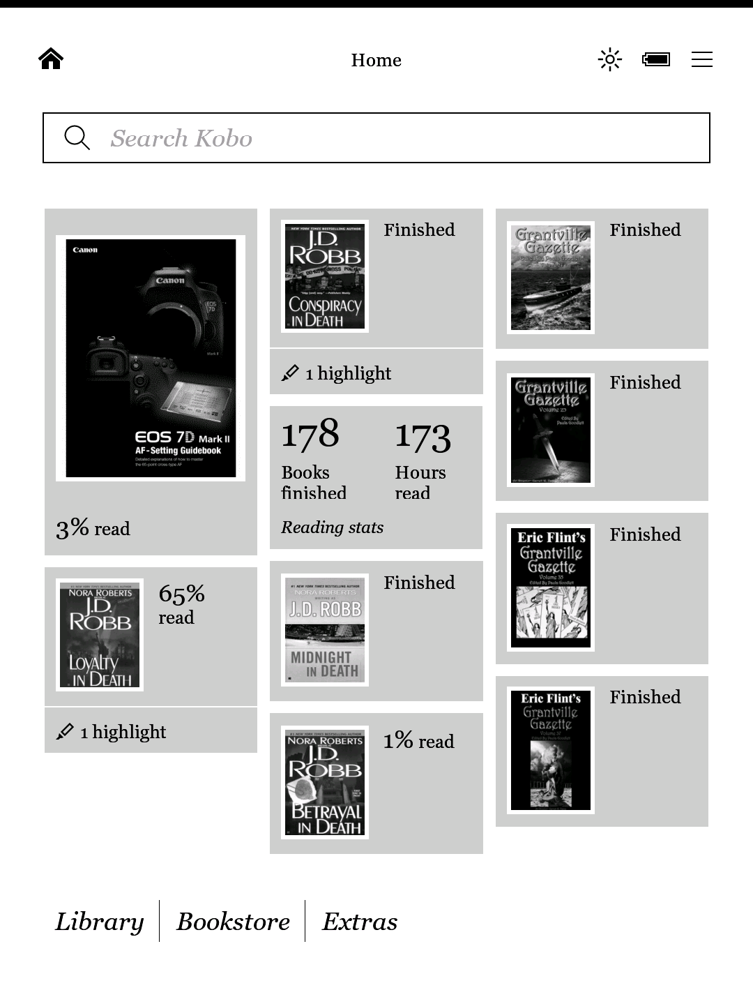

I was looking at the Canon manual and tried the experiment of printing it to a print to PDF file utility. The file that was created had a couple of the restrictions removed and stated it could be opened with any version of Acrobat. Copied the file to my Kobo H2O and it opened happily, page turn times were in the 2 second range. The home page even showed the first page as the cover in contrast to the original which showed a blank page.
ID:	131186   Click image for larger version
ID:	131187   Click image for larger version
Yes, that's what I expected. My wild guess about the crash issue is that the culprit is the AES 256bit protection. But in fact I don't know what the hell it is. The pdf is protected against certain features (even with a "password") but at the same time you can freely render it...
I've never been able to understand how this kind of protections CAN work... If I can access the content then I can access the content, how can you prevent me about doing whatever I want with it? And if it is encrypted and I cannot access it, then I cannot access it, so how can I render and display it?
Nevertheless, it would be great if someone with full fledged Acrobat could generate a sample pdf enabling this feature...
I don't think it has to do with the AES protection. I used Acrobat XI to generate a PDF openable with Acrobat 3 or higher and it worked. Used the same input file and set the output for Acrobat Level 8/PDF 1.7 (Acrobat X or higher) and it rebooted my Kobo. The stack error log looked the same as the one from opening the original Canon manual.
As for the value of the restriction flags, there aren't that many bits of software that can be used to edit PDF files so most people are using Adobe's Acrobat which does respect the restrictions.
At work, we do generate quite a few PDF's that are flagged as not printable by Adobe's or compatible software and others that allow form filling.
A PDF file can have two passwords set, one is the owner password which is used to enable/disable restrictions, the other is an user password which is needed to open the file for any purpose. Then you can get into the PDF compatibility settings in Acrobat -- I tend to prefer Acrobat 6 (PDF 1.5) just to make the file readable on as many systems as possible while keeping some advanced features.
