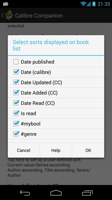

I ended up doing it on a sort-by-sort basis.

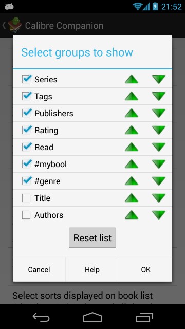

Also, I have added changing the order in the grouping drawer and the sort menu.
ID:	126801   Click image for larger version
