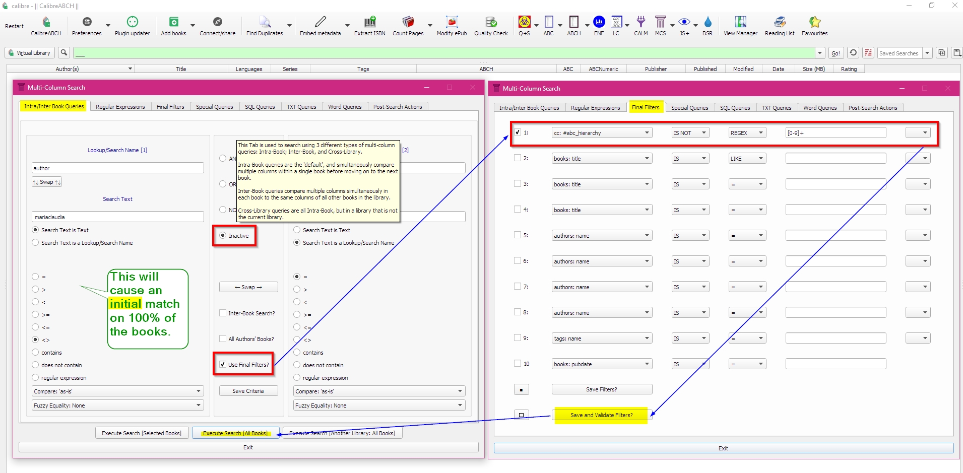

Use my Multi-Column Search plug-in to find the incorrect books. See the attached image for settings that will get all of the incorrect books that have a single author for sure, and perhaps some of those with multiple authors too.
DaltonST

In the first tab on the top right side, the 2 fields say "ERROR: UNSUPPORTED COLUMN NAME". That is the error. It cannot be invalid, even if it is inactive. Put "author" or "title" or any valid column name in both of those fields.
Also, ensure you are on the latest version of MCS, which is 1.0.64.

Also, the Final Filter REGEX value should have [ ] not ( ).
It should be: [0-9]+
That caused a REGEX compile error, resulting in the error message you got.
