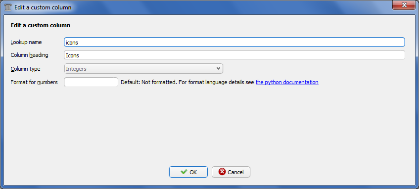

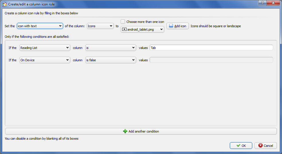

I don't know if this is done correctly, but this is what I have done:
First, the custom column and then the column icons ... it still doesn't show up.
I have also attached the icon.
Name:	Screenshot 2014-05-19 14.55.05.png
ID:	123137   Click image for larger version
Name:	Screenshot 2014-05-19 14.55.25.png
Can you see the Icon column?
Do you have more than one reading list column? What happens if you search for #reading_list:Tab, assuming that the lookup name of the column is #reading_list.
Is your device connected? The value of "on device" isn't known unless a device is connected? What happens if you remove the on device condition?
Yes, I can see the icon column, shouldn't the icon show up when I add the story to the reading list named Tab?
Your conditions say [("Reading List" is (equals) "Tab") and ("On Device" is False)]. If your device is not connected then the value of On Device is unknown. You haven't provided an example of what "Reading List" contains, so I can't comment on whether or not "Tab" is correct.

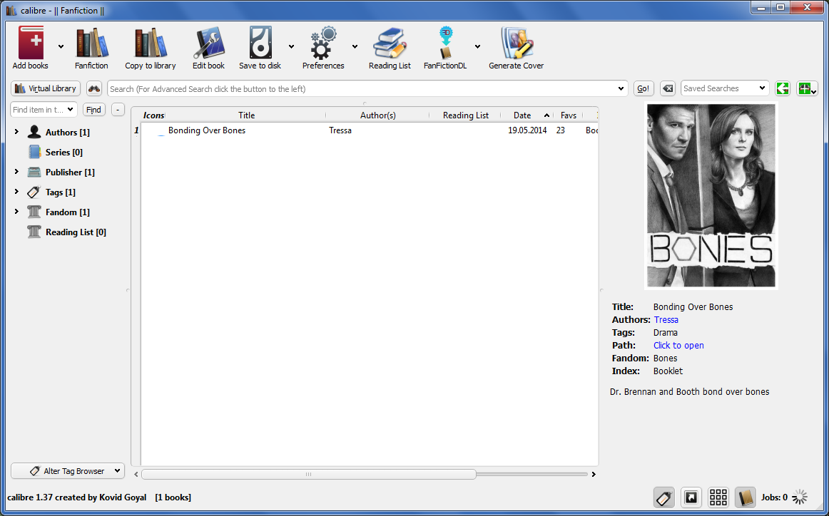

Post a screen capture of the library window showing both the Icon and Reading List columns.
Old 05-19-2014, 11:40 AM   #43
Tanjamuse
Posts: 1,327
Karma: 5306
Join Date: Jan 2014
Is this what you wanted?
Name:	Screenshot 2014-05-19 16.39.28.png
Old 05-19-2014, 11:46 AM   #44
chaley
Posts: 12,529
Karma: 8125420
Location: Notts, England
Yes.
In that example the "Reading List" column is empty (not equal to Tab), so it is normal that there is no icon. The conditions are not met.
Do you think that book is on the Tab reading list? If so, then post a capture of the Reading List options screen showing the definition of the Tab reading list.
