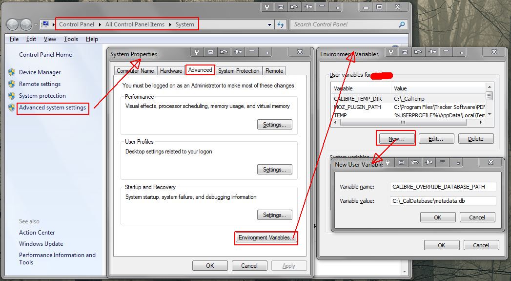

Calibre has an environment variable for redirecting the location of metadata.db - CALIBRE_OVERRIDE_DATABASE_PATH. Maybe using it to separate the db and the books onto different drives might shed some light.

Just in case... How do i set the CALIBRE_OVERRIDE_DATABASE_PATH?

I'll put together some screen shots for setting that Environment variable. Because that's what I'm going to suggest you do if calibre doesn't fly on the external USB3 drive.

@z.nina - here's what you you need to do to use that environment variable
  1. Close calibre down.
  2. Create a top level folder on your C: (system) drive called _CalDatabase
  3. Copy the metadata.db file from your library folder into that folder
  4. Rename the metadata.db file in your library folder to save_metadata.db
  5. Now refer to the attached image, I'm hoping its self explanatory
  6. Start calibre and do some Metadata Editing.
I have no expectation as whether this will change anything. If it does change for the better then the best people to comment would be chaley and/or Kovid, if it doesn't then we're probably back to that 2nd drive.
To undo the above - close calibre, remove the environment variable, remove the _CalDatabase folder, and rename the save_metadata.db file in your library folder back to metadata.db
Tip : to get the path to the metadata.db file into the Variable value
  • shift right click the file,
  • select Copy as Path (to the clipboard),
  • now you can paste the clipboard, should be C:\_CalDatabase\metadata.db
NB: I always start any top level folders I create on my system drive with an underscore '_'.
I do this to ensure that they're separated from the folders that Windows etc create.
