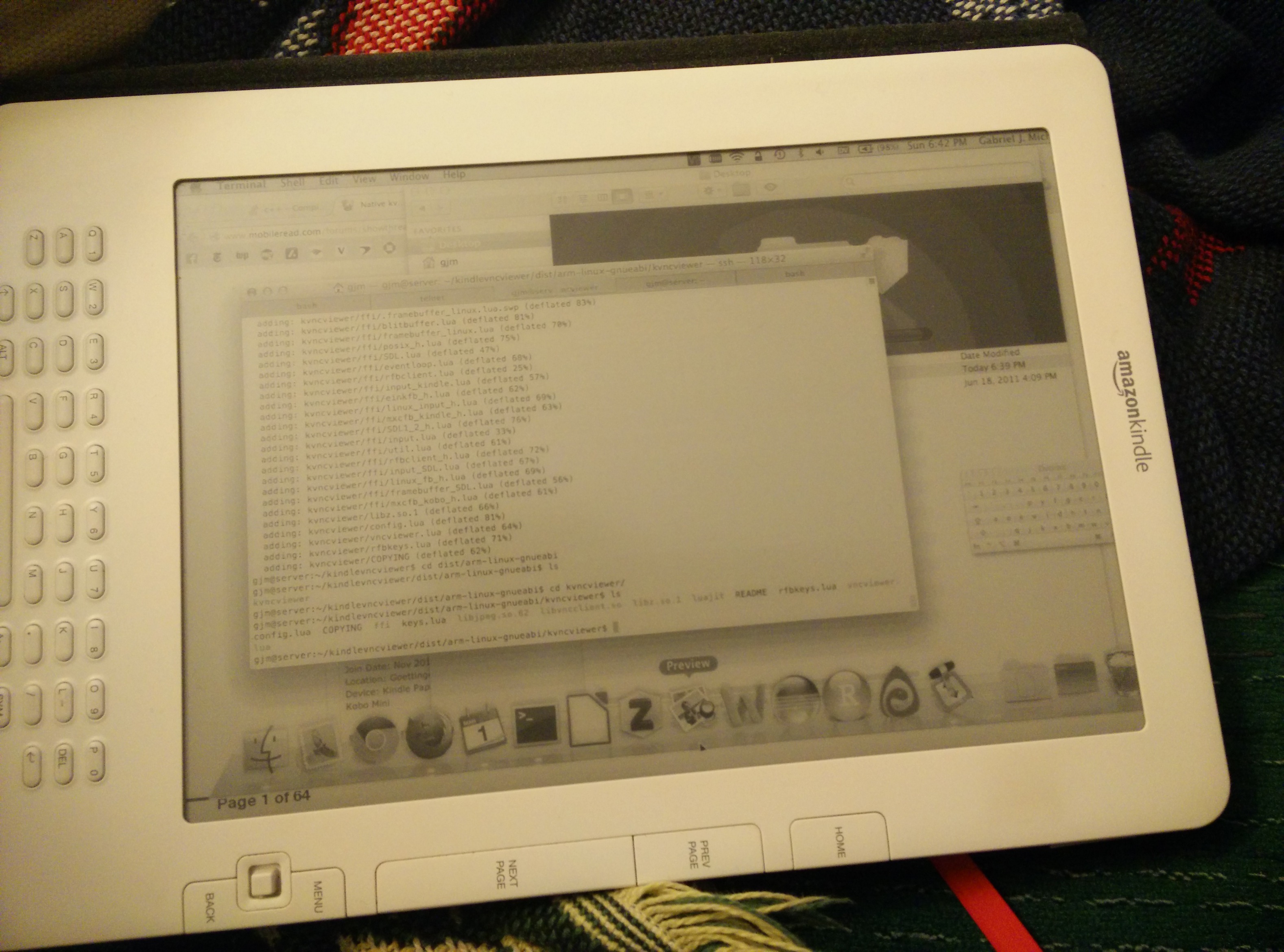

Same bug, happy to test future versions, will look at github, too

Just wanted to chime in here with some info: first off, I get the same bug:
[root@kindle kvncviewer]# ./luajit vncviewer.lua -password ***** 192.168.3.1:5900
could not open input device /dev/input/event2 (possibly harmless)
01/03/2015 11:41:15 VNC server supports protocol version 4.1 (viewer 3.8)
01/03/2015 11:41:15 We have 1 security types to read
01/03/2015 11:41:15 0) Received security type 2
01/03/2015 11:41:15 Selecting security type 2 (0/1 in the list)
01/03/2015 11:41:15 Selected Security Scheme 2
01/03/2015 11:41:15 VNC authentication succeeded
01/03/2015 11:41:15 Desktop name "computer-2"
01/03/2015 11:41:15 Connected to VNC server, using protocol version 3.8
01/03/2015 11:41:15 VNC server default format:
01/03/2015 11:41:15   32 bits per pixel.
01/03/2015 11:41:15   Least significant byte first in each pixel.
01/03/2015 11:41:15   TRUE colour: max red 255 green 255 blue 255, shift red 16 green 8 blue 0
./luajit: ./ffi/framebuffer_linux.lua:27: attempt to call global 'ioctl' (a nil value)
stack traceback:
        ./ffi/framebuffer_linux.lua:27: in function 'einkUpdateFunc'
        ./ffi/framebuffer_linux.lua:265: in function 'refresh'
        vncviewer.lua:99: in function 'cb'
        ./ffi/eventloop.lua:188: in function 'loop'
        ./ffi/input_kindle.lua:42: in function 'waitForEvent'
        vncviewer.lua:315: in main chunk
        [C]: at 0x0000c368
Also, I had to remount the root file system without the noexec option, which was preventing me from running luajit in the first place.
And, as you can see above, I had to specify port 5900. I am running RealVNC server on a Mac.

Have it working, in principle
That should be (should have been) handled by the jailbreak installation.
Re-install your jailbreak using the most recent JB release (and do a full re-boot afterward, if the JB installation doesn't do that for you).
Thanks, will try that. FWIW my telnet session also always drops after a few minutes. I have not really bothered with any of this for a year, but my wife was away this week and took our external monitor, which gave me the impetus to try again.
Made a few changes to the code, recompiled, and I now have it working on my Kindle DX. I have attached the zipped binary package, as well as a screenshot in action.
hawhill, I have submitted a pull request with the changes to you on GitHub.
