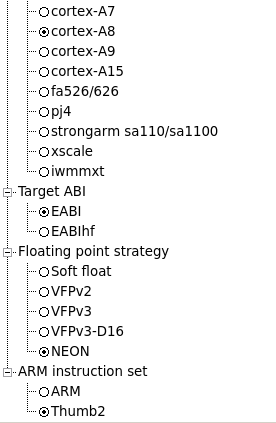

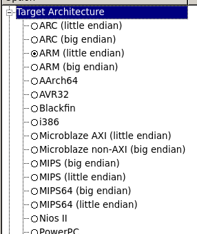

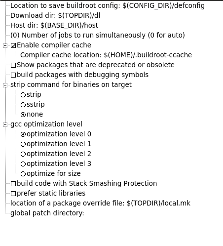

yup. What knc1 said. I just bumped a post for you about swappage (with the amend of how I run it) - NOTE: I dont care if I destroy a kindle or two in the name of progress... You might.
Also: buildrooting a kindle 3 kernel has the vast majority of the options you need on it.
Just swap arm1136jf_s for CortexA8
THumb 2
hmmmm.. gimme sec EDIT: okay that should get you going
Niluje knows this stuff inside out but that is the thrust of it.
(and knc1)

Yep, for the K4/K5/PW: ARCH: arm 32bit, le; CPU: cortex-a8; FPU: neon; FPU ABI: softfp; Instruction Set: Thumb2
Unless you are about accurate backtraces, you can safely bump the GCC optimization level to -O2 .
