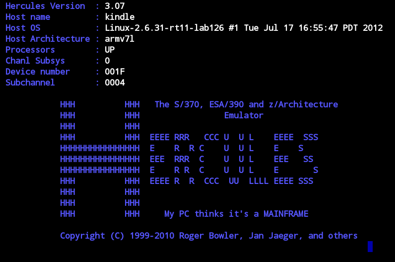

So... I'll make some more buttons.
START Mainframe (Background)
STOP Mainframe
START Op Console
HHCTE009I Client 127.0.0.1 connected to 3270 device 0:001F
Manual page for c3270

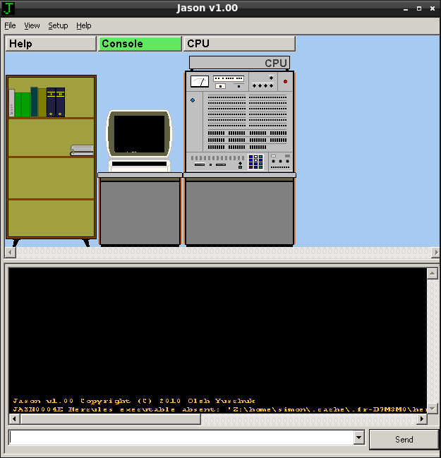

Perhaps I may look at porting JASON one day in the dim and distant...
http://www.ollydbg.de/Jason/index.htm

K5/370 - Day two
The image attached to:
https://www.mobileread.com/forums/sho...5&postcount=36
shows our very basic setup, the cpu with its hardware console, one 3270 Master operator's console and a bookshelf of reference manuals.
That nice "firm wood" bookcase is being emulated by documents posted on the Internet.
Referencing the image attached to:
https://www.mobileread.com/forums/sho...4&postcount=12
shows the system that we would like to install on the K5 devices.
After purchasing the optional, extra cost, swivel chair, the sysop would roll up to the cpu hardware console;
Open the access door in the pedestal, insert the 8 inch floppy disk, and start the micro-code upload to the main cpu.
With the current (day 1) version of this project, our K5/370 version of that is shown in the images attached to:
https://www.mobileread.com/forums/sho...73&postcount=2
https://www.mobileread.com/forums/sho...5&postcount=22
which show the "micro-code load and start-up" at the cpu's hardware console.
The pictured IBM/370 system used (a lot) of special cabling between devices.
The K5/370 system uses TCP/IP networking in replacement for the physical cabling.
In the IBM/370 system, the Master operator's console would have been physically cabled before anything was powered on.
But in the K5/370 system, we have to 'attach by networking' the Master operator's console to the cpu hardware.
https://www.mobileread.com/forums/sho...0&postcount=34
Shows our Master operator's console powered up and attached to the cpu hardware.
The Hercules emulator has a configuration file which is the details of all the equipment that is part of our K5/370.

In system K5/370, we **JUST** have to drop the image files into an appropriate place in the USB storage area and then in the Hercules configure file define which files are what hardware devices.
The first (system bootstrap) was typically device 150 (or there abouts).
To IPL (Initial Program Load) the system, all that would be needed would be to issue (from the hardware console) a "reset and start" command sequence to device 140.
For a disk drive, this would start reading the platter at track 0, head 0, sector 0. Whatever was there, was what you where about to run, like it or not.
These systems could also be IPL'd from the magnetic tape drive, paper tape drive, punched card reader, grandma's flower pot, etc.
Anything with a device address.
But the 'Initial' program we want to load is VM/370 (the 'virtualbox' system of the mainframe world).
And that resides on (in) disk image files.
Notes:
VM/370 will also run on a K5/390 (or IBM/390) but the Kindles are a single core ARM processor.
There is no reason (at the moment) to be using it to emulate anything more advanced than a K5/370.
The public domain compilers are all IBM/360 (and VM/370 will run system 360 code) so the first shipped system will be K5/370.
Which starts Day-2 of the project.
Tweaking the config file (a whole lot).

At the Hercules hardware console, first shutdown VM/370 by entering at the prompt:
/shutdown
And then shutdown the Hercules emulator itself by entering at the prompt:
quit
This VM/370 configuration file has the loading of the MVS-3.8 operating system as the 'first' guest OS commented out.
I think I will try running that (MVS) under VM/370
Hey, if a person is certain to drown, they might as well jump into the deep end of the pool.
PS: It would probably be more practical on a Kindle to run MVS-3.8 on the bare K5/390 hardware (64Mbyte of ram in the K5/390 rather than the maximum of 16Mbyte of ram in the K5/370).
Plus = all of those cpu cycles saved by not running VM/370 just to host a single operating system.
PPS: The emulator reported that it had execute about 58 million instructions to IPL VM/370.
But those comment characters are there to be removed, so . . . .

K5/370 - Day three
The VM/370 configuration file has the loading of the MVS-3.8 operating system as the 'first' guest OS commented out.
Plus - all of those cpu cycles saved by not running VM/370 just to host a single operating system.
Well, 'day two' has slopped over into 'day three' here.
Got a bit sidetracked with the KUAL/1130 -
Which could use some polish, but will leave that to Pop (someone who knows something about the machine and software).
So, getting back on the horse that threw me yesterday . . .
And while twobob recovers from the poor dithering of Win-95 running on a Kindle . . .
Will do some more of Hercules configuration files, see if I can get MVS release 3.8j up and running.
Note: Release 3.8j is the last public domain release of the operating system, but it is not dead, not even now.
Its new name is z/OS and our K5/390 **should** run it, if you have it and have a license to use it.
I did a google search for something on this subject yesterday and in the list of 'related images' found my avatar as #3 in the sample display.
