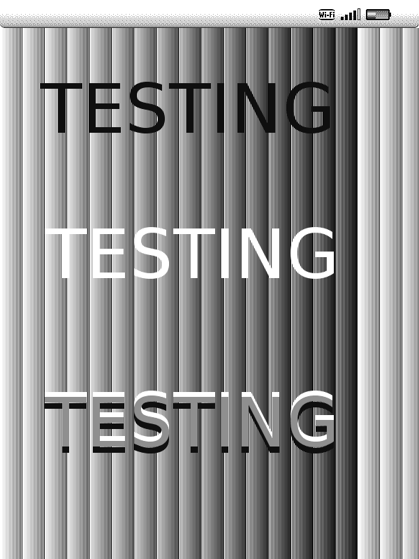

Something like:
PHP Code:
showlog -f | awk '!/home/ && /booklet.reader/' |  awk '/SENT/{print $0}' | \
while
read MYVAR; do  echo "$MYVAR" | \
awk '/PAUSE/{system("./showtime-restore.sh")}' \
&& echo
"$MYVAR" | \
awk '/GO/{system("./showtime-header.sh")}'; done
with:showtime-header.sh
PHP Code:
#!/bin/bash
LD_LIBRARY_PATH="../lib:$LD_LIBRARY_PATH"
export i=`xwininfo -tree -root | awk '/titleBar/{print $1}'`
xdotool windowreparent $i `xwininfo -tree -root | awk '!/footerBar/ && /booklet.reader/{print $1} |head -n1'`
and:showtime-restore.sh
PHP Code:
export i=`xwininfo -tree -root | \
xdotool windowreparent $i 0x51
dynamically sticks the top status bar over the book while reading.
Possible to resize it a tiny bit smaller / move it around/ via xdotool.

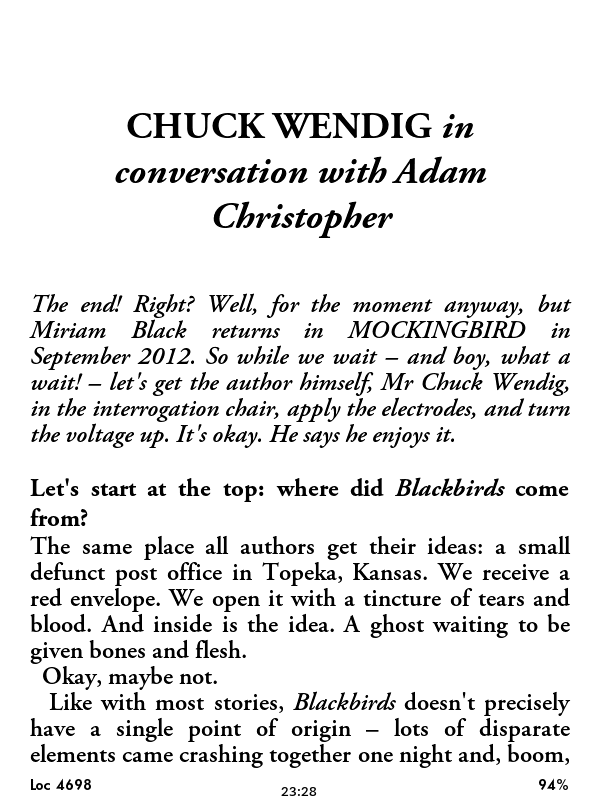

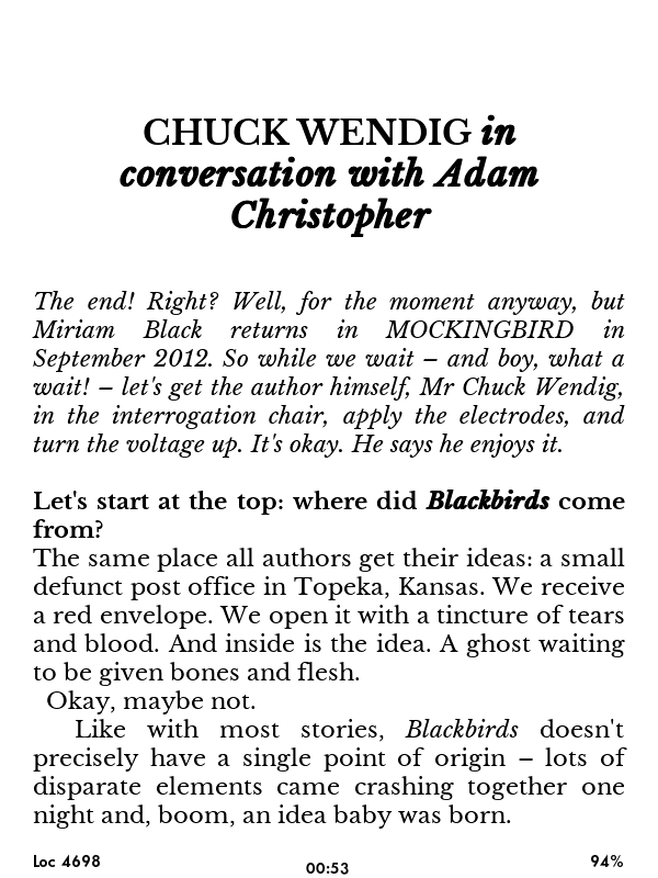

Okay, got a crappy POC working (thanks to FBGrab & IM).
I'm thinking wrap that in a forever loop, and each 30s check if the time changed, and when it does:
Snapshot of the current page:
Composite a clock on it (default @ bottom, tweak the size per-device, cf. my BatteryStatus KUAL extension for the screen size detection code):
/mnt/us/linkss/bin/convert page.png -gravity south -compose src-over -background "#0000" -fill black -font "/usr/java/lib/fonts/Caecilia_LT_75_Bold.ttf" -gravity south -size "600x20" caption:"$(date +%H:%M)" -composite -quality 75 -define png:bit-dept
Print composite page w/o flashing:
Maaagic!
(Also, cleanup behind us, and write all that crap in a tmpfs, not the flash).
It's crappy because both fbgrab & IM are very CPU-hungry (i.e. the whole process takes between 1~2s @ 100% CPU on a Touch), and the design around a forever loop isn't terribly pretty (but I like the 'check if the time has changed every n seconds' better than a costly & ugly parsing of the logs to detect page changes, and it should be more transparent to the user, since it would then mostly avoid happening during an already CPU-hungry operation [page change] [EDIT: Err, okay, obvious downside: it disappears when you turn the page until the time change]).
Going with a lower PNG compression level (both for FBGrab & IM) would probably speed things up a bit, at the expense of bigger files, which might be something to investigate, since this is only intended for very short-term storage.
For now, I'm leaving this out there, I don't really intend to make anything end-user friendly with this, just throwing ideas around .
Especially since both the real toolbar, or aosd or a proper overlay like the LUA idea would be much, much better .
EDIT: For an idea of what the (mostly randomly chosen) size mentioned gives:
EDIT²: And with Futura-DemiBold instead, to match the font used by the framework on a K5 (don't mind the crappy fake BoldOblique of Libre Baskerville).
EDIT³: We could nearly do it without file I/O, if only eips could handle input from stdin...
./fbgrab -z 0 - | /mnt/us/linkss/bin/convert PNG:- -gravity south -compose src-over -background "#0000" -fill black -font "/usr/java/lib/fonts/Caecilia_LT_75_Bold.ttf" -gravity south -size "600x20" caption:"$(date +%H:%M)" -composite -quality 00 -defi
ne png:bit-depth=8 PNG:- | eips -g -
eips: paint_image> cannot open "-":can't fopen
ID:	124412   Click image for larger version

#! /bin/sh
# $Id$
# Fugly POC
# Be nice!
renice -n 10 $$
# Do some minimal device checks...
# Use Futura if it exists
if [ -f "/usr/java/lib/fonts/Futura-DemiBold.ttf" ] ; then
	CLOCK_FONT="/usr/java/lib/fonts/Futura-DemiBold.ttf"
else
	# Barring that, go with Caecilia, because Helvetica is friggin awful.
	CLOCK_FONT="/usr/java/lib/fonts/Caecilia_LT_75_Bold.ttf"
fi
# Detect the correct screen size... (Adapted from the logic in BatteryStatus)
kmodel="$(cut -c3-4 /proc/usid)"
case "${kmodel}" in
	"24" | "1B" | "1D" | "1F" | "1C" | "20" | "D4" | "5A" | "D5" | "D6" | "D7" | "D8" | "F2" )
		# PaperWhite...
		SCREEN_X_RES=758
		SCREEN_Y_RES=1024
		# Handle legacy devices...
		if [ -f "/etc/rc.d/functions" ] && grep "EIPS" "/etc/rc.d/functions" > /dev/null 2>&1 ; then
			. /etc/rc.d/functions
		else
			# Touch
			SCREEN_X_RES=600	# _v_width @ upstart/functions
			SCREEN_Y_RES=800	# _v_height @ upstart/functions
		fi
esac
# NOTE: Mostly randomly chosen, tweak me if needed
case "${SCREEN_Y_RES}" in
	"800" )
		CLOCK_SIZE="${SCREEN_X_RES}x20"
	"1200" )
		# FIXME: Can't remember if /etc/rc.d/functions is actually accurate on DX/DXG, or if we need to fake it ourselves
		CLOCK_SIZE="${SCREEN_X_RES}x30"
	"758" )
		CLOCK_SIZE="${SCREEN_X_RES}x26"
esac
# And the actual work...
clock_watch()
	LAST_TIME="13:37"
	# Let's loop!
	while : ; do
		# Check the time...
		CURRENT_TIME="$(date +%H:%M)"
		if [ "${CURRENT_TIME}" != "${LAST_TIME}" ] ; then
			# It changed, draw the clock!
			LAST_TIME="${CURRENT_TIME}"
			# Start by building a composite of the current screen w/ a clock at the bottom (Kill the undercolor if annoying. Useful when the time changes on the same page).
			/mnt/us/usbnet/bin/fbgrab -z 0 - 2>/dev/null | /mnt/us/linkss/bin/convert PNG:- -gravity south -compose src-over -background "#0000" -fill black -font "${CLOCK_FONT}" -undercolor white -gravity south -size "${CLOCK_SIZE}" caption:"${CURRENT_TIME}" -composite -quality 00 -define png:bit-depth=8 /var/tmp/clock.png
			# And then print it, without flashing
			eips -g /var/tmp/clock.png
			# And clean up behind us
			rm -f /var/tmp/clock.png
		fi
		# See you in thirty!
		sleep 30
	done
	return 0
# Sneakily launch the clock watch in the background
clock_watch &
echo "* Clock watch backgrounded w/ PID $!"
# See ya'
exit 0
Since I went all the way with IM, it's friggin' expensive, but hey, it works.
