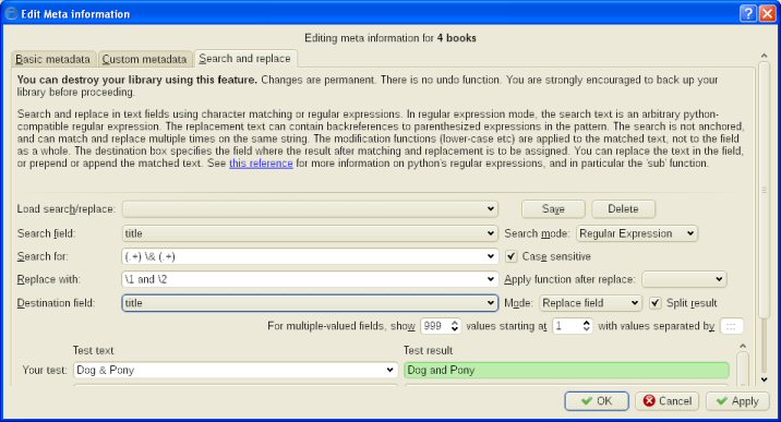

Originally Posted by Joan M View Post
But while you're around - I was going to do a global search for "&" and replace with "and" in the titles field and tried to figure out what you meant about using \& \ . Should I just ignore you and use "&"? Cause using \& \ sure didn't work. A little knowledge is a dangerous thing.
The second slash should not be there (see image for a working example)
not spaces and the mode REGEX on the right
As someone pointed You can only replace a & in a title,
Name:	amp to and.jpg
