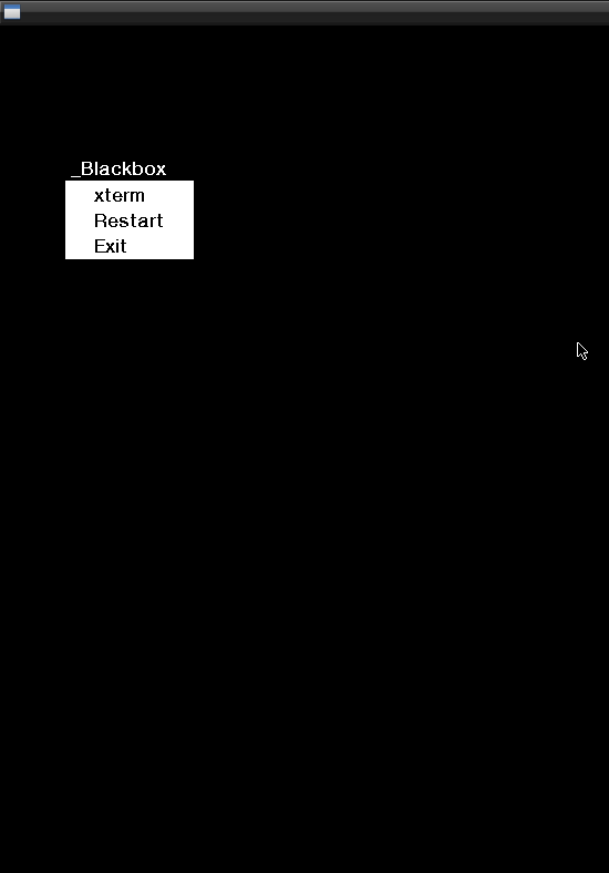

whilst I still haven't got the keyboard input working I dig manage to get the output back on the screen as you describe with no nibble errors via the 3 way linkup.
very nice actually. with just a little bit more work from the community this could be a solid little version of X. I actually think it does a very decent job. all things considered.
I didn't even stop the framework just to see how it would perform under load and abusive operation. ico happily shoved around the screen with surprising speed.
need a few more heavy duty apps x-compiled now for the 3. give it a real test. but yeah. great!

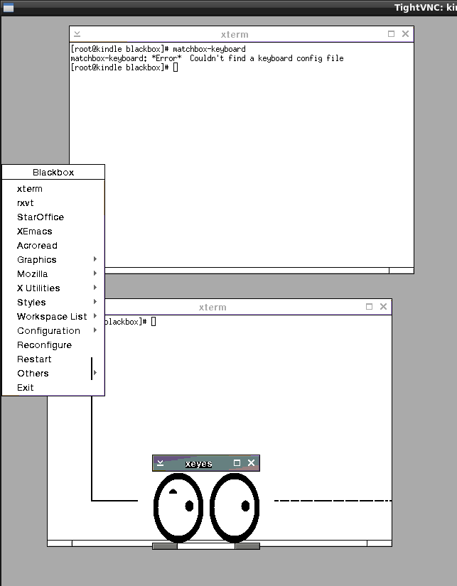

Okay so I got the keyboard input working. via the PC.
next up would be either implementing it via OTG USB or getting the onboard device working (preferable)
but seriously? This is genuine fun!
If you had said that my kindle 3 would be monitoring this screen in realtime and running blackbox WM with a smattering of X apps this time 3 months ago... well... I wouldn't have believed you.
Brilliant progress here. just got factor the PC out of the loop to get a genuinely shocking result.
: ) Thanks Hawhill. superstar
