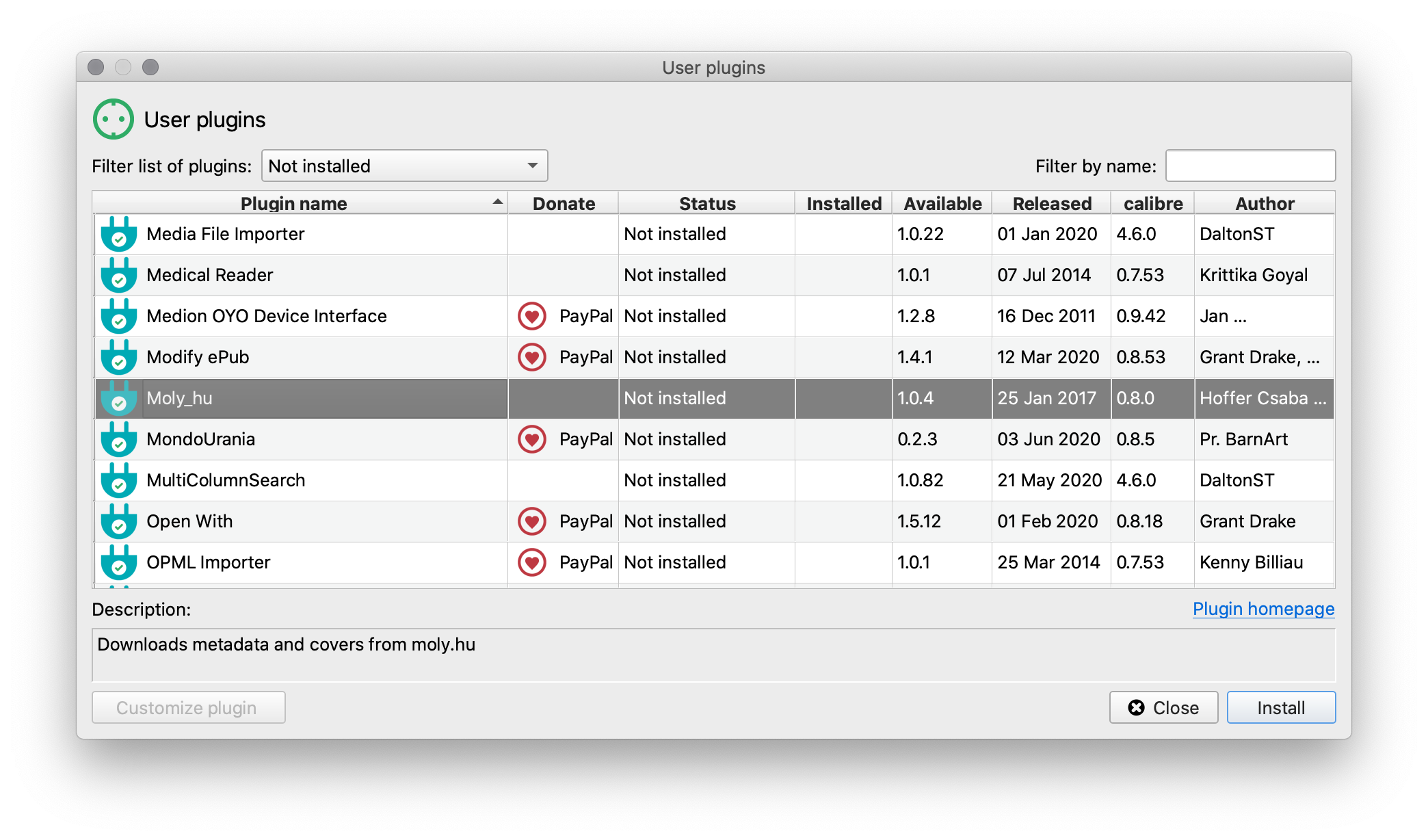

Not sure what is wrong on my systems but there is no version 1.1.4.
Name:	Screen Shot 2020-07-06 at 15.16.06.png

Ok, fixed by manual installation.
I've tried to update the various bits that need to be updated to make 1.1.4 available through the calibre interface.
