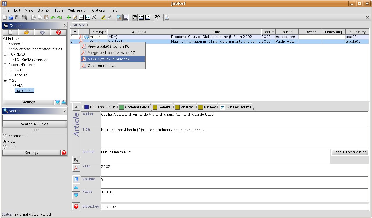

Well, I have this mostly working now. I can use jabref to manage my refs, I have a filter that makes it easy to create a manifest file that contains the author(s) in the title, paper title in the first line of the description and journal name and pages in the second line of the description so they look good and are easy to identify on the iliad.
I also have another export filter that creates symlinks, so I can select a group of refs, export to symlinks and move the symlinks to some work folder on the iliad. That way I can keep all my refs in one folder and have collections for particular projects in another that point to the original articles.
But when you have hundreds of articles and no bibliography manager on the iliad using the iliad search becomes a pain. So, I have installed samba as shown recently (thanks ajnorth!) on the iliad and access it from my PCs. I have setup some scripts and registered these as external file handlers in jabref (this is much simpler than it might sound, it's like setting up file associations in Windows 98 or something) and the scripts themselves are quite simple. I then network my PC to my iliad and setup an article entry to do different things depending on which option is chosen. The choices are:
i) open and view the PDF on the PC
ii) Merge the PDF and scribbles and view on the PC
iii) Make a symlink in an easily accessible folder on the iliad so I don't have to search for it
iv) open the PDF directly on the iliad (via ssh)
(The last option works in that it opens the PDF and was what I was after in the first place, but I have trouble closing it afterwards and might have to give up on this approach.)
Here's a screenshot showing the choices. I might even try to make a video and put it on youtube if people are interested and if I can figure out how to do it (never tried youtube before).

Try registering this attached file as an export filter. Using this to export refs will produce a bash script that will create each manifest file. So, if you make the default extension for this filter to be .sh, and then you select a load of refs and export them using this filter and save it as myrefs.sh you can do:
sh myrefs.sh
to create all the manifest files in the current directory.

Agreed. And it would need to be fast otherwise I think it would interrupt my flow too much. I'm not sure that things refreshes will get too much faster with the current hardware, unless it really is a software issue. I have startd using ssh to login to and poke around the iliad and was surprised how fast it was. I now have a feel for the lag caused by the E-ink.
So, for now, I am focussing on making a PC-based bib manager work *with* the iliad rather than *on* the iliad.
BTW, I made a terrible movie on youtube showing the integrated iliad and jabref-on-PC. It's so bad I'll have to explain what I am doing:
SETUP:
i) PDFs are on the iliad (in fact on the USB in the iliad)
ii) jabref is running on the PC
iii) I have the USB shared using samba (i.e. a windows share)
iv) I have custom file handlers
MOVIE:
i) I select a ref, then right-click to open it on the PC for viewing
ii) I then merge scribbles and open it on the PC for viewing
iii) I then show that there is nothing in the "readnow" directory on the iliad
iv) Next I choose the "make symlink in readnow" menu option in jabref
v) then I show that there is now a link in readnow and open the PDF on the iliad.
vi) I fumble around trying to get the pen out then write "Hi" on the the screen
vii) I go back to the PC and merge and view again and show that "Hi" is now there.
http://www.youtube.com/watch?v=GM-34CA6Cg4
