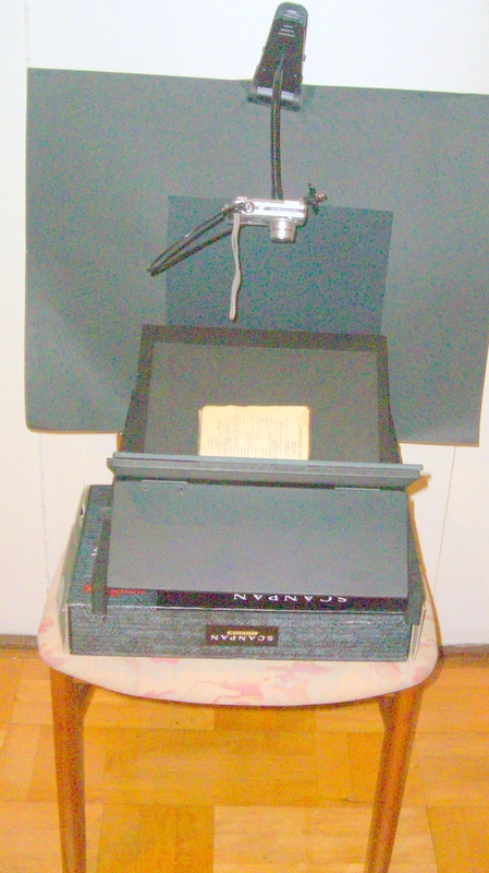

Summary of some points
Yes, this thread is kind of a tutorial, but nevertheless it is nice to get a feedback from the readers. So here is summary of some points.
1. Scanner vs. digital camera
Scanner is ok for single page documents, and a scanner with a feeder is very good for a pile of single sheet documents. Scanners can also be used for scanning your old photos to digital form. They do not require any lighting arrangements and take care of the white balance (usually produce white background as white - but not always). However, getting the right colors with a scanner requires as much care and processing as with a digital camera. You can learn a lot about scanning from the author of Scanview and the links on his pages: http://www.hamrick.com/vsm.html
I have a HP scanner on my desk that I don't use anymore (I dont't use a photocopier anymore either). The main reason is that the scanner is very slow in color mode. The mono mode is faster but still too slow for me. The other reason is that you cannot spread flat a book in the scanner even if you use a heavy weight on the scanner's cover. If a book page is not flat, the lines of text will be curved, and OCR will be unreliable.
Sometimes (e.g. for professional printing) you may need a scanner resolution of 1200 dpi or more. Few (very expensive) digital cameras can match that resolution for A4 pages today.
2. Digital cameras
I started with a 1.2 Mpixel digital camera only five years ago. Totally useless. (Even before that I had an opportunity to casually talk about the idea of using digital cameras as scanners with some high level HP executives. They didn't "get the picture".)
My next camera was 5 Mpixel Canon PowerShot G5. Image sensor 1/1.8 inch CCD. Image size up to 2592 x 1944 pixels. Very good.
My current camera is 8 Mpixel CanonPowerShot Pro 1. Image Sensor 2/3 inch CCD. Image size up to 3264 x 2448 pixels. Canon does not want my money for the successor of Pro 1. Apparently it competes with high priced reflex cameras.

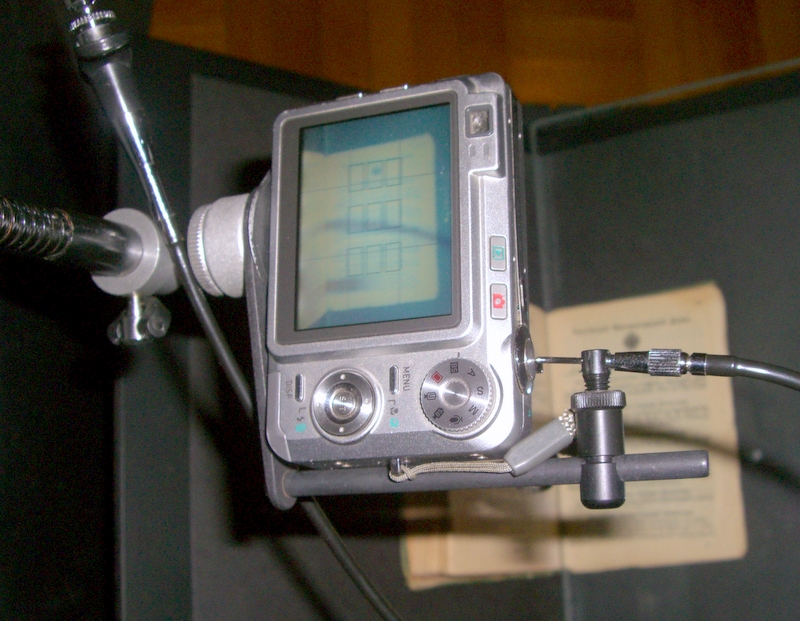

Most Canon cameras can be connected to a computer to shoot pictures (not just to download them). Most reviewers negelect this advantage and also do not understand the need for higher resolution and never refer to repro applications in their reviews. While 8 Mpixels are good enough for A4 pages (210x297 millimeters) and more than good (with zoom) for A5 pages (you can calculate the resulting resolution from image size and paper size), it would be good to have as high resolution as possible for A3 and even A2 pages. As a matter of fact with my Canon I can shoot a picture of a distant object over the heads of the crowd and read the text which I cannot see well with my eyes. It is also the only way to read small print instructions that come with some products (recently I used my camera LCD to read a serial number on my Archos 704 wifi). The higher resolution (in terms in Mpixels) cameras should come with larger sensors. Higher resolution with the same size sensor is sometimes a disadvantage for repro applications. A nice feature for repro applicatons would be the manual focus. It is very awkard in my Canon (requires three hands).
When shooting, always use a neutral mode (no color or contrast improvement in the camera - you can always improve it with proper software) and the lowest ISO possible at a given lighting condition. In my experience, it is better to underexpose than to overexpose. Always take care of proper focus. For all practical reasons, you cannot improve on that once the shot is taken.
As for cheaper compact cameras, it looks from the specification that 10 Mpixel Canon A640 or a succesor may be good for repro applications.
There are cameras available with a special text mode. It is just a selection of camera settings. Good for novices.
My other two cameras: 8 Mpixel Casio Ex-Z850 and 10 Mpixel Casio Ex-Z1000 provide the text mode. They have a very nice 9 point focusing screen. Since they use the same size sensor, the 8 Mpixel Casio is better for repro applications. It is more difficult to focus with the higher resolution Casio.
3. Lighting
With the v-cradle design use a bright light as high over the cradle as possible. A diffusor to dissipate lighting and make it more uniform is useful. A soft flash (possibly redirected against the ceiling) can be used for black and white pages. The most uniform lighting you can get is the sunlight outdoors, with the original paper document at a proper angle to the sun..
4. OCR
Abby Finereader 8 is a marvelous piece of software but sometimes it is vicious and puts strange and obscene words in the recognized text (it is just the way it interprets the picture). It is very risky to use the OCR-ed document without correcting the misspellings manually. I never waste time for correction since I produce the output as the picture-true pdf copy of the original with OCR-ed text layer underneath. In that way you can index and search the documents in your computer and always read and print a perfect copy of the original document.

pillows and ocr
A book pillow? Never heard of that. I can imagine a black soft pillow as a "cradle" for books but it would be a daunting task to keep the book pages at the same position for sequential shots. What about a glass to flatten the pages? Can you give more info on that?
As for OCR, you apparently use it for English texts which are so easy that Acrobat Capture (and even free ocr programs) may be ok. I ocr all kind of languages (even old Russian cyrilic) and books as old as 17th century. I tried Omnipage, Iris, Textbridge, an IBM program whose name I forgot, and any demo/evaluation I could find on the internet. There is no match to Finereader (they even offer a version for Gothic Fraktur and Old European Script but it is too expensive for personal use - apparently they sell it to libraries).
OCR is crucial if you search thousands of books for specific terms and purpose, like genealogical research. You just cannot read thousands of books page by page.

I am proud to see that both the velvet and the acrylic cradle can not match my design in terms of precision positioning and flexibility. You can add a soft padding to my v-cradle panels if you wish. With my new improvement (four regulated bolt legs) my v-cradle will allow to change horizontal and vertical angles to any precision required without touching the tripod. And it allows you to shoot very fast without adjusting the postion for every page. Instead of glass you can use your fingers or a clip or a transparent strap.
If I had a few thousand bucks to spend, I would buy an Atiz two camera v-cradle, but my design does the same (with less automation), with more precision and flexibility.

Anything similar to what is in your drawing will work. I tried before and suggested a number of substitutes in my previous posts. When I am in my office, I don't bother to go to a copier. I frequently shoot a paper document placed on a table over a black background, keeping a camera in my hand. As I have already mentioned, I run a paperless office. Fifty or so pages of documents that come to my desk every day can go to my camera and my computer in a matter of 15 minutes. Any distortions I can correct later with batch software processing, but I prefer to do the photos right from the very beginning with the v-cradle in my home studio).
For precise positioning and fast shooting of a book you need more than your design. When trying to aim and zoom your camera from a tripod you will learn how difficult it is to adjust the tripod angles precisely (in three dimensions). I did it once and I don't touch my tripod and camera anymore, I can just move my v-cradle forward and backward, left and right, up and down, change the angle of v-panels (in the next model, even precisely change the length of micrometer legs). Also remember that you need to obscure your camera behind a black curtain or a paperboard, otherwise the camera will be reflected in a glass or a glossy surface of the (color) paper document/book.

With 10 Mpixels camera you get over 300 dpi for A4 format, over 600 for A5, and over 1200 dpi for your collection of small print business cards.
Cost is minimal. Just a tripod and do-it-yourself v-cradle. Today, you need a digital camera anyway on all kind of occasions.
A v-shaped scanner plus automated turning of pages (mechanical or pneumatic) would be a breakthrough. HP already offers some see-through scanners, and that technology would be appropriate for the v-shaped design. I hope somebody from HP or their competitors will read this and make it work (you should better go to the Patent Office before them).
With all that, the v-cradle will be a choice for home and non-corporate users, and will help you copy even large size documents or newspaper pages without spending a lot of money.

For batch processing, I am posting some hints and problems in the pdflrf by cacapee thread in Content rather Accessories forum.
You do not need any calculations for angles, lighting, etc. You just shoot your photos and compare results.
My Canon Powershot 1 is today less than 500 USD (I guess), Canon A640 is even less. My two compact Casios are good enough as well, alas there is no way to connect them to a computer for shooting and they have no remote.
I have Bogen/Manfrotto copy stand at home away from where I am now, and I am going to use it instead of tripod with my v-cradle when I am back home.

If you don't have a tripod and a remote
Picture 1. A flexible cheap arm bought in a photo accessories shop, attached to a chair. I do not recommend that particular type of arm - it is neither flexible or stiff enough even for small cameras.
Picture 2. Details of a wired remote (again a computer accessories shop) attached to the camera.
Picture 3. Professional flexible arm by Manfrotto (it is for lighting support rather than a camera). It is very solid but costs a lot.
I tried all that some years ago, and I recommend buying a good tripod whith short legs (if you want to keep it on a table together with the cradle) instead.
