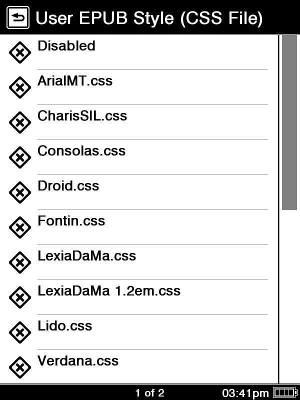

How are you changing the fonts, through PRS+ Settings, under Book Viewer Settings and then User EPUB Style (CSS File)? Or trying to change an individual epub by converting with custom css info?
For PRS+ custom files, my path for the css files is \database\system\PRSPlus\epub. The path for the font files is \fonts. A typical css file is below that changes the font only, no special spacing or anything else.
I'm using porkupan/boroda's firmware, which moves userStyle.css to the reader's data partition. I'm editing that file to tell the reader where to look for the default fonts.

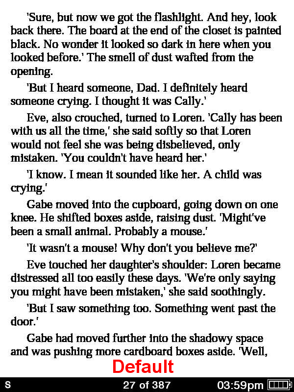

And both Arno and Palatino worked for me. I only used 4 from each font pack for normal and bold in regular and italic, and have screenshots of each plus default in small font. The font style differences are much more noticeable in medium font size though. The fonts I used were ARNOPRO-REGULAR.OTF, ARNOPRO-BOLD.OTF, ARNOPRO-ITALIC.OTF, ARNOPRO-BOLDITALIC.OTF, and PALATINOLTSTD-MEDIUM.OTF, PALATINOLTSTD-BOLD.OTF, PALATINOLTSTD-MEDIUMITALIC.OTF, PALATINOLTSTD-BOLDITALIC.OTF. I didn't rename them at all and they worked fine.
And I'll have to try adding !important to the css files and see if that really will overwrite those epubs that specify their own font. I always find those most annoying since I prefer LexiaDaMa still (including a sample of that font too just for comparison).
Edit: Btw, my reader viewing settings are at 127/-125, I didn't think to change that back to default before taking the screenshots, so they probably look more saturated than you're used to.

BTW, the fonts in the Arno and default screenshots you posted look identical to me, but Palatino is clearly different.
There is a difference in the Arno and default fonts. The default do not have true bold or true italics and while the bold is easy enough to simulate, the italic is not and doesn't look all that good. So Arno will have a proper italics.

You're right about Arno and Default after examining them closer and not between other fonts. I did more checking with the Sony default against Arno using the Windows font viewer for Arno, and while they do look pretty similar, there are certain letters, like the "j" that are distinctively different and it looks like the Arno font isn't loading for some reason. I tried renaming the files, using files from my Windows directory that I know work in applications on my PC, and couldn't get Arno to load on the reader for some reason. Really odd, never ran into that before.
