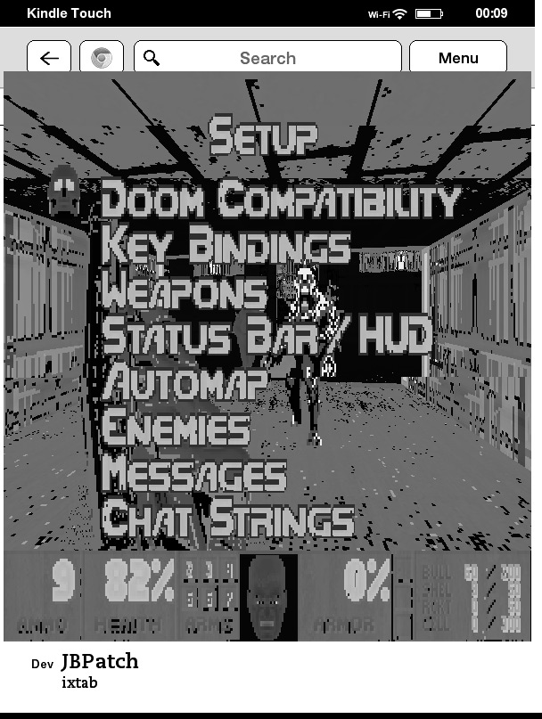

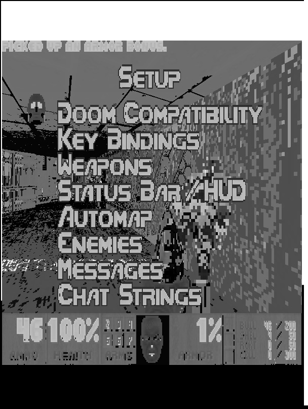

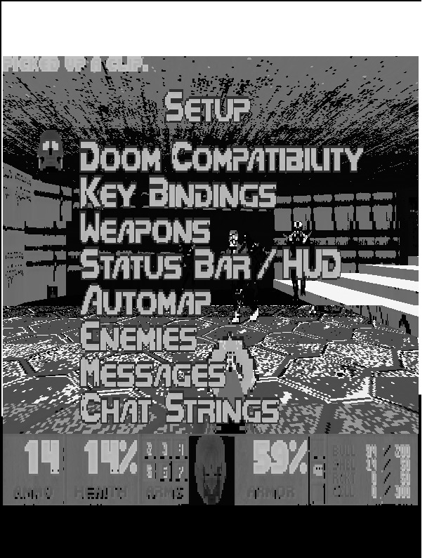

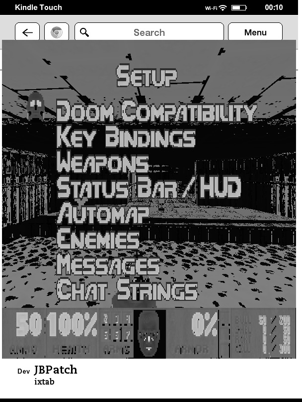

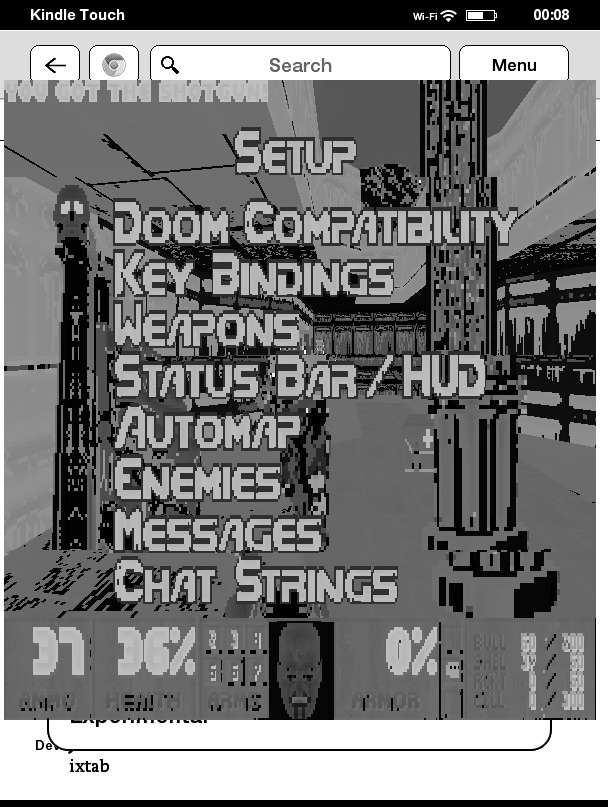

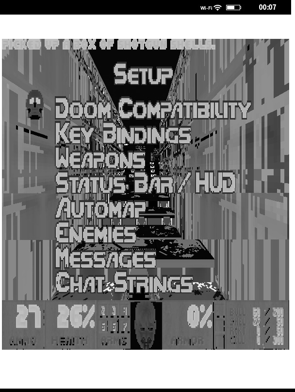

well this is true. and I have now CORRECTLY applied the JB (I double double double checked and have done both methods universal and simple.)
no dice. so new puzzle for me - so in the interim I will do a
dd if=/dev/fb0 of=/mnt/us/fb0.raw
and get a shot that way. until I decide on the 5's fate...
To wipe and get on with it? or keep the corner case alive. sigh. suppose I can fiddle with the xorg.conf in the interim and try to inject more calls into SDL (I'm still convinced!!! it's not flipping from code, I can actually get it to show the full game now)
SS to be enc next.

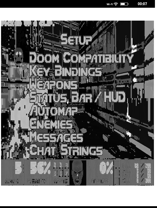

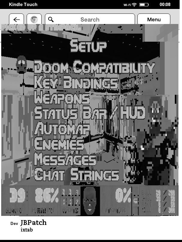

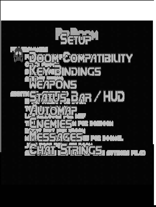

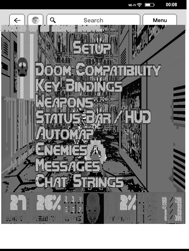

Old 09-27-2012, 08:16 PM   #43
twobob
( ͡° ͜ʖ ͡°){ʇlnɐɟ ƃǝs}Tır
twobob's Avatar
Posts: 6,586
Karma: 6299993
Join Date: Jun 2012

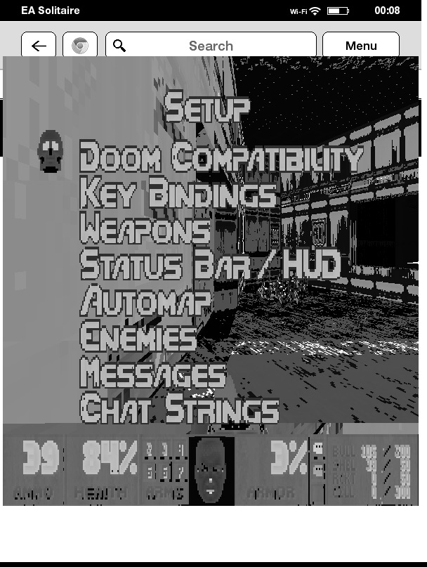

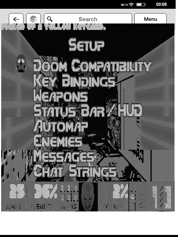

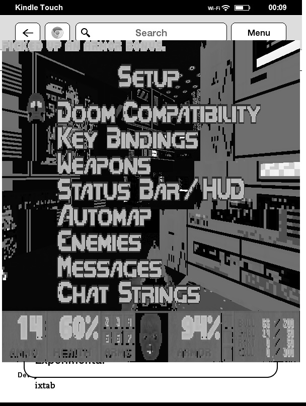

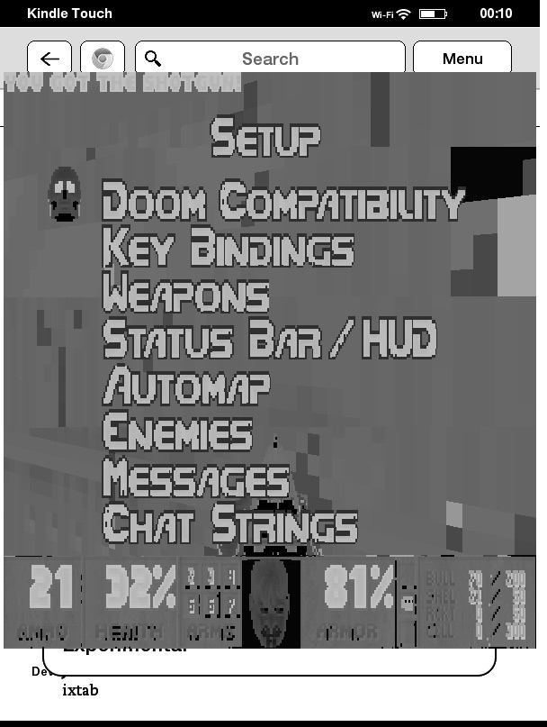

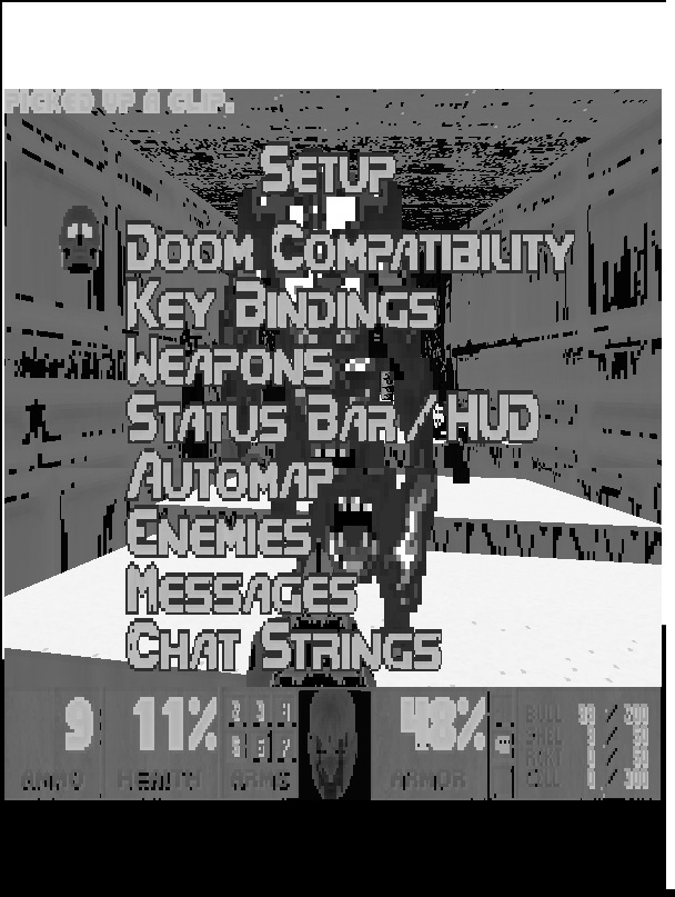

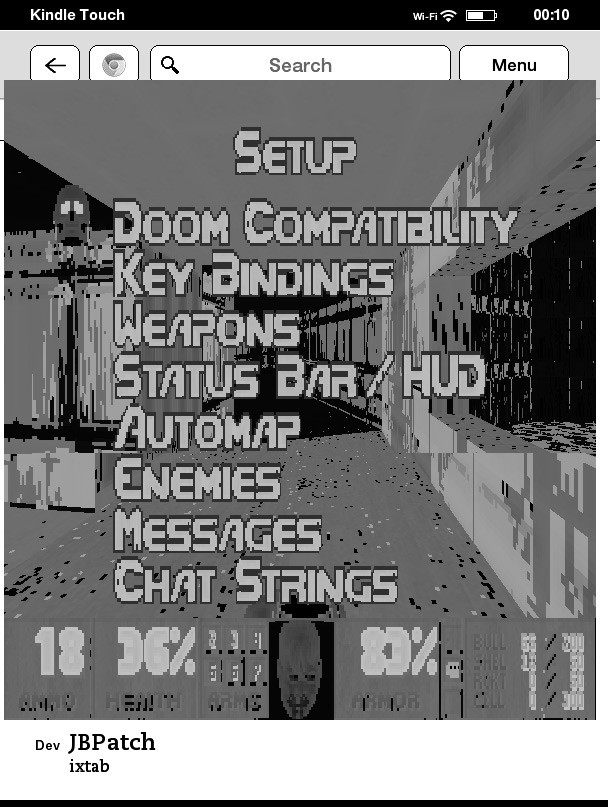

Doom Seen Running on a Kindle 5 (mine)
So yeah. After an enormous amount of fiddling about and after FINALLY giving in and switching to windows to edit up some screenshots.
So after a refresher course in Photoshop action batching:
Here is indeed some shots of prboom happening (with Sound!!!) on a kindle 5.
well okay there's no sound in these pictures. I'll do a viddy when I get the Certs fixed.
There are still some serious difficulties ahead but I think we can agree this is POC. next up? Fix my dang kindle certs add some sensible controls.
Package it neatly.
