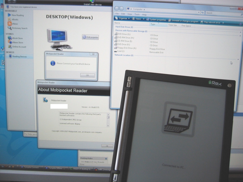

Device: irex iliad, uk Kindle gen3
we'll have to register our devices with mobipocket and buy them on their site then copy them across to the iliad.
p.s.
the mobipocket reader doesn't recognise my iliad (another poster claimed that theirs did), guess i'll have to input it manually to the mobi site.
p.s.
I believe iRex forgot to put the right files in the root of the USB drive again.
If you back upped like they said, you can put the files back there, I guess.
henkvdg is offline   Reply With Quote

i didn't backup anything as nothing important was on the internal flash, then again mobi reader didn't pick up my iliad before the new f/w ether.
deadite66 is offline   Reply With Quote

Device: Sony Reader Touch, Irex Iliad
@ deadite66
Since the 2.9 update mobipocket has seen and synched with my iliad. Just the Iliad can't open the files.

no mobi love :<
