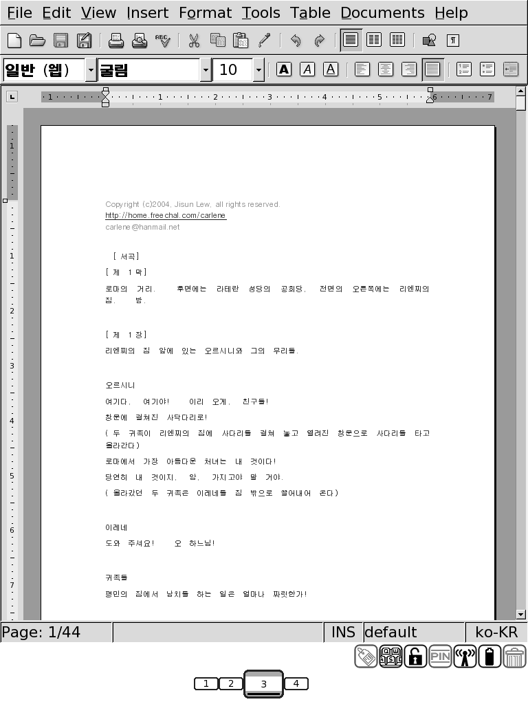

I've succeeded to install it about two weeks ago.
