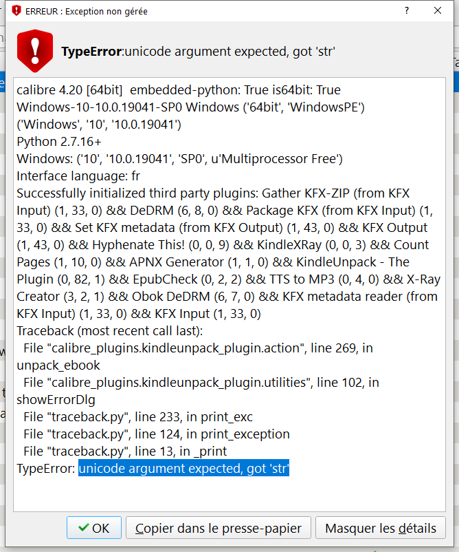

Old 07-06-2020, 08:18 AM   #427
PoP
 curly᷂͓̫̙᷊̥̮̾ͯͤͭͬͦͨ ʎʌɹnɔ
PoP's Avatar
Posts: 3,022
Karma: 50506927
Device: K3₃.₄.₃ PW3&4₅.₁₃.₃
unicode argument expected
Intrigued by this post about Kindle Editions with Audio-Video ebooks, I have downloaded one. Expectedly, It gets delivered to K3, PW3, and K4PC in the AZW/MOBI format with no audio or video media files.
I Alf-Harpered it and was just curious to inspect the source html, but then got this error message from KindleUnpack plugin:
Is this particular to that type of book or only a mundane error?
BTW the source seems to have been unpacked anyway and I can inspect it.
Old 07-06-2020, 12:07 PM   #428
DiapDealer
DiapDealer's Avatar
Posts: 29,198
Karma: 211539966
That there is an error displaying an error! That shouldn't really happen regardless of what kind of book it is (though I've never downloaded one of the books you're talking about). I'll have to take a look at the area in question. Thanks for the info.
Old 07-06-2020, 12:52 PM   #429
DiapDealer
DiapDealer's Avatar
Posts: 29,198
Karma: 211539966
Give this version a whirl and see if the error for that book is "properly" shown, now.
You still may get an error with that particular book, but it should be a different one. One that will hopefully give a better clue as to what the underlying unpacking engine doesn't like about it.
Old 07-06-2020, 01:51 PM   #430
PoP
PoP's Avatar
Posts: 3,022
Karma: 50506927
Exactly, a different error:
calibre, version 4.20.0
ERREUR : Exception non gérée: <b>AttributeError</b>:'unicode' object has no attribute 'write'
calibre 4.20 [64bit]  embedded-python: True is64bit: True
Windows-10-10.0.19041-SP0 Windows ('64bit', 'WindowsPE')
('Windows', '10', '10.0.19041')
Python 2.7.16+
Windows: ('10', '10.0.19041', 'SP0', u'Multiprocessor Free')
Interface language: fr
Successfully initialized third party plugins: Gather KFX-ZIP (from KFX Input) (1, 33, 0) && DeDRM (6, 8, 0) && Package KFX (from KFX Input) (1, 33, 0) && Count Pages (1, 10, 0) && KFX metadata reader (from KFX Input) (1, 33, 0) && KFX Input (1, 33, 0) && KindleUnpack - The Plugin (0, 82, 2) && TTS to MP3 (0, 4, 0) && KindleXRay (0, 0, 3) && X-Ray Creator (3, 2, 1) && Obok DeDRM (6, 7, 0) && Hyphenate This! (0, 0, 9) && Set KFX metadata (from KFX Output) (1, 43, 0) && KFX Output (1, 43, 0) && APNX Generator (1, 1, 0) && EpubCheck (0, 2, 2)
  File "calibre_plugins.kindleunpack_plugin.action", line 269, in unpack_ebook
  File "calibre_plugins.kindleunpack_plugin.utilities", line 113, in showErrorDlg
  File "traceback.py", line 233, in print_exc
  File "traceback.py", line 124, in print_exception
  File "traceback.py", line 13, in _print
AttributeError: 'unicode' object has no attribute 'write'
BTW it happens on that $0 book.
Old 07-06-2020, 06:18 PM   #431
DiapDealer
DiapDealer's Avatar
Posts: 29,198
Karma: 211539966
Ack! That's still not the error message I was hoping to get. I'm going to have to rethink my polyglot error dialog. It works for calibre-py3, but not calibre-py2. When I updated the plugin to accommodate both, I didn't check to see that error conditions worked for both versions of python. I'll get it figured out and post another test version.
Thanks for the free test case link!
Old 07-06-2020, 09:57 PM   #432
DiapDealer
DiapDealer's Avatar
Posts: 29,198
Karma: 211539966
The image resources in that book are pretty messed up. I fixed the error dialog error that I inadvertently introduced with my changes to support both the Python 2 and the upcoming Python 3 versions of calibre. And I patched the kindleunpack core engine to test for cover thumbnail image indexes that are somehow out of range. I'll see about making that change permanent in the kindleunpack repository.
The bottom line is that even though you may have gotten the html unpacked, you might not have been getting all of the images from that book unpacked (and you still might not, given all the unrecognized image resources and sections not containing recognized resources that I see in the debug output).
Give this version a whirl on that book (same version number as the last test version ... sorry).
EDIT: Removed beta attachment since it's been incorporated in the official release (first page of the thread).

Yeah, that's the same output I was seeing. That book's a bit of a mess. Clearly the process to strip out the multi-media resources and present this thing as a mobi is a bit less thorough than it could be.
Thanks for reminding me about the menu thing. I'll incorporate that before officially releasing v0.82.2 of the plugin, too.
Old 07-07-2020, 06:44 AM   #435
PoP
PoP's Avatar
Posts: 3,022
Karma: 50506927
This version unpacked the .mobi file without giving me a visible error.
Concurred Thanks, a greatly useful plugin.
