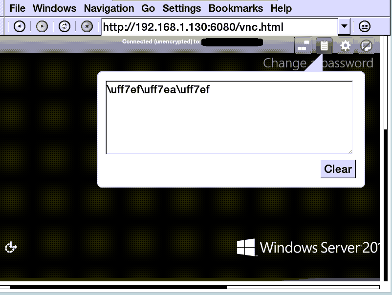

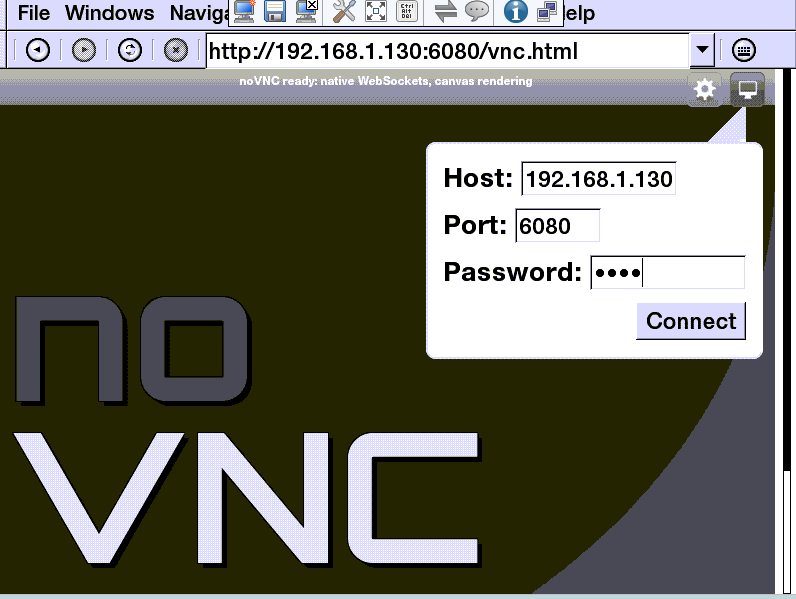

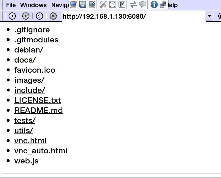

I've found NoVNC which help connect to VPN server through browser can work well on KT SkipStone though little bit slow.
C:\Python33\python.exe websockify --web "C:\Users\user\Downloads\kanaka-noVNC-v
0.4-94-g3cb89f5\kanaka-noVNC-3cb89f5" 0.0.0.0:6080 192.168.1.130:5900
WARNING: no 'resource' module, daemonizing decode may be slower
WebSocket server settings:
  - Listen on 0.0.0.0:6080
  - Flash security policy server
  - Web server. Web root: C:\Users\user\Downloads\kanaka-noVNC-v0.4-94-g3cb89f5\
  - No SSL/TLS support (no cert file)
  - proxying from 0.0.0.0:6080 to 192.168.1.130:5900
For window users(installed python 3.3 and numpy before running)
https://www.dropbox.com/s/d5ph8euaeg...naka-noVNC.zip
For others:
https://github.com/kanaka/noVNC

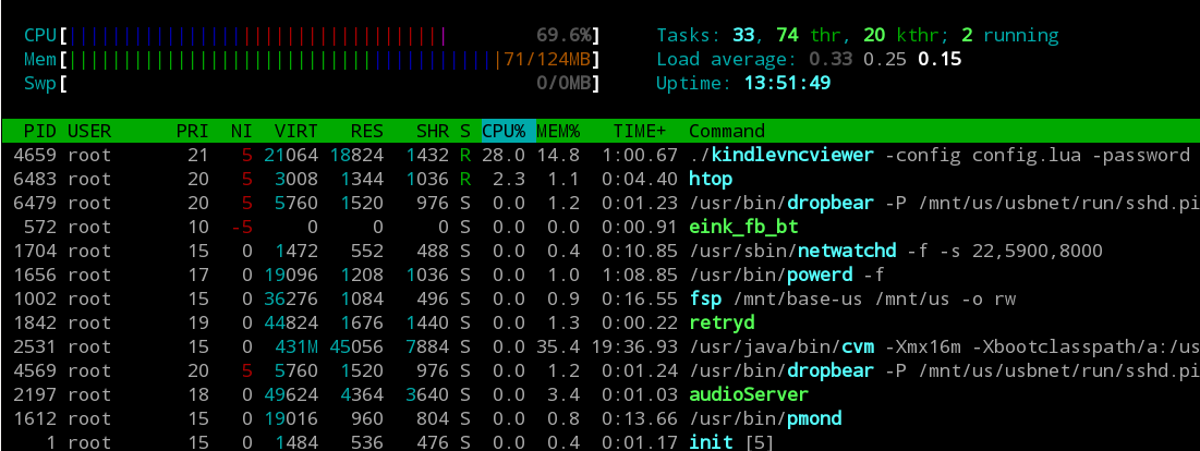

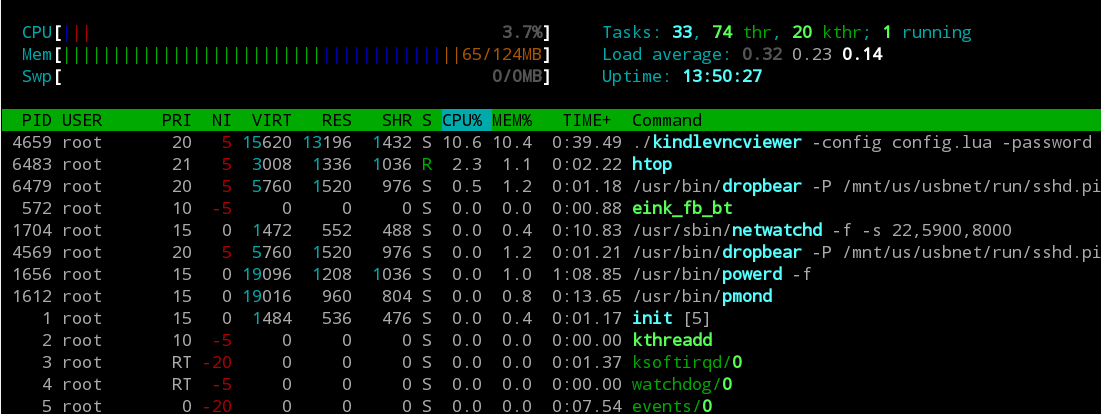

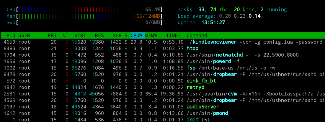

The following in response to twobob's PM -- some metrics:
I'm connected via usb, RNDIS/Ethernet Gadget.
I first ssh'ed into the kindle; then ran vnc.
I ran htop (I had actually assumed that there'd be no sort of 'top' on the machine!); some results:
CPU usage:
While scrolling a pdf at normal reading speed, CPU usage is around 40-50%. Scrolling faster, it climbs to 80%.
A moderate typing speed with nothing else moving on the screen uses about 60-70%.
kindlevncviewer accounts for the cpu usage almost exclusively.
MEM usage:
64 out of 124MB appears full; this hasn't changed at all in about an hour. Before that (when I first ran htop, after a session of maybe 8 hours) it was around 90MB, I think.
kindlevncviewer uses 4.3% of the memory.
The rest appears to be claimed almost exclusively by a certain cluster of processes starting with 'CVM', launched like this:
/usr/java/bin/cvm -Xmx16m -Xgc:youngGen=1m -Dsun.awt.exception.handler=com.amazon.ebook.framew ork.impl.device.event.EventDispatchThreadException Handler -Xbootclasspath/a:/usr/java/lib/localedata.jar:/usr/java/lib/charsets.jar -Dsun.boot.library.path=/usr/java/lib -cp :/opt/amazon/ebook/lib/JFEP-0.1.0.jar:/opt/amazon/ebook/lib/journal-update.jar:/opt/amazon/...........and a whole bunch of other java thingies.
Also -- 'fsp' runs with the following options:
fsp /mnt/base-us /mnt/us -o rw,nosuid,nodev,noatime,max_write=65536,max_readah ead=65536
Also -- launchpad is running, though it's not using any resources.
Perhaps relevant -- I'm on OS X 10.8.4; the screen is set to greyscale; the display is the 1680x1050 version; vnc shows the upper left hand corner (I arrange the windows accordingly.)
It's embarrassing that I have to ask this, but I'm not sure how to extract information from the xterm window, aside from this somewhat qualitative description.

hmm. None of those figures seem to be maxxing out the core resources...
Bottleneck elsewhere perhaps...
McGivering a similar test together now. (I hope)
EDIT: OKAY... I followed these instructions:
https://www.mobileread.com/forums/sho...&postcount=326
and I can confirm that there is about a 1 to 2 seconds delay at the very most....
perhaps less.
This is using Linux & DX.
even scrolling around like crazy (which to be honest has very little value in term of usefulness) I didn't manage more than 69% cpu consumption.
The average was around 15%
Mem sat at about a 20% footprint, which again is nominal.
To be honest it was pretty decent as experiences go.
Not sure I would be super happy using it as a screen full time, and true, my typing sucks...
But yeah. not too bad. Certainly not way behind.
The vnc only occasionally did the odd "dumb" update or two:
partially updating eink display (0,0)-(784,571)
partially updating eink display (0,0)-(479,1020)
partially updating eink display (0,0)-(822,1021)
partially updating eink display (823,100)-(0,1020)
partially updating eink display (448,100)-(635,950)
partially updating eink display (448,100)-(511,1020)
partially updating eink display (480,122)-(822,950)
partially updating eink display (823,100)-(0,950)
and mainly handled the partial updating pretty decently.
sorry I can't find the bottleneck. Frankly I don't see one.
I did get the very occasional
error while handling RFB message.
but meh.
apologies about that.
and yeah.... I also don't know how to scrape htop so we can be embarrassed together.

Thanks again for all the suggestions. I'm a bit puzzled now:
The vnc client clearly isn't taxing the DX's hardware; and the sluggishness is definitely due to the RFB server (but I don't know what to do about it; the -encodings parameters didn't make a difference; I can't find any settings on my vnc server; but anyhow).
Then while aimlessly surfing about, I came across the instructions for the 'Kindleberry Pi' (I have a Raspberry Pi as well; though I haven't tried anything with it yet.) -- wordpress link to the K-Pi. This is basically a recipe for using a Kindle screen as a console for the Raspberry Pi; so, following the instructions, I ran myts on the DX, and ssh'ed into my laptop; then I used tmux to take control of DX's ssh session from my laptop's keyboard.
The author of those instructions has a youtube video, where he's demonstrating, *on a K3*, the refresh rate of the screen while typing. Here's the video:
My tmux session, on the other hand, was just as sluggish as the vnc.
So this makes me wonder, again, whether it's the DX's hardware that is at fault.
