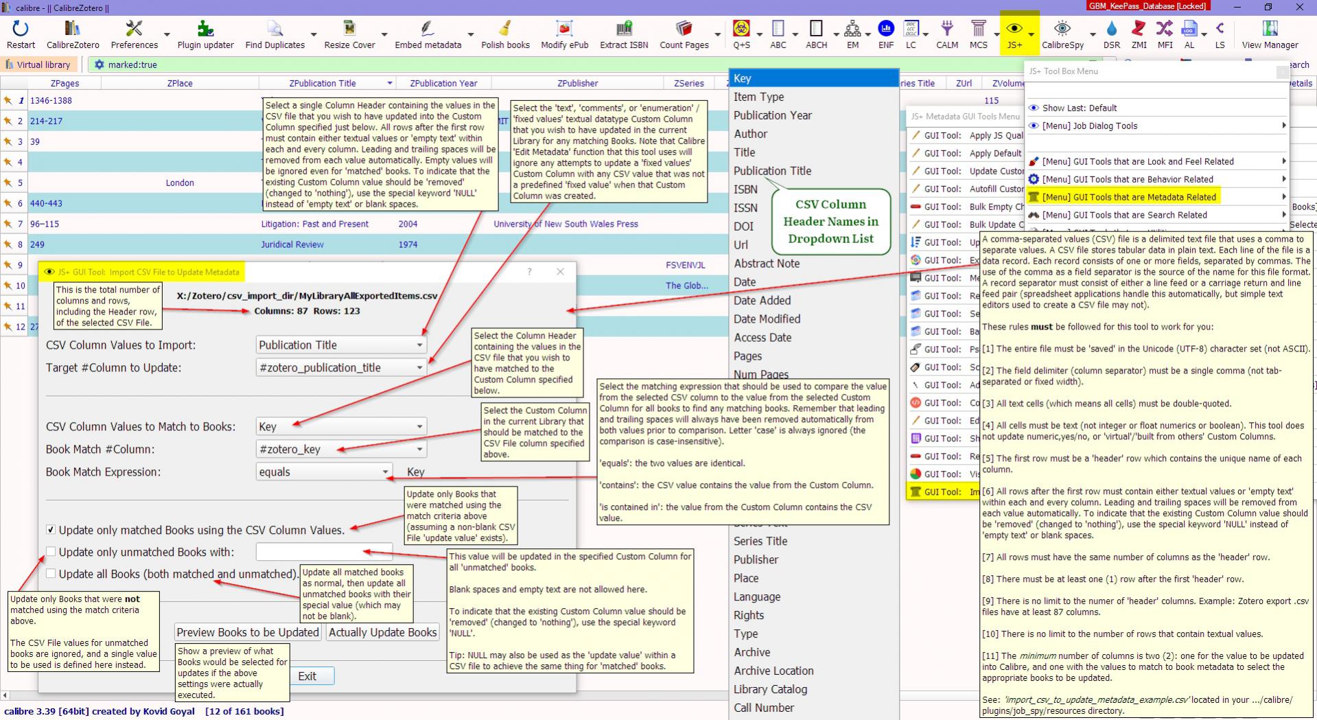

Version 1.0.144 New GUI Tool: Import CSV File to Update Metadata
Version 1.0.144 - 2019-03-07 New GUI Tool: Import CSV File to Update Metadata
See the attached overview image.
As always, new tools should be tested by you using your test Library before using them in your 'real' Library.
Added: as of Version 1.0.145, for tag-like CCs, the current tag metadata values used to match to the CSV match column values are in the format "red,green,blue,yellow" (not ever "red, green, blue, yellow" or
"red & green & blue & yellow"). So, regardless of how the tags are displayed in the Calibre GUI, and whether or not they are comma-separated tags or name-like tags using ampersands, they are compared as just described.
DaltonST

Thanks for the new tool. Could you make an option where the column isn't updated if one tag doesn't match what's in the csv file, even if some of the other tags for the same book doesn't?
There is often crossovers in the fanfiction.
Example:
original column: Lord of The Rings Tolkien & The Hobbit (Movie)
it only matches with The Hobbit (Movie) in the update metadata.
Then it would do nothing because not all of the tags for the same book is matched?
I hope this made sense.

Version 1.0.145 "Import CSV File to Update Metadata"
Version 1.0.145 - 2019-03-08 "Import CSV File to Update Metadata" match logic changes for tag-like Custom Columns.
Added: for tag-like CCs, the current tag metadata values used to match to the CSV match column values are in the format "red,green,blue,yellow" (not ever "red, green, blue, yellow" or
As always, test a new tool in a test Library before actually updating any "real" metadata.
DaltonST

That means if I want an exact match it would have to match all the information in the specific column and not just one?
Could it be changed so that it checks the 2 or more tags independently? and then only update column if all is matched?

Try 'is contained in' but the sort of the tags in the csv cell is important.
Old 03-08-2019, 02:55 PM   #418
Tanjamuse
Posts: 1,327
Karma: 5306
Join Date: Jan 2014
If I select the "is contained in" it still edits those where not all tags is matched.
I had hoped for a solution where it would check the tags individually, then if all the tags is matched with the csv mark it as updated, but if there is a book where only some of the tags is matched don't update it.

Join Date: Aug 2013
Location: Texas
The csv is matched to the CC, not the other way around.
You need to post an example csv row and what the corresponding book's CC looks like, and explain how the csv cell should be matched to the book's CC value.
