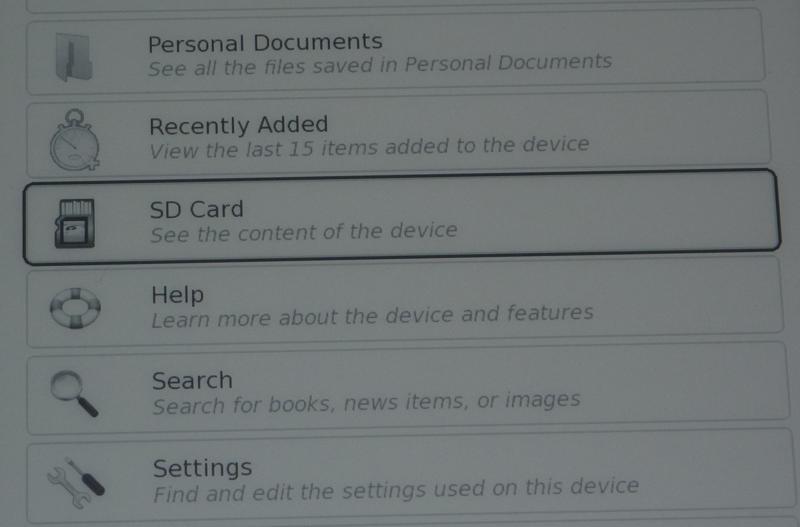

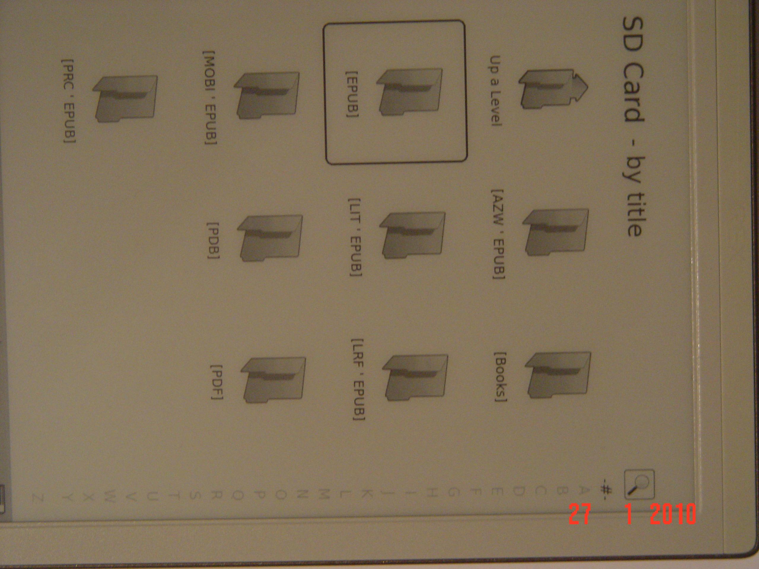

Here two photos after the "folder patch". In the first one you can see the new main menu entry "SD Card", after selecting you can browse the device content with folder structure (second photo).

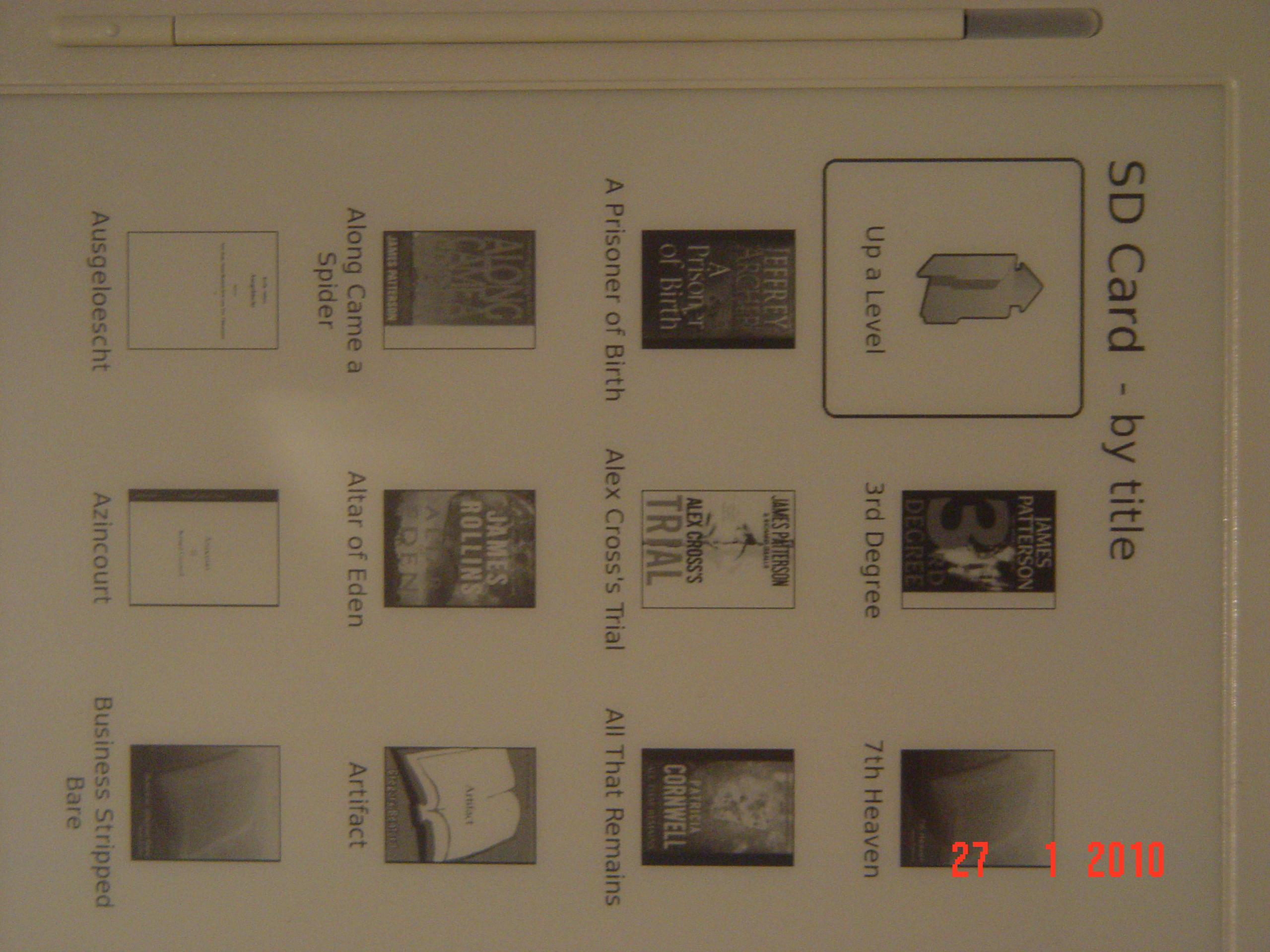

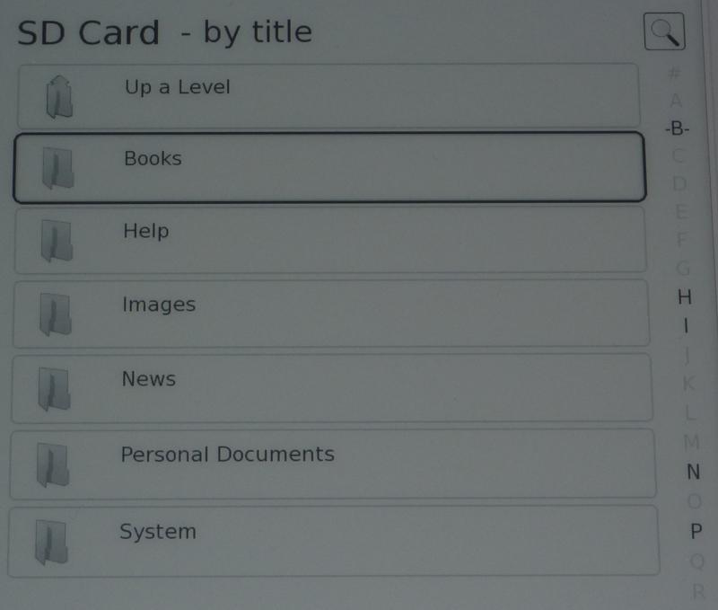

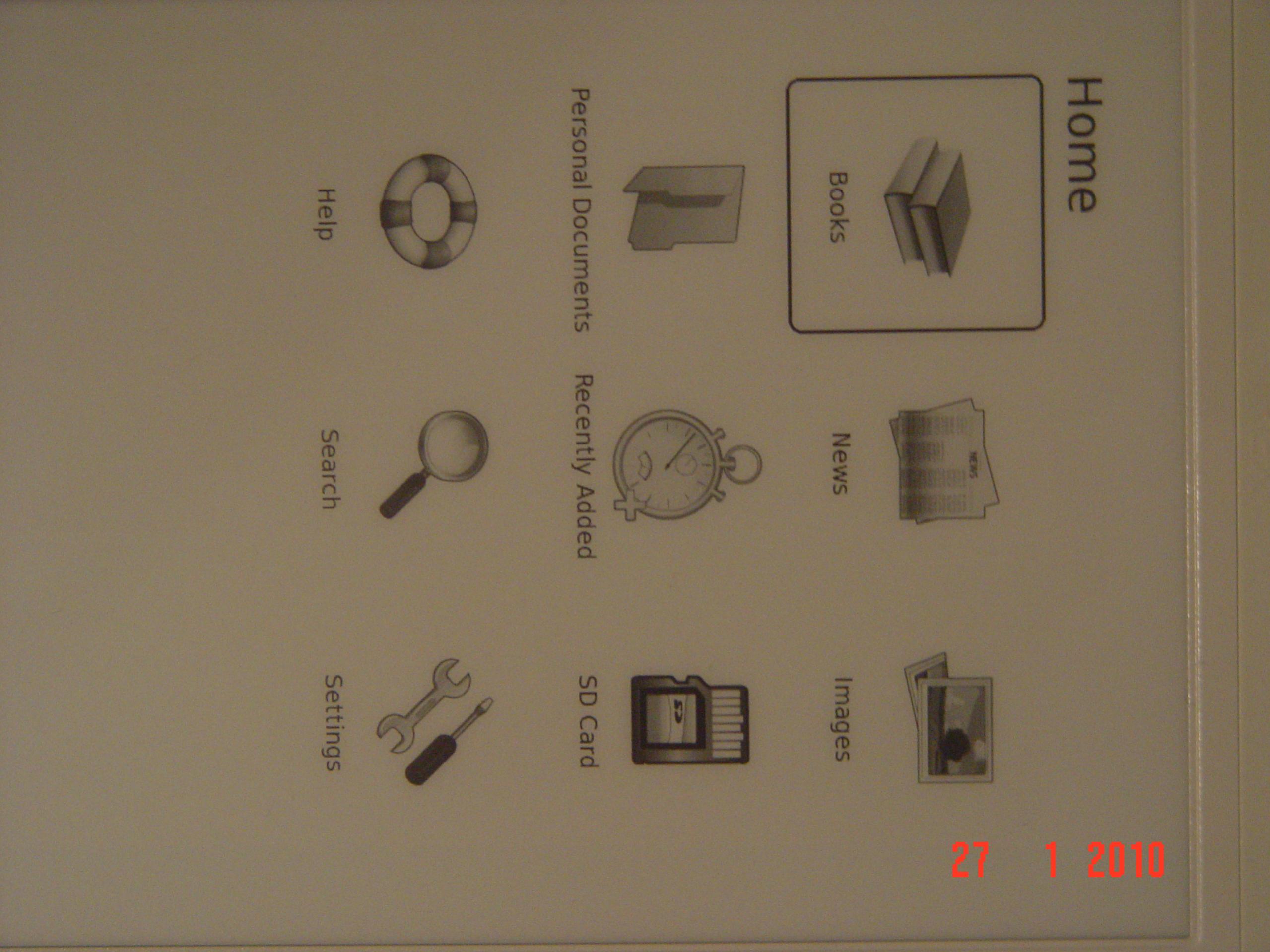

Folder support on iRex 800
As described above: iRex 800 DOES HAVE folder support.
Just a single entry in the .ini file.
Really great. Personally, I don't need it. But the majority seems to consider it essential.
The original "library view" (flat structure) remains intact, so you can have both in parallel.
Important to me: I may have the very same book in various formats = folders. In library view I can decide which one to choose. But it's very nice to have folder view additionally!
