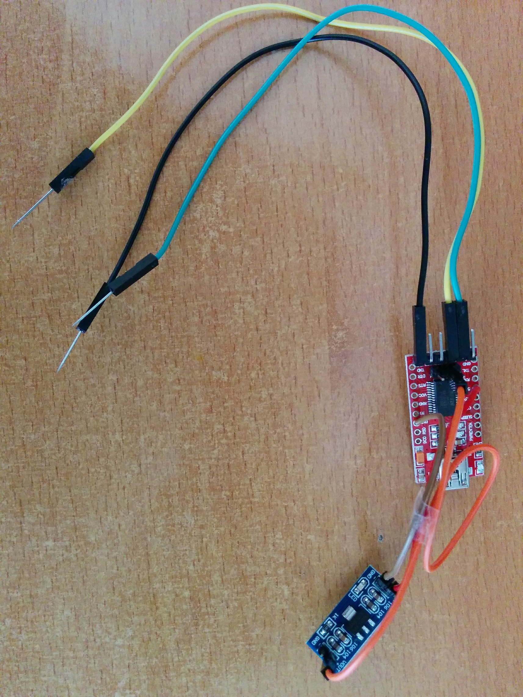

Hey guys! I successfully managed to jailbreak my kindle
Here's how it worked:
1)At first I had to download the correct Firmware for my device (In my case it was "factory_KT3_5.8.0_initial.bin" )
2)Then I renamed it to update.bin (necessary in a later step) and put it to the root directory of my kindle

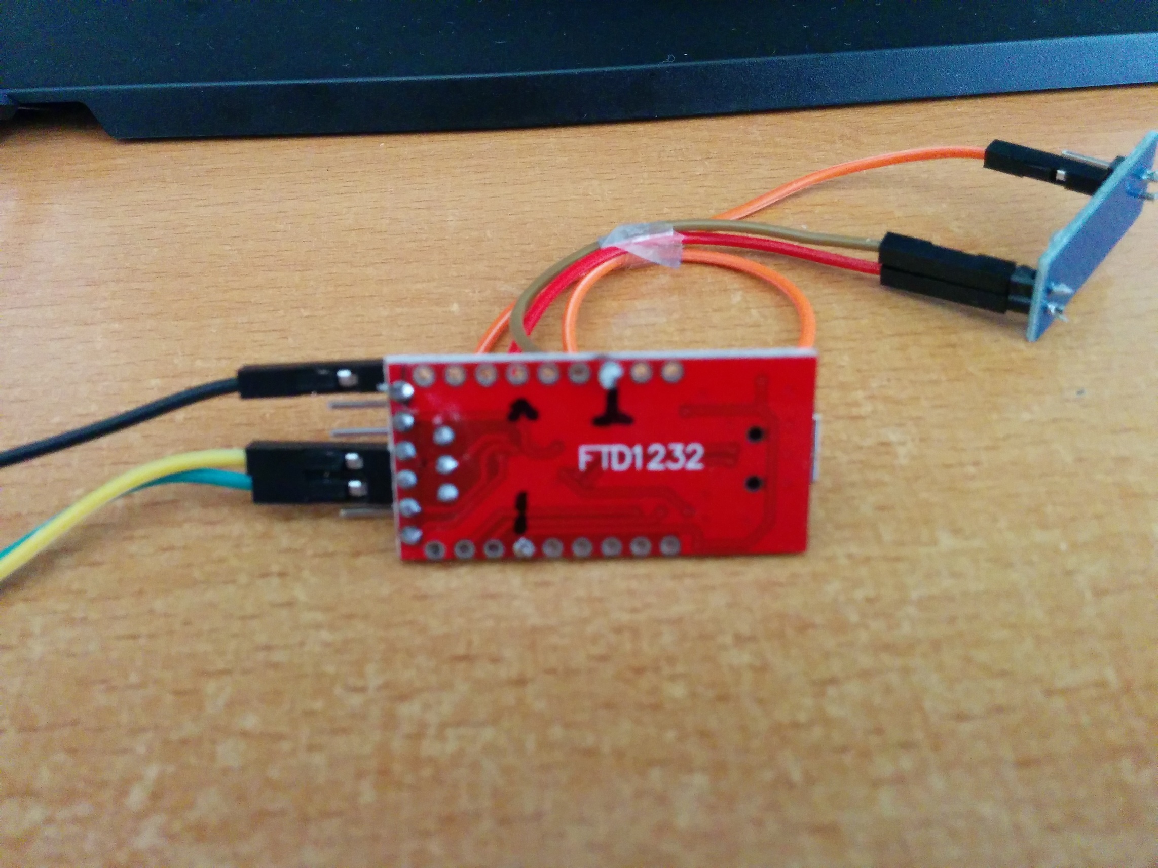

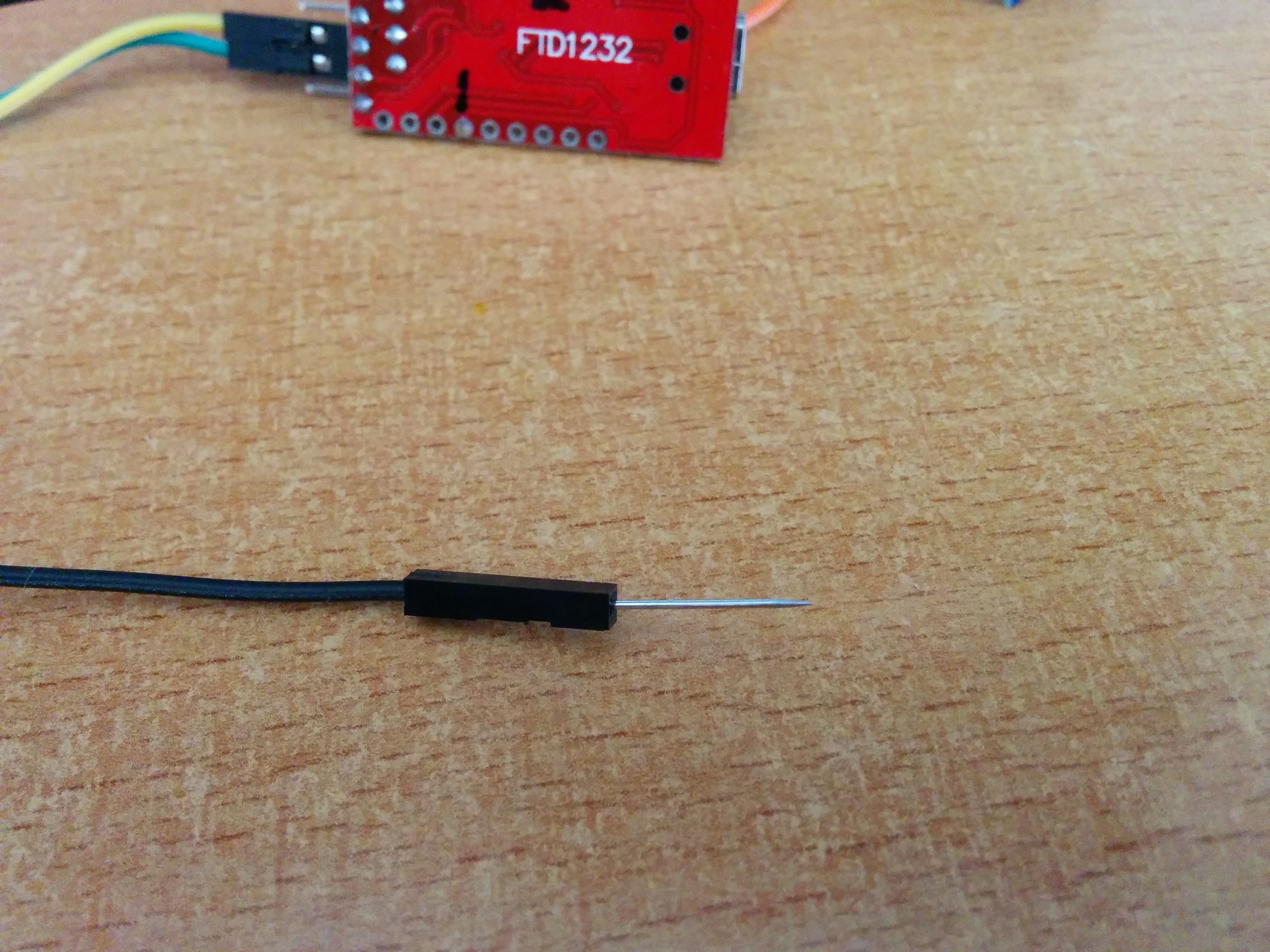

3) I connected the Serial-USB-Converter to my kindle
4) I startet the device and interrupted the booting sequence by pressing the "enter" button to get into uboot
5)Here I entered the command "run diags_boot" to get into diagnostics mode
6)After the diagnostics mode was fully loaded I pressed enter to get into kindle Login
7)I logged in with "root" and password "mario"
8)When I got logged in I entered "reboot"
9)Now in the boot sequence there was an entry to get into recovery mode. It was shown up just for about 1 second. When this entry was shown I had to press "enter" to get into this mode.
10) Now I got into recovery mode.
11) Here I had 10 seconds time to choose one of the operations.
12) I entered "u" for "Update using update*.bin file on FAT Partition"
13) When the update was finished I was on Firmware 5.8.0
So I just had to follow the Software jailbreak tutorial!
Here's the log from PuTTY:

Just wanted to share a serial connector that worked for me on a Kindle Paperwhite 3. The connector is similar to what others have used and consists in two cheap modules bought on ebay:
- FT232RL-FTDI-USB-3-3V-5-5V-to-TTL-Serial-Adapter-Module-for-Arduino-Mini-Port
- 12V In 1.8V Out AMS1117 Step-Down DC Power Converter Module
In addition, the following is very handy:
- STOCK IN US 1pc 40P 20cm 2.54mm Female to Female Dupont Wire Color Jumper Cable
- 3 Needles (like the ones coming with new shirts)
To assemble, cut one of the female to female jumper cable in half and solder one of them to the 5V pinout of the FTDI and the other to the GND. Connect the two jumpers to the 5V input of the Step-Down module. Connect a Female to Female Jumper cable from the 1.8V output of the step-down module to the middle jumper of the FTDI. This provides the 1.8 Voltage to the FTDI, instead of the 3.3V or 5.5V that can be selected using the original jumper. The FTDI can then be connected to the serial pins of the Kindle. I elected not to solder the wires and used instead 3 needles that I cut and inserted into the jumper cable (fits perfectly). I used foam as described in another thread to hold the needle in place. See pictures for more help. The whole thing worked perfectly to rescue a bricked PW3 for less then $10.
ID:	165815   Click image for larger version
ID:	165816   Click image for larger version
