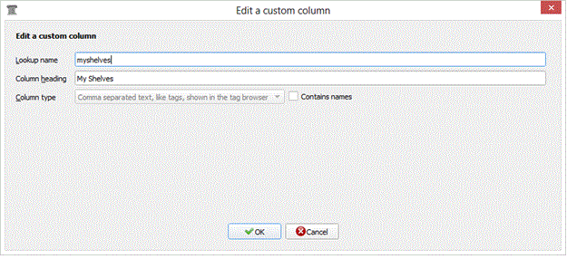

I have been trying to get Calibre to manage and send my book shelves to my kobo Aura HD. I can send books with no problems, however the shelve information does not transfer. I believe I have everything setup correct as shown below.
ID:	129129   Click image for larger version

wwaldo: Those settings look good. What do you have for "Metadata management" on the "Sending books to devices" page of the preferences? Is should be set to automatic.
