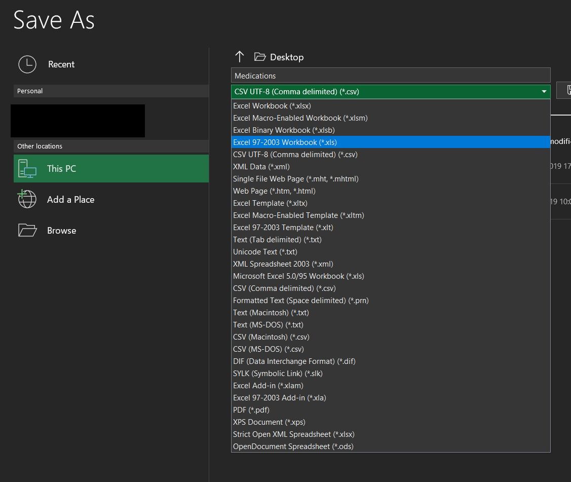

@ChrisMillward - how did you create the csv? If you used Excel, then which version?
Recent versions have a (not always easy to find) option to save a CSV in UTF-8, see ==>> Excel: UTF-8 Encode . This is the easy-to-find option in the current version:
Name:	Annotation 2020-01-18 072129.jpg
