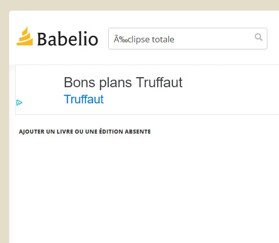

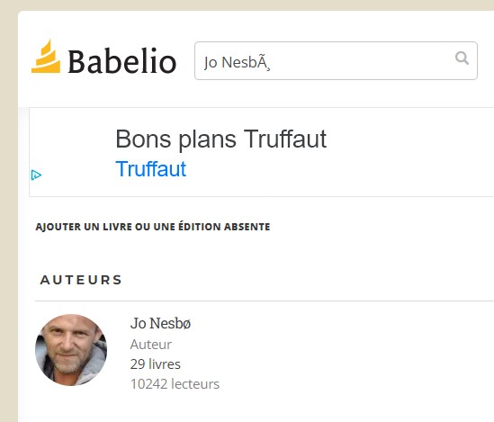

Hello Kiwi,
It's me again
I'd tested 10 books and authors but hadn't paid attention to the fact that there were no accents or special characters. (Here in France, we use these characters everywhere).
When using the plugin with books and authors containing accents or special characters, the plugin malfunctions.
example, with this author and title: Nesbø, Jo - Éclipse totale
In this example, the Babelio site found the author but not the title.
In some cases, the author is not found either.
Thanks again for your help. Have a nice day !

Encodings are something I have never spent the time properly learning, and certainly not in Python. I did attempt to test with the rpevious version but the special character I chose to test with was apparently not special enough.
This version does now work with those extra funky titles and author characters. The trick however is that you must also set the encoding to 'latin-1' on those Babelio rows.

Hello Kiwi,
you are very good and very responsive. I've redone my tests with different special characters in the title or author, it works perfectly (I already had the Latin-1 option activated).
Thanks once again (I hope it's the last time ;-)

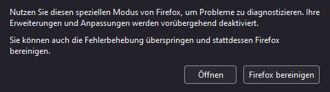

If FireFox isn't already open and doing a search via this plugin FireFox will only open in a kind of safemode.
This doesn't happen with the standard Calibre searches.

Could be something related to your default browser not being fully recognized by Windows... I have a portable Waterfox version as default, and the plugin searches open normally.
See the Kolbicz hacks here:
http://kolbi.cz/blog/2017/11/10/setd...16-build-1607/
https://kolbi.cz/blog/2019/01/27/reg...t-the-default/
