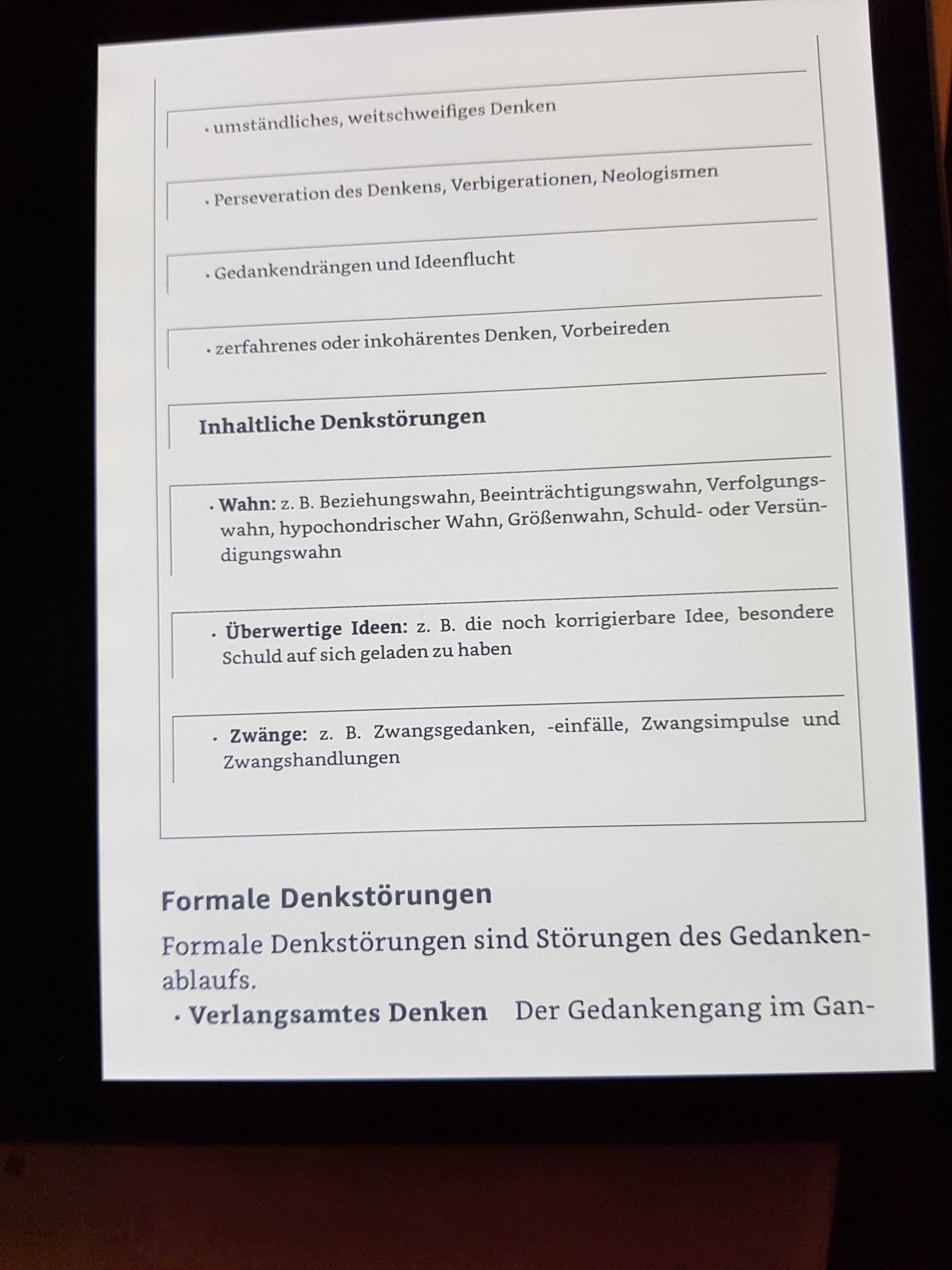

Hallo,
i was able to successfully convert an epub to kfx using the options above (Force TOC and linearize tables). The only thing did not convert correctly were tables (see attached images). The correct one is on Kobo Aura One using Kobo epub, the other one is KFX on Oasis 2. The AZW3 conversion is flawless regarding the tables. Increasing chapter limit did not make an effect on tables.
Are there any option to improve the conversion of tables for KFX?
thank you for your work
Support for HTML tables is limited in KFX format. I do not know of a work-around, other than using KF8 (azw3) instead.
