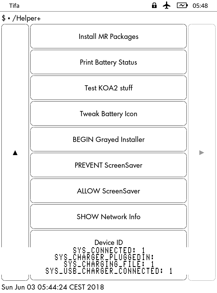

@NiLuJe - back in August 2016 (before your hiatus) there was an issue with the KOA. If it was ever rebooted while plugged into power or with the battery cover on it would restart in Diagnostic Mode. The workaround was in the last post of the thread. Is that fixed in the latest snapshots? If so, was the fix indeed in the CRP?

@picree: No, because IIRC, there's no reliable way to tell the difference without getting false positives at that point.
Note that it's been two years and I don't have a KOA, so this is based on what I remember and my own comments in CRP & KOReader.
Plus what we found on the KOA2.
EDIT: Speaking of, you can try this to confirm...
EDIT²: A look at the system logs to check on which trap it tripped with the cover plugged might be interesting, too.

In the thread linked above you sounded optimistic and asked if I could run a few commands:
@picree: It's basically a couple of commands to run and check whether they return 0 or 1 with different combinations of stuff plugged-in, so I can write something up if you feel up to it, it should be pretty trivial . .
I can still do that unless you have learned something from the KOA2 that says it won't work. The KOA2 Test gives the same results on my KOA as shown in the png you had in that post. I don't know how to capture a screenshot so I uploaded the same screenshot from your post for reference.

I can't guarantee an attempt at fixing that will:
* actually work in every case
* won't break something else
And I don't have the device to make sure of that myself, so, yeah, probably not going to happen.
It may also trigger with an USB Audio dongle plugged in, FWIW. That's another thing I don't have the hardware to check .
Plus, given the nature of this piece of code, I'd much rather it catches too much stuff than not enough.
