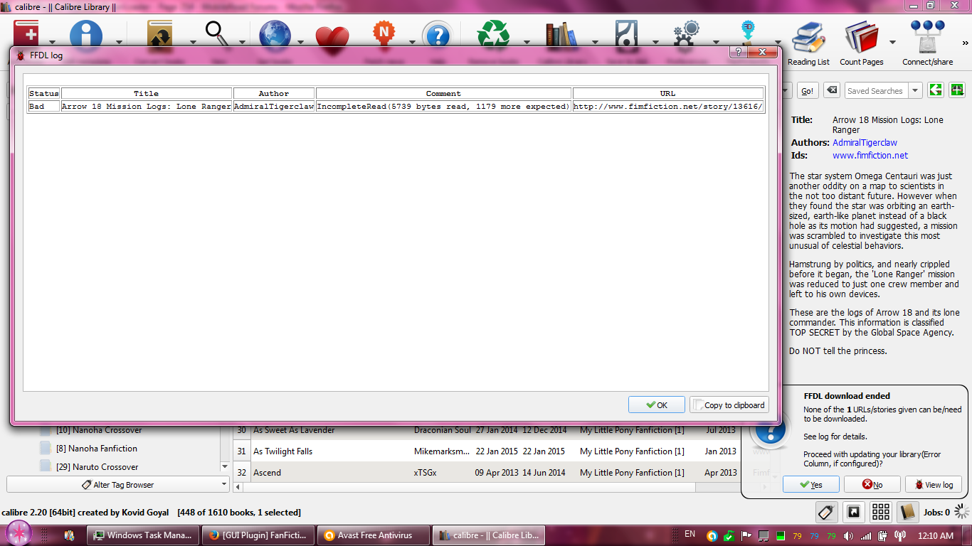

I've been trying to Add/Update some fics and I've been encountering this annoying error. Happening with Fimfiction and Fanfiction

This unfortunately looks like a problem with your internet connection or the server you are trying to download from. The screenshot looks like it came from a netbook or notebook possibly: make sure that your WLAN connectivity is at a healthy level. It's not something on the adapter level that can be easily fixed, I'm pretty sure. The only advice I have for now is to simply retry downloading the stories until it works.

Another possibility is that your wifi access point or local router or switch maybe failing. I had an ethernet switch slowly fail recently that gave all kinds of weird problems. But it's something in the networking, not FFDL.

Tried it with my phones hotspot and it works, so it seems the home network is the problem. Don't know if it's the router, as we got a new one recently, or if it's Comcast being Comcast, as I've had times where my internet has gone from 35 down to 5 down.
Edit: Nevermind, it seems I just got lucky. Doesn't work with the phone either.
Edit 2: Tried Uninstalling and Reinstalling Plugin. Doesn't work either.
Edit 3: Tried Get Story URLs from web page, got actual error message:
calibre, version 2.20.0
ERROR: Unhandled exception: <b>IncompleteRead</b>:IncompleteRead(3623 bytes read, 819 more expected)
calibre 2.20 [64bit] isfrozen: True is64bit: True
Windows-7-6.1.7601-SP1 Windows ('64bit', 'WindowsPE')
('Windows', '7', '6.1.7601')
Python 2.7.9
Windows: ('7', '6.1.7601', 'SP1', 'Multiprocessor Free')
Successfully initialized third party plugins: Favourites Menu && FanFictionDownLoader && Reading List && Search The Internet && EpubSplit
File "calibre_plugins.fanfictiondownloader_plugin.ffdl_ plugin", line 450, in get_urls_from_page_menu
File "calibre_plugins.fanfictiondownloader_plugin.ffdl_ plugin", line 466, in get_urls_from_page
File "calibre_plugins.fanfictiondownloader_plugin.fanfi cdownloader.geturls", line 63, in get_urls_from_page
File "calibre_plugins.fanfictiondownloader_plugin.fanfi cdownloader.adapters.base_adapter", line 338, in _fetchUrl
IncompleteRead: IncompleteRead(3623 bytes read, 819 more expected)

Chances are your WLAN hardware is failing then or the server isn't responding properly, as previously mentioned. It has absolutely nothing to do with the plugin, there's no need to reinstall it.

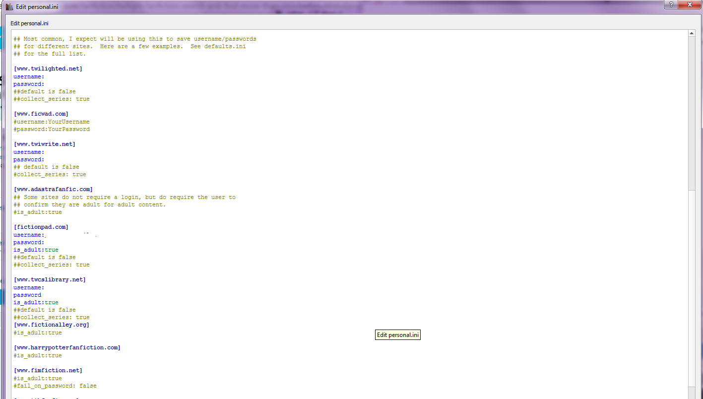

I am using the most recent version (2.14) of FFDL and it keeps losing my settings. It loses my custom column (status). The personal.ini keeps being reset to default so I lose what tags I want saved. It removes my settings for the reading list plugin.
It's an install of Calibre, ver 2.20 on Windows 7. The only unusual thing about how I use it is I have a virtual library set up for my fan fiction.
Any idea why this is happening?

Losing plugin settings sounds like a bug in the initial release of calibre 2.20. This was fixed and rereleased a day or so later. I would suggest download calibre 2.20 again and installing it. Hopefully that will fix it.
